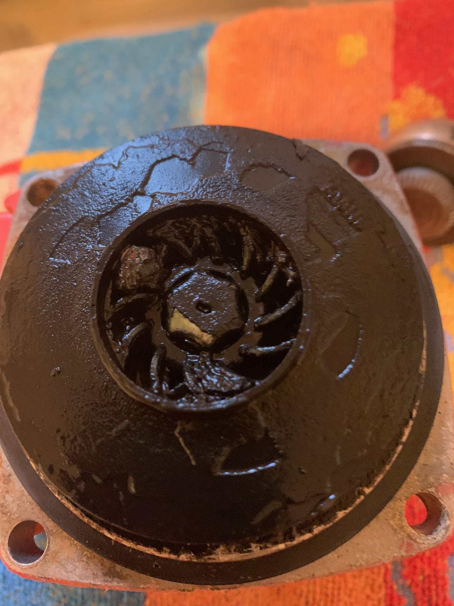

One of my pet hates is system noise - I won't repeat the post I wrote around pump getting blocked up with magnetite resulting on the need to run the pump as twice the previous speed and generating a lot more system noise as a result
But this was the pump impeller and once cleaned up I was able to revert to the previous min speed and had a perfectly quiet system again......Pump1.thumb.jpg.2c82b53df1fc9b7067f3c12eb545e521.jpg
