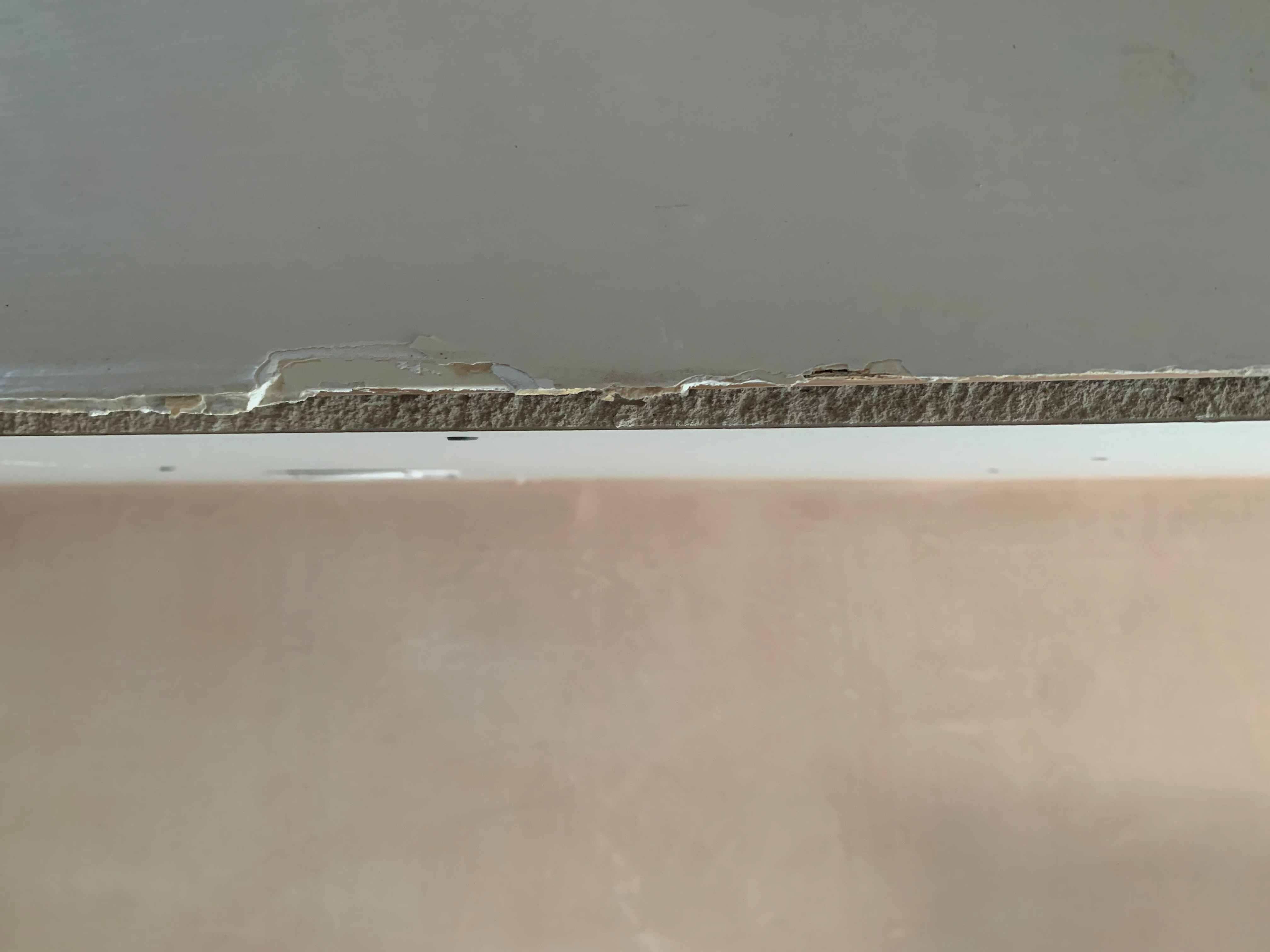

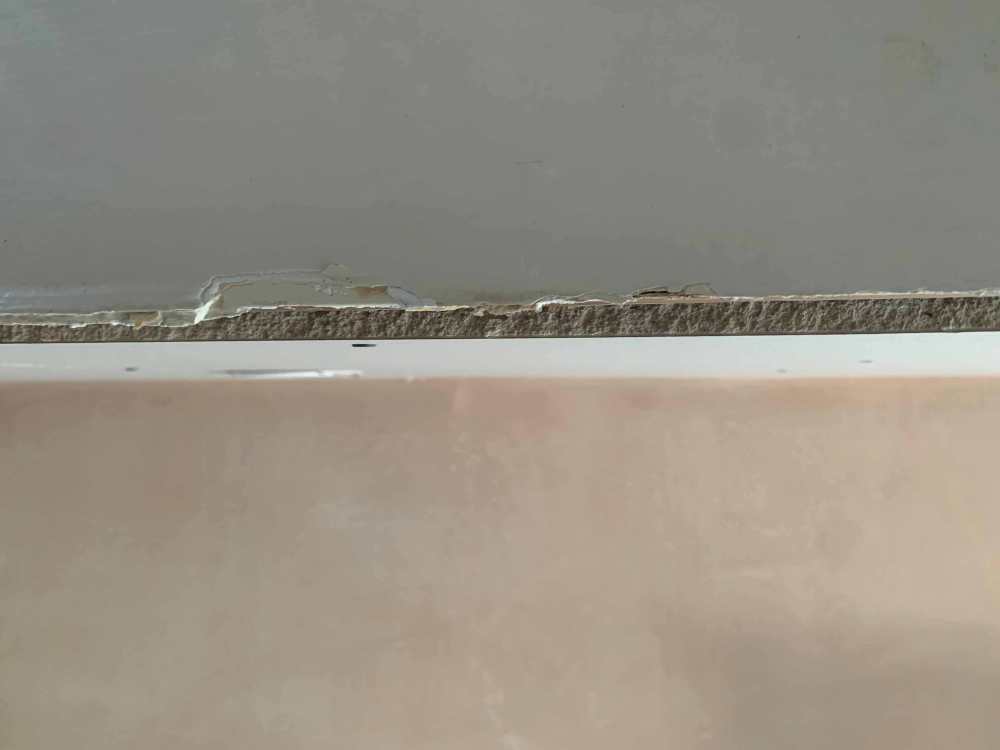

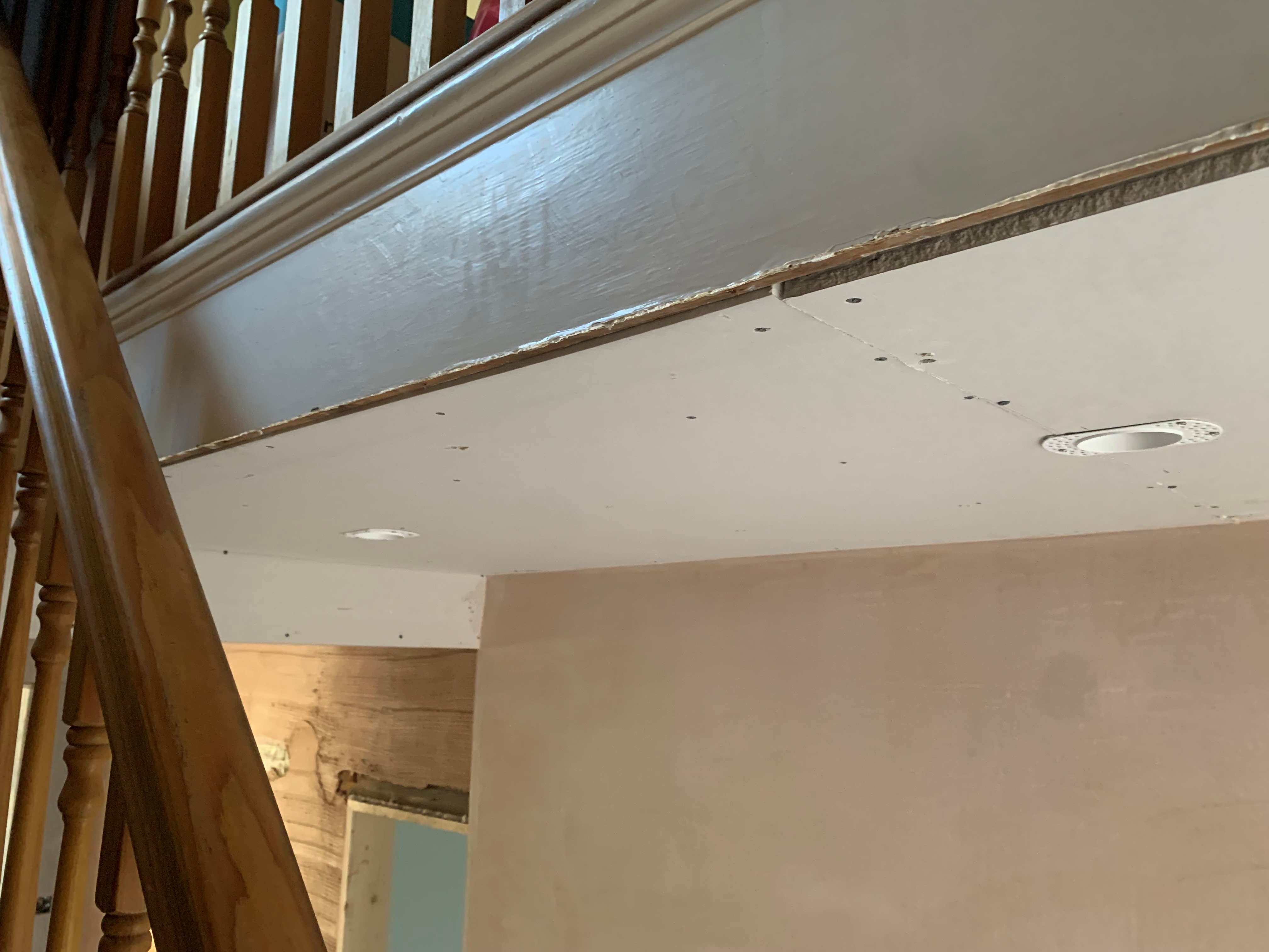

Spinny Posted July 10, 2025 Posted July 10, 2025 How can the edge of this ceiling in the hallway where it meets the stairwell be properly prepared for skimming and finished - see photos. We are thinking we want to look up and just see only a plastered ceiling all the way to the edge (i.e. not see a line of timber running down the edge from below). However when viewed from the side on the stairs there is a timber board, and equally we wouldn't want to see plaster on this side. There must be gazillions of houses (1930s) like this - so is there a good answer for how to achieve this and what kind of trim, timber, or profile to use for this and to provide an edge for the skim coat plastering ?
nod Posted July 11, 2025 Posted July 11, 2025 Strip the moulding off and plasterboard over the face of the timber and put a skim bead on the edge Easy option Skim the ceiling and fix a 50 mil 90 degree cover mould over the edge 1
