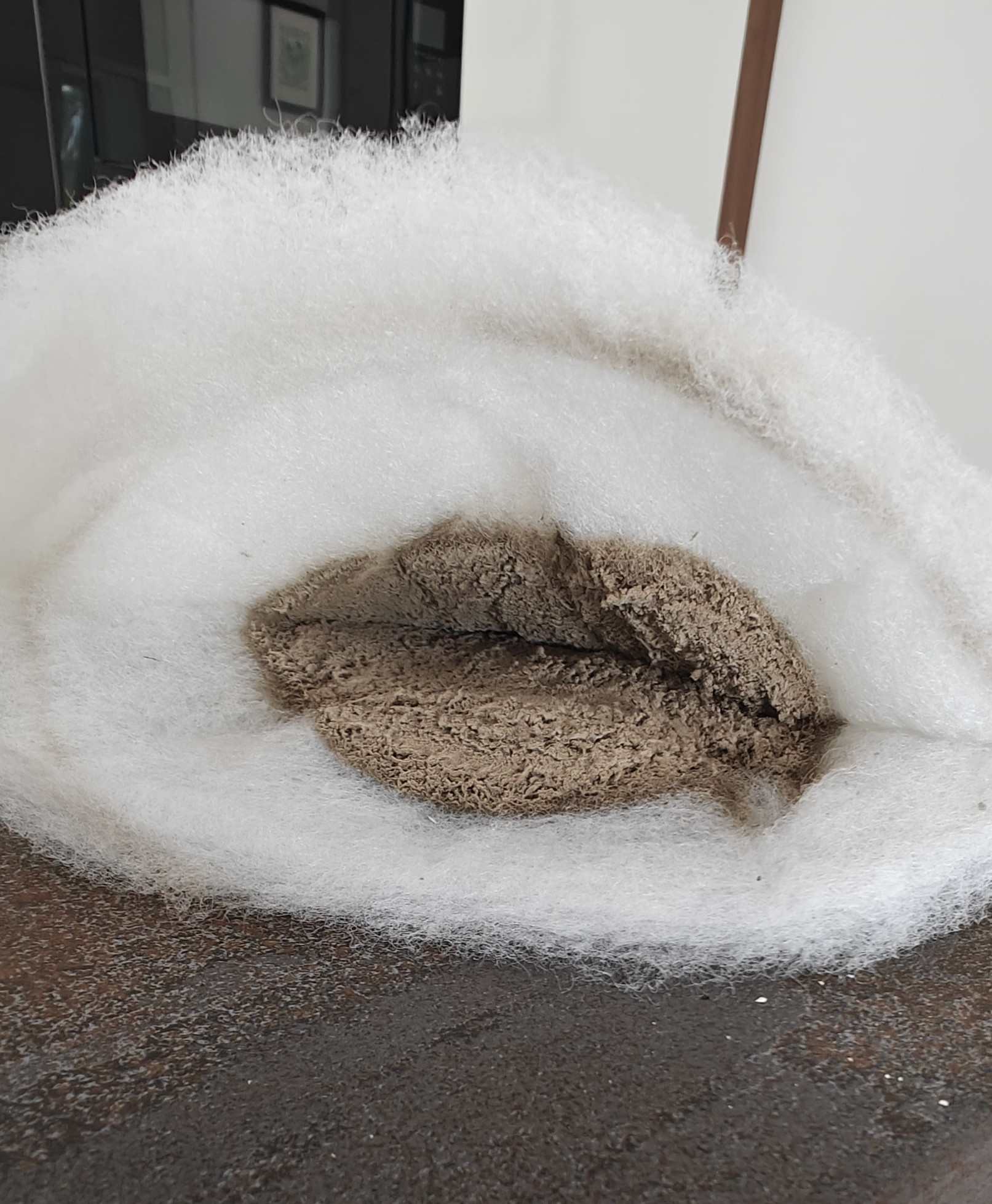

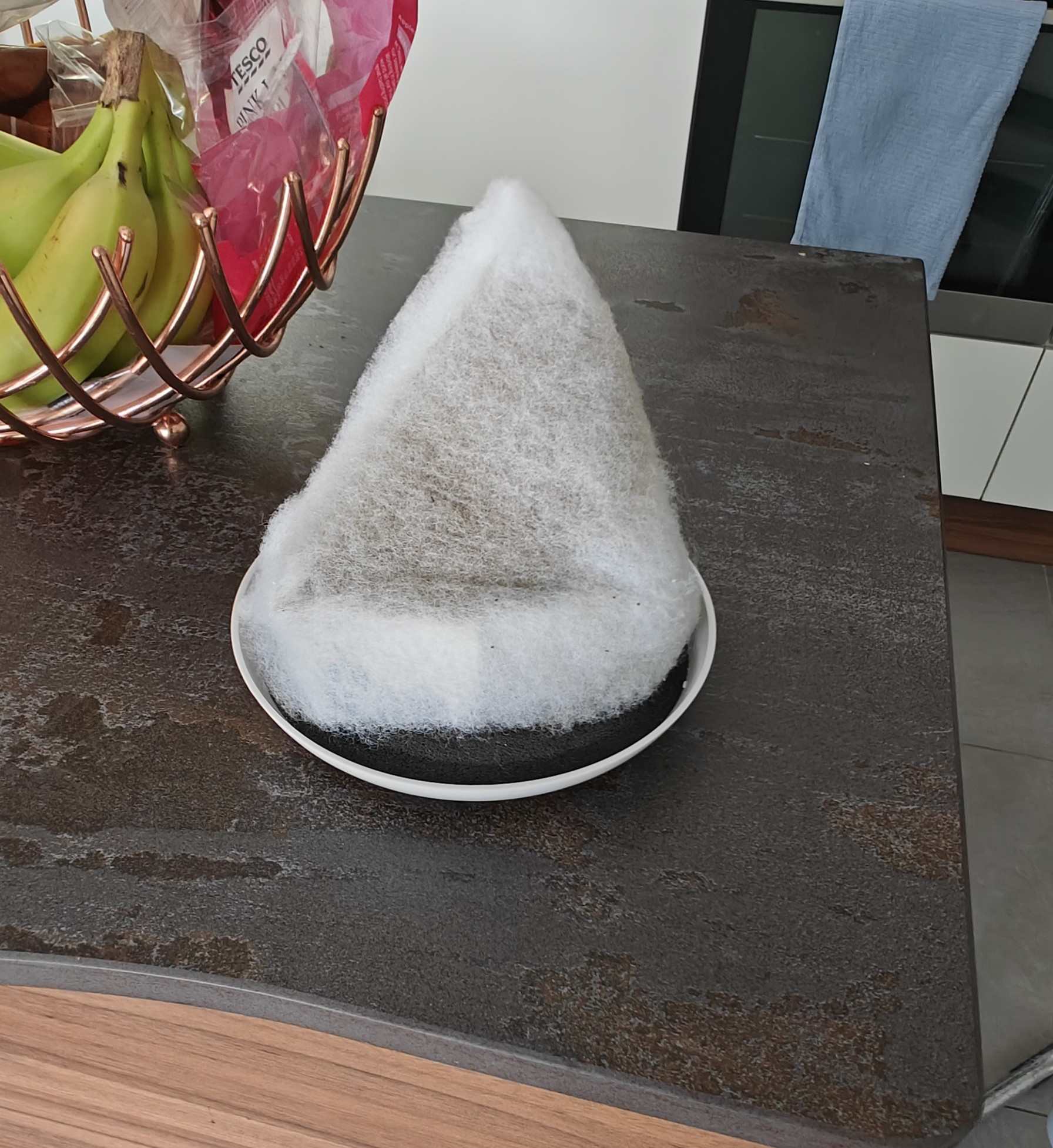

JohnMo Posted July 11, 2025 Posted July 11, 2025 13 minutes ago, Dave Jones said: We have MVHR but you dont want to fill the ductwork with kitchen stink, especially greasy type stink. We have recirculation hob extractor. But we placed the kitchen MVHR extract as far away from the hob as we could. We have a white foam filter sock on the terminal, it only ever has dust in it, never greasy. Ventilation extract position it as important anything else. This is the inside and outside of the sock after 6 to 8 months 1
Dave Jones Posted July 11, 2025 Posted July 11, 2025 ours is the same. im amazed just how filthy the main MVHR filters get. i swop them monthly.
