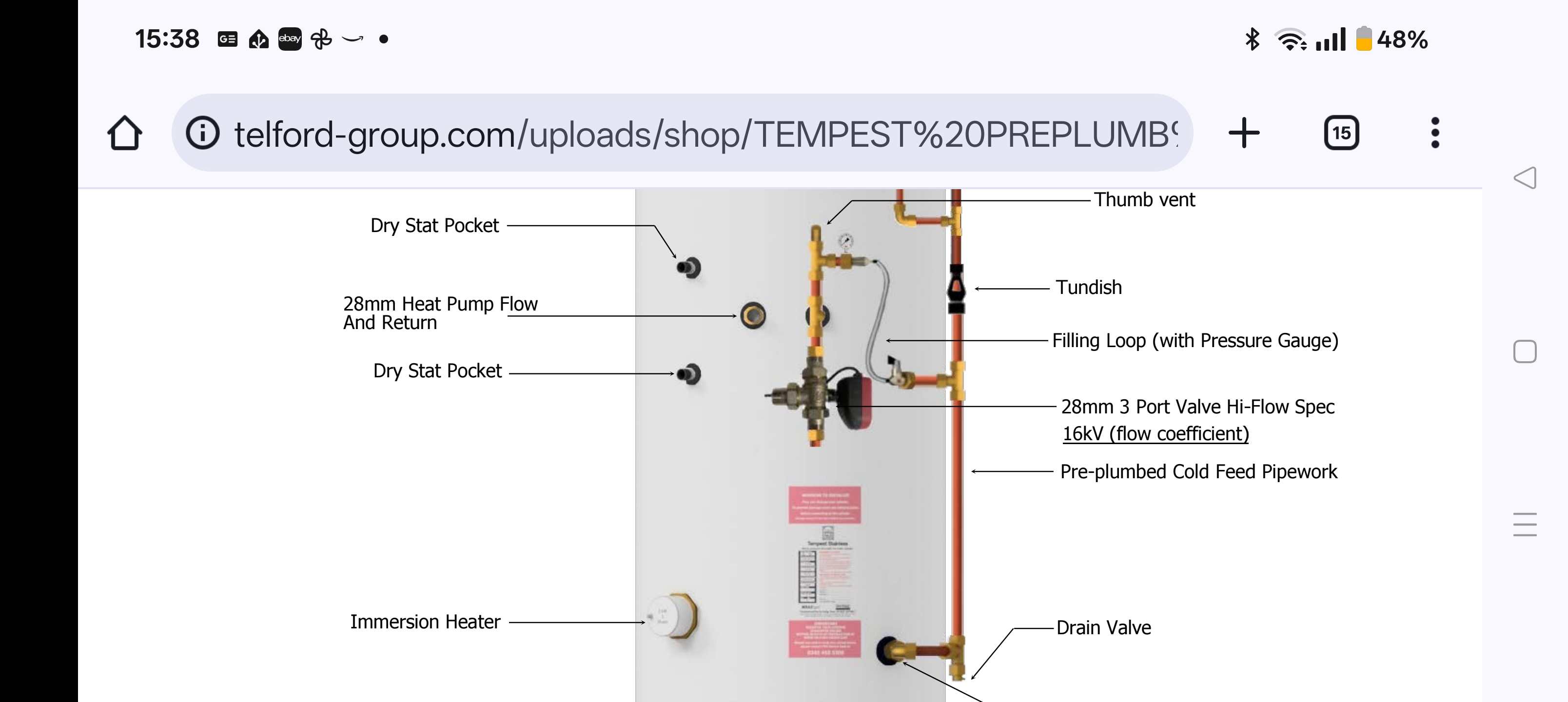

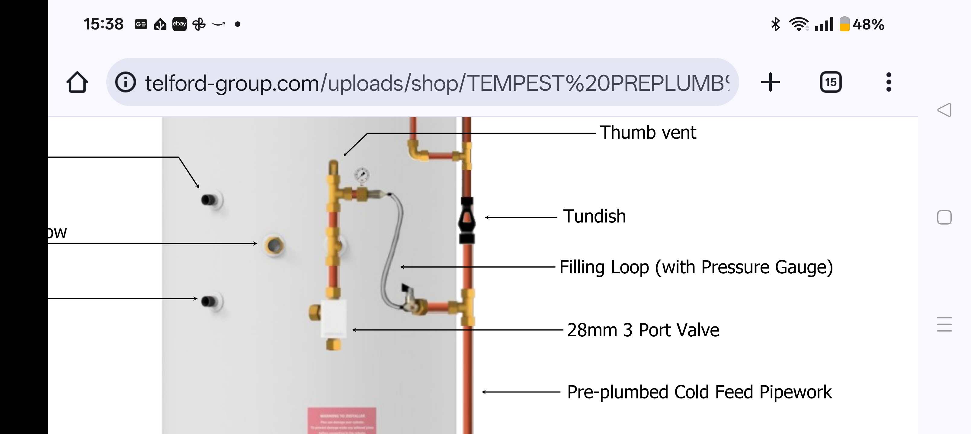

haythorn_1 Posted 13 hours ago Posted 13 hours ago Looking to order a UVC soon from Telford for my ASHP setup. Does anyone know when you would use the hi-flow variant versus the normal one? https://www.telford-group.com/product/tempest-heat-pump-pre-plumbed-simplified https://www.telford-group.com/product/tempest-heat-pump-pre-plumbed-simplified-hiflow
JohnMo Posted 12 hours ago Posted 12 hours ago Think the only difference (I see) is the 3 port valve and possibly a different pump if you needed one. Small heat pump, ordinary one ok, big heat pump high flow would be my take on it.
Nickfromwales Posted 10 hours ago Posted 10 hours ago 3 hours ago, haythorn_1 said: Looking to order a UVC soon from Telford for my ASHP setup. Does anyone know when you would use the hi-flow variant versus the normal one? https://www.telford-group.com/product/tempest-heat-pump-pre-plumbed-simplified https://www.telford-group.com/product/tempest-heat-pump-pre-plumbed-simplified-hiflow Speak to Trevor at Cylinders2go and mention my username and the forum. He’ll look after you with a price for the Telford kit. Lots of others here have bought from them.
haythorn_1 Posted 9 hours ago Author Posted 9 hours ago 2 hours ago, JohnMo said: Think the only difference (I see) is the 3 port valve and possibly a different pump if you needed one. Small heat pump, ordinary one ok, big heat pump high flow would be my take on it. What counts as small though? 1 hour ago, Nickfromwales said: Speak to Trevor at Cylinders2go and mention my username and the forum. He’ll look after you with a price for the Telford kit. Lots of others here have bought from them. Definitely will, thanks!
JohnMo Posted 8 hours ago Posted 8 hours ago 52 minutes ago, haythorn_1 said: What counts as small though? 6kW and lower I would say.
Nickfromwales Posted 8 hours ago Posted 8 hours ago They both seem to have the same coil surface area, so not sure what high flow actually refers to here. Ask Trevor for a proper explanation is my 2 cents.
JohnMo Posted 7 hours ago Posted 7 hours ago (edited) 38 minutes ago, Nickfromwales said: not sure what high flow actually refers to here. Different 3 port valve and pump Edited 7 hours ago by JohnMo
Nickfromwales Posted 6 hours ago Posted 6 hours ago 57 minutes ago, JohnMo said: Different 3 port valve and pump It's just a jump up to 28mm from 22mm then. Scan read it whilst multi-tasking, which never goes well. TBH all the Telford cylinders at 250L and upwards come with 1" BSP (so 28mm) connections/coil, so not sure any would impacted by being on 22mm if the cylinder volume is that much lower and it had less work to do?
JohnMo Posted 6 hours ago Posted 6 hours ago 3 minutes ago, Nickfromwales said: It's just a jump up to 28mm from 22mm then No, both are saying 28mm 3 port valve, possibly an esbe on the high flow and something like a Honeywell on the other. 1
