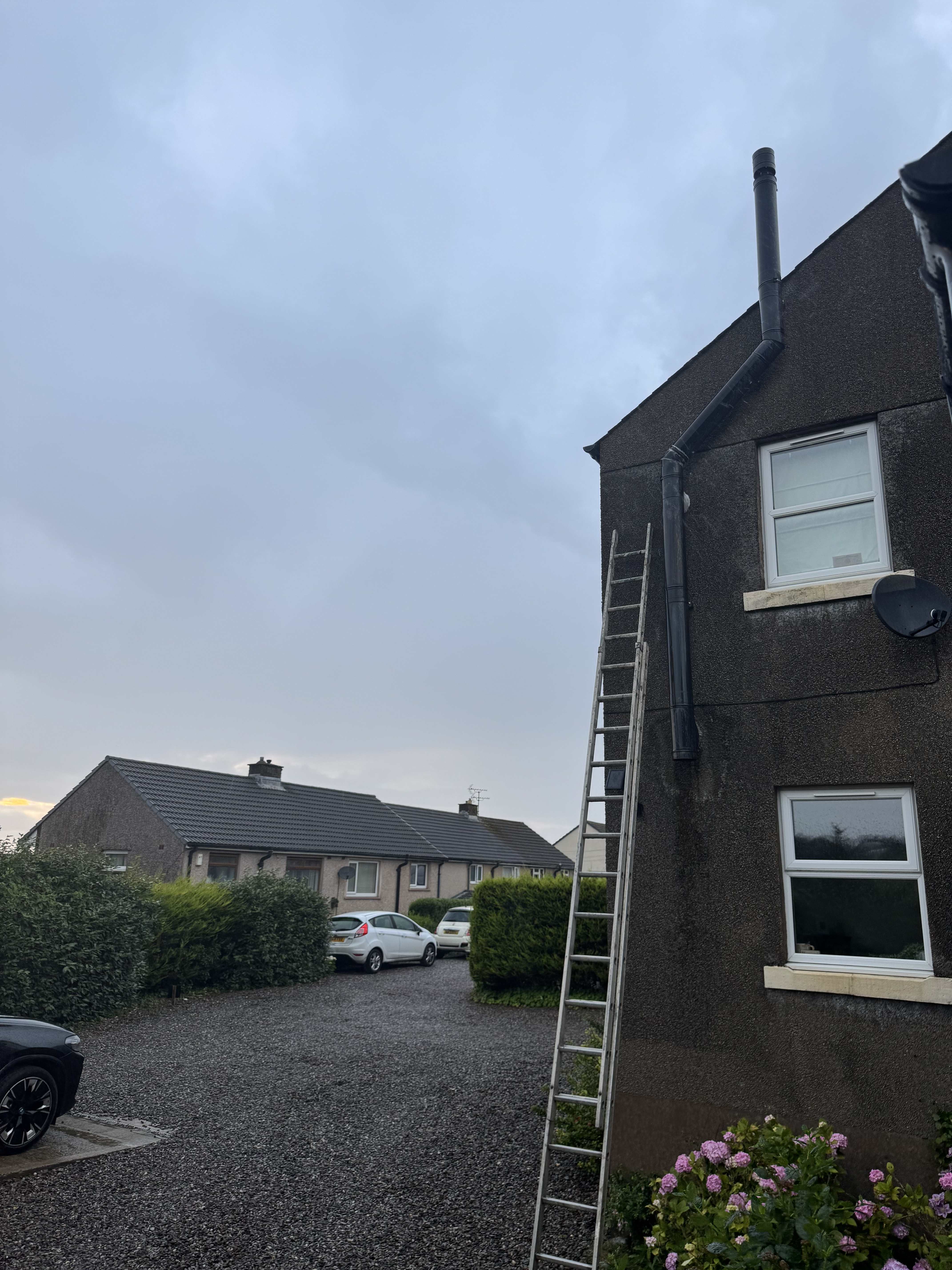

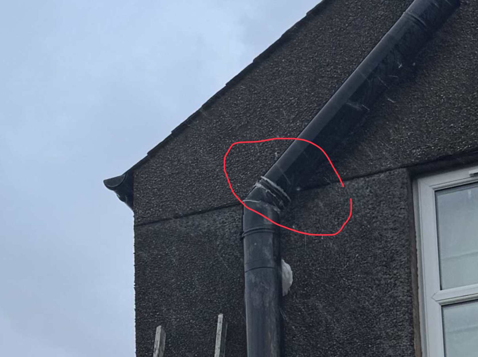

Dexlan Posted July 7, 2025 Posted July 7, 2025 Hi all recently purchased a property with a log burner with insulated flue. Water is somehow getting into the insulation, which is causing a drip in the house at the lowest point behind the log burner. I have been up on a ladder to inspect the flue but can’t see any damage to the flue that would allow water ingress. I have been testing joints with a hose pipe on low flow to see which it could be and I suspect it could be at a 45 degree elbow as the drip appeared inside again after testing that joint but again can’t see anything wrong with it install wise or condition. I also had the cowl changed on the top as it was delaminating and seemed in poor condition but it hasn’t changed the dripping. Any ideas please ? As the only other thing I can think of now is to install a new flue. Costly! See image thanks in advance
Bonner Posted July 7, 2025 Posted July 7, 2025 What is the white stuff around this joint? Shouldn’t need any sealant on these flue systems. You might need to remake some joints or replace an elbow, certainly don’t need a whole new flue!
JohnMo Posted July 7, 2025 Posted July 7, 2025 I would get your local stove company in to do a full inspection of fire and flue. Spraying water when you know the insulation is already wet isn't a good idea.
