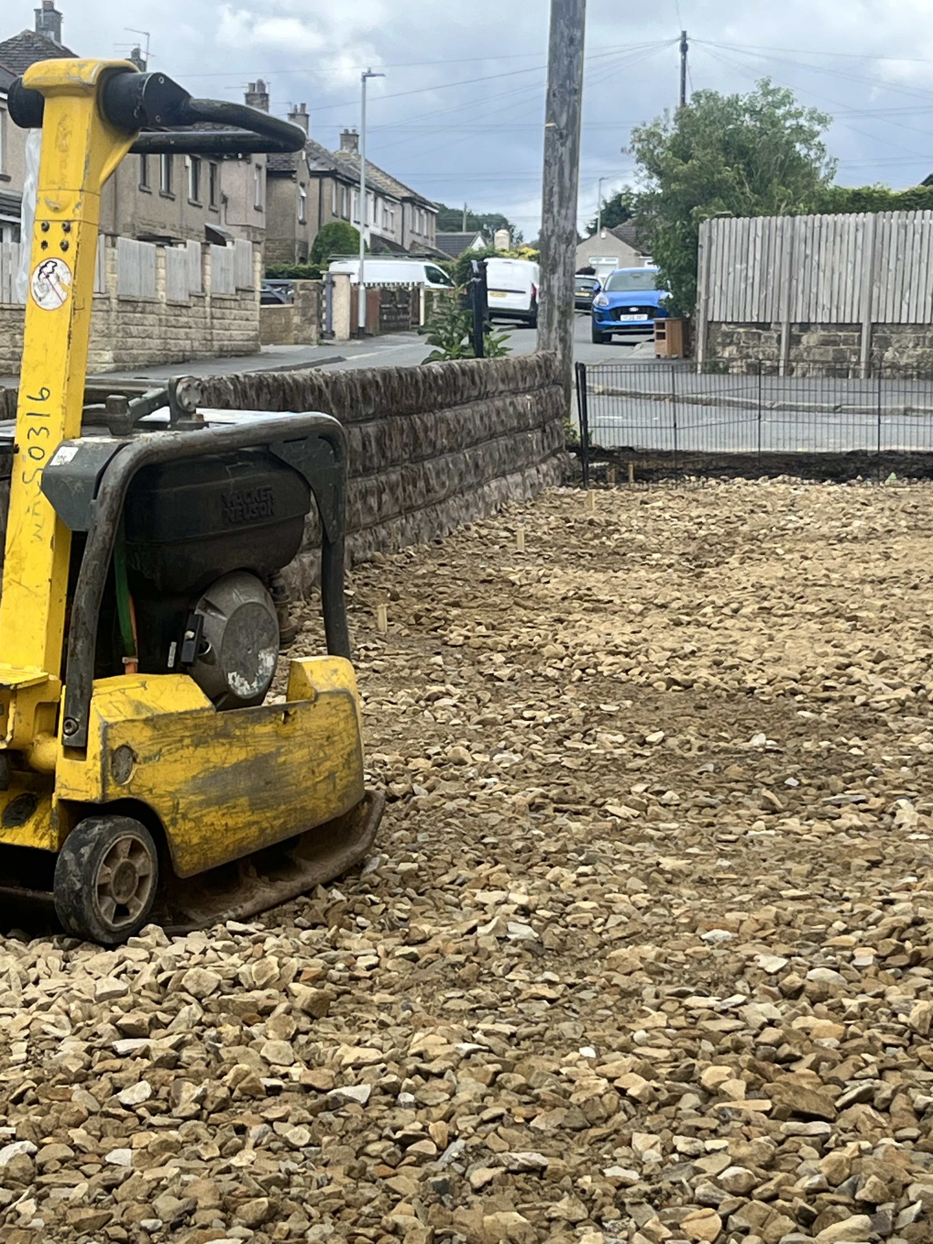

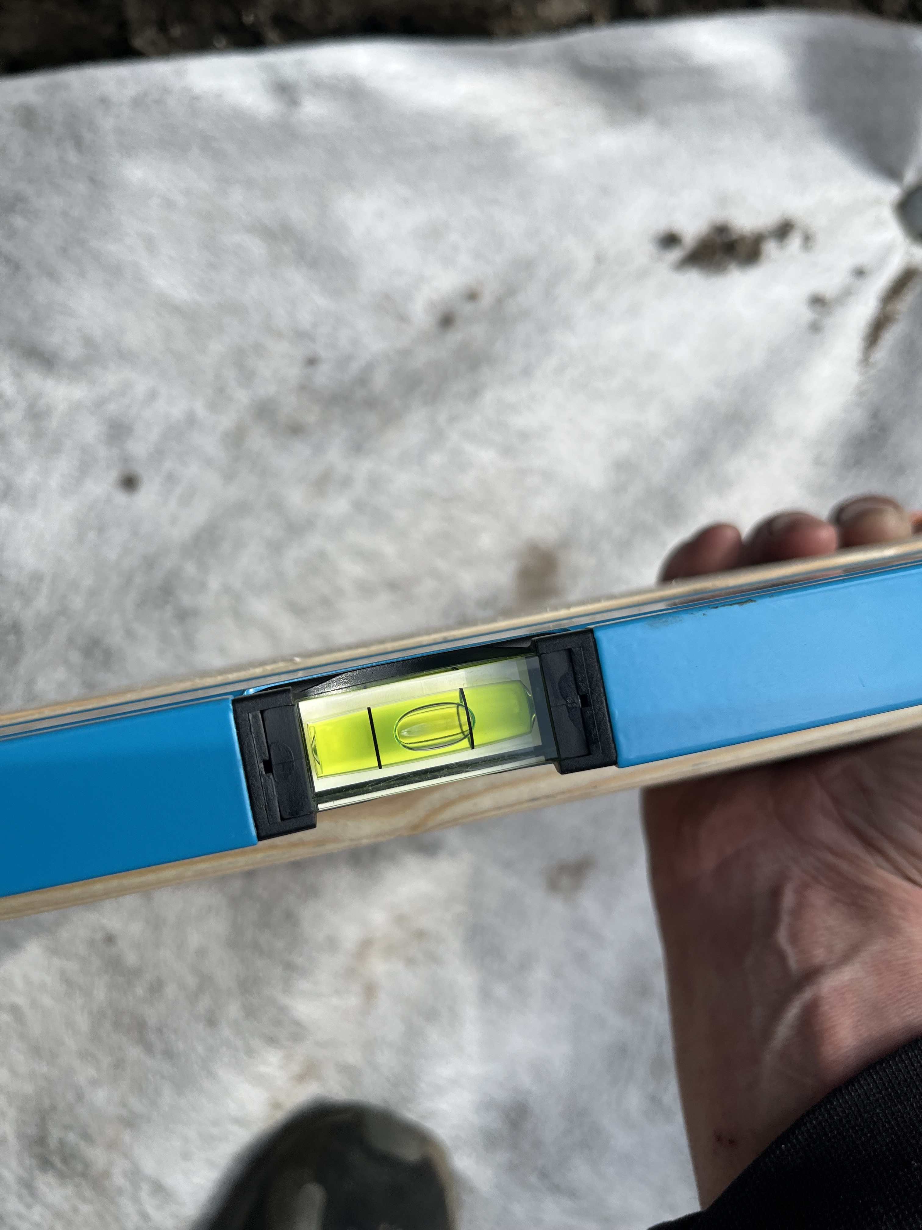

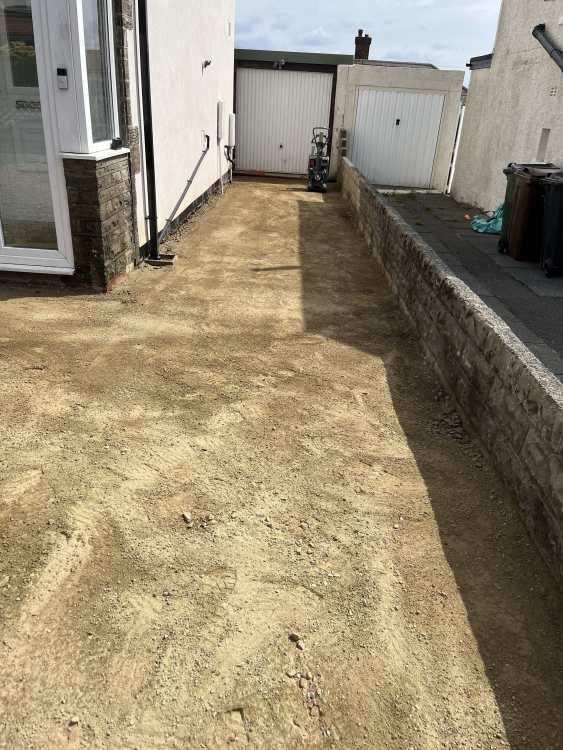

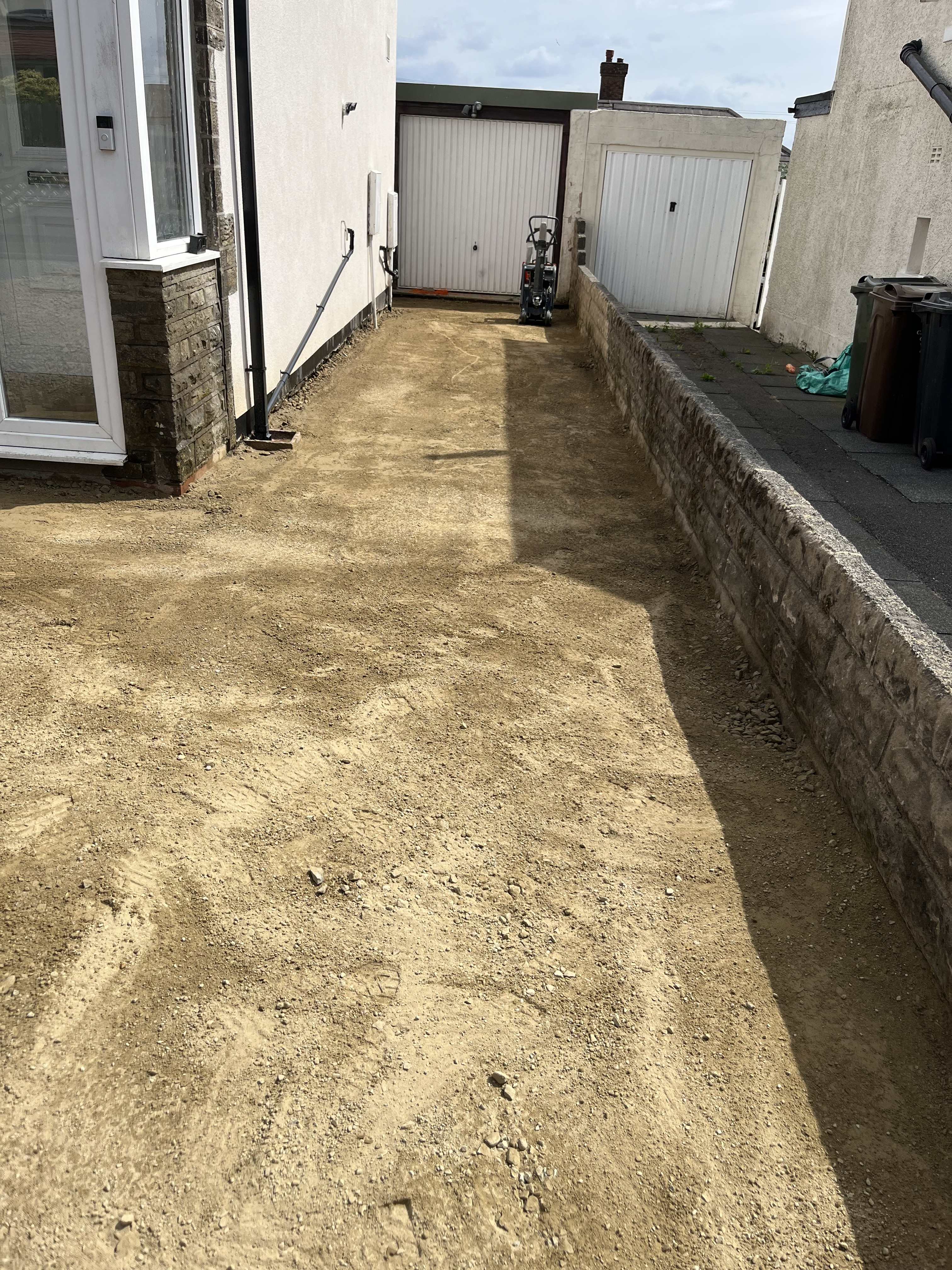

MattD1 Posted Saturday at 10:45 Posted Saturday at 10:45 Morning all. I’m just after a bit of reassurance really. I’ve dug out and put down a type 1 sub base for a new drive. 250mm dug out and a membrane put down before refilling and compacting the type 1 in layers. We have had some heavy rain the last couple of days even though it feels solid under foot, the top has gone a bit mushy. I’ve put a tarpaulin over it for now to stop us getting mud everywhere but wanted to check this wasn’t an issue. It’s probably going to be left for a couple of months before been finished that’s all. I’ve attached a couple of pics of the sub base before the rain came. Cheers
Nickfromwales Posted Saturday at 11:01 Posted Saturday at 11:01 What type of driveway are you installing, as you will need to speak to the contractor regarding prep etc. Water will sit on compacted type 1 so maybe throw some patio slabs down between the pavement and front door to keep your shoes clean until it’s time to complete the works. The ‘mud’ is just the fines of the type 1. 1

MattD1 Posted Saturday at 11:23 Author Posted Saturday at 11:23 18 minutes ago, Nickfromwales said: What type of driveway are you installing, as you will need to speak to the contractor regarding prep etc. Water will sit on compacted type 1 so maybe throw some patio slabs down between the pavement and front door to keep your shoes clean until it’s time to complete the works. The ‘mud’ is just the fines of the type 1. Cheers Nick. I thought that might be the case as everything seemed fine when it was dry 😂 I’ve installed an aco drain but obviously as the drive isn’t at the finished level yet the water is just sitting there. We are just having a tarmac drain with a border. I’ve levelled it all off to around 80-90mm depth and a slope down the drive to the aco which runs across the front of the garage 👍 1

saveasteading Posted Saturday at 12:27 Posted Saturday at 12:27 52 minutes ago, MattD1 said: I’ll definitely make sure What thickness is agreed. I ask because I once had a drive dressed. He quoted an inch but it was half of that....his excuse being it was an inch before rolling. He had to go to buy some more, and formally cursed me after I paid ( in full). And what specification? Is your sub- base laid to the necessary fall, so that thd tarmac is all the same thickness? 1
MattD1 Posted Saturday at 12:47 Author Posted Saturday at 12:47 11 minutes ago, saveasteading said: What thickness is agreed. I ask because I once had a drive dressed. He quoted an inch but it was half of that....his excuse being it was an inch before rolling. He had to go to buy some more, and formally cursed me after I paid ( in full). And what specification? Is your sub- base laid to the necessary fall, so that thd tarmac is all the same thickness? Hiya bud. I was told 80mm which accounts for a binder and top course. I’ve got 90mm in most places but at least 80mm everywhere. Constant fall to the aco at the garage 👍 1
