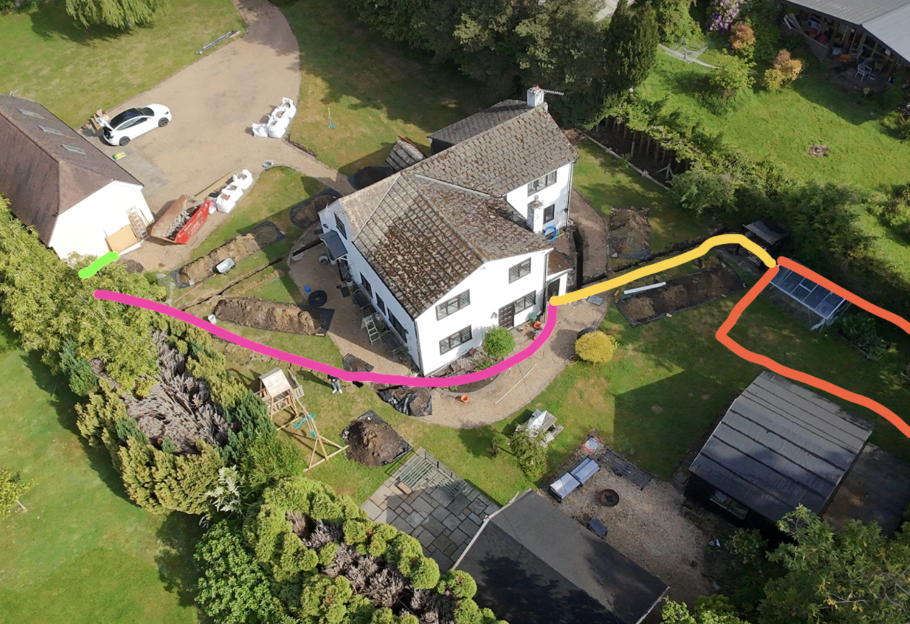

d438a1 Posted Thursday at 20:32 Posted Thursday at 20:32 I'm just finalising my new ASHP system to replace existing LPG boiler. I'm also about to get solar installed, with 12kw generation and 16kw battery. It's a larger 18kw 3 phase ASHP as it will be powering heat and hot water to main house, garage annexe and a separate workshop. He's specified 300ltr HW cylinder and 500 litre powertank and pump as our mains pressure is terrible My ASHP installer doesn't seem hugely on board of specifying a twin coil HW cylinder and seems to think a heat pump cylinder would be fine with normal immersion. What is consensus here? Thanks

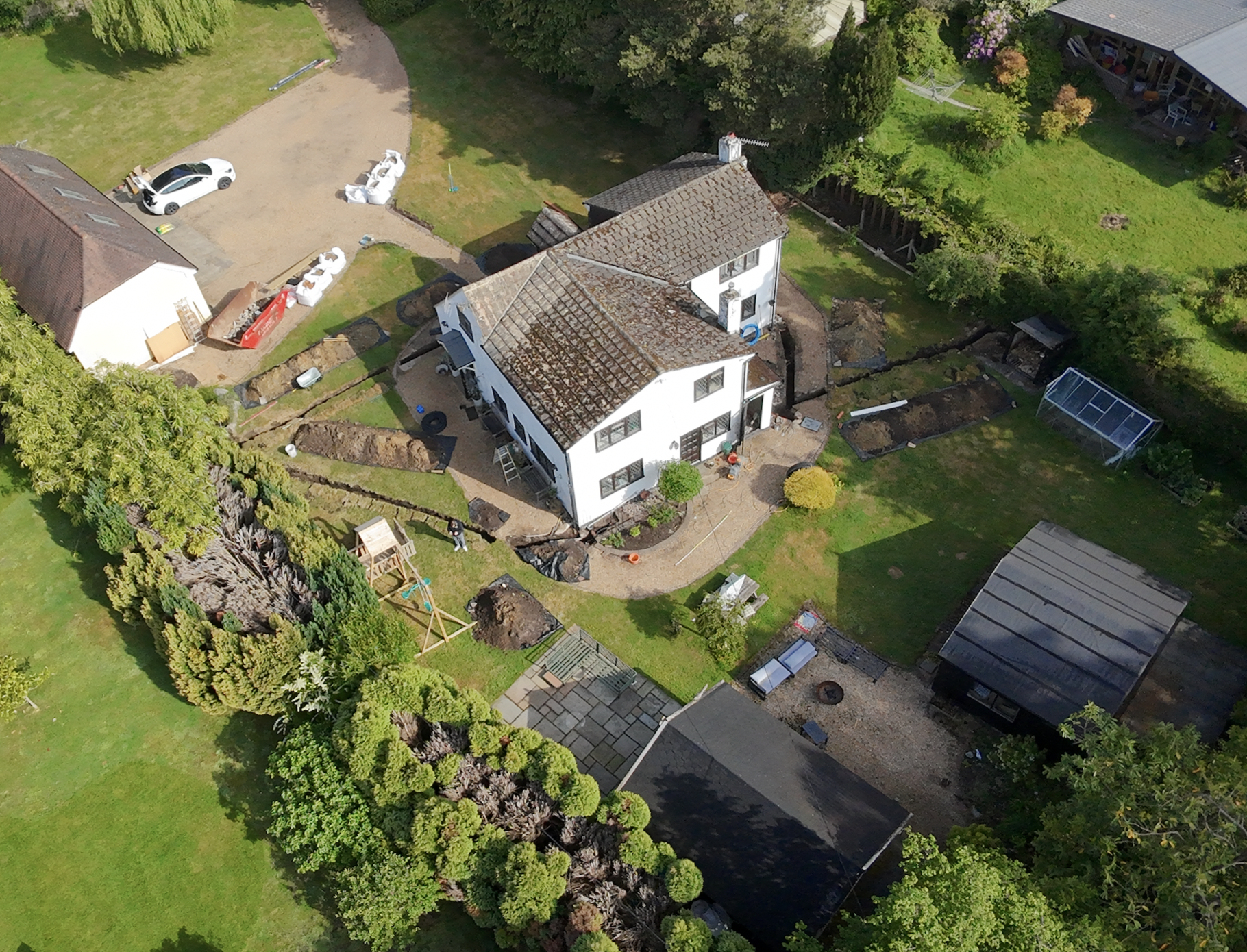

d438a1 Posted Friday at 18:40 Author Posted Friday at 18:40 Yeah I will be paying bills for rental for air bnb. the garage annex will be heated from the ASHP as well. the annex is about 20-30 metres from house. The idea is plant room will be in annex. So HW cylinder and power tank will be in there with ASHP nearby outside

Nickfromwales Posted Saturday at 18:39 Posted Saturday at 18:39 1 hour ago, d438a1 said: Yes I think so. Why do you ask? Then I’d ditch the idea of the umbilical. It’ll have significant heat loss for life, and the costs will only go up over time. I would get a Panasonic mono block heat pump (sub £3k) and fit one to the annex for heating and DHW. Then choose another for the house, and run them as 2 separate systems. If you can swallow the costs for losses then fine, but be aware that it needs factoring in. Having a cold water booster out there that creates an artificial cold mains for the 2 dwellings to share is fine, just know that you’ll need at least a 32mm cold mains pipe from the pump and accumulator to the house to not suffer losses of the stored energy over distance. I’ve done a good few of these with great results, and seen others that fail for a proper lack of understanding as to how the pipework needs to be upsized to suit. No good trying to empty a 4 pint pitcher with a tiny straw. I’d seriously reconsider your options here, for heating and hot water, is my 2 cents.
d438a1 Posted yesterday at 07:35 Author Posted yesterday at 07:35 Thanks for the insight. We are fighting a few competing things in coming up with solution. One of the main things is we may knock down and rebuild house in the near distant future. So by housing all ASHP, HW, CW as well as new electric meter, etc in garage annex it somewhat helps with that. If it helps, we are looking at using insulated pipe like this? https://www.flowsupplies.co.uk/shop/if-bq32-32-25-20-isoflow-32-32-25-20-quadruple-heating-sanitary-dhw-160mm-duct-2067?category=21#attribute_values=350,388,454,456 If I wasn't clear, the new workshop/studio is a further 15m to other side of house which will also make use of ASHP with UFH in the slab.
JohnMo Posted yesterday at 07:56 Posted yesterday at 07:56 3 hours ago, d438a1 said: we are looking at using insulated pipe like this So reality check - spending the same price on piping as an ASHP? If you are knocking down why are spending a fortune on ASHP and heating system? Pipes you linked to are pretty small dia. The pipe sizes will not support your huge heat pump, they are too small for you cold water main with the booster. I have a long run from ASHP to house and use 28mm pipe for that, your 18kW will have to support 3x the flow! You really would need a secondary return loop for DHW to make hot water usable in the house. So you need an additional pipe. If you are knocking down and rebuilding, your heat pump will be huge and no longer appropriate for new house. A new build to slightly better that building regs is unlikely to need any more than 6kW. While your house is being built the 18kW ASHP will not support your rental and workshop - it will be too big and short cycle to an early death. Suspect some more thinking time is needed, your current plan doesn't work!
d438a1 Posted yesterday at 14:30 Author Posted yesterday at 14:30 I'm really appreciating the feedback, thanks. Knocking down maybe in 15 years earliest. Also a possibility we won't. I think regardless of 1 or 2 ASHP, we like the idea of locating heat pump away from house. But yes, it is a lot of money, but idea is we are spending as little as possible in actual house, as for whatever reason the previous owner really over specc'd on radiators. The cold water will likely be mdpe or insulated mlcp as it will be deep enough in trench. The hot water return is therefore in that quad. I've attached a photo to show. So green line is heat pump(s) location, and other side of that wall is where plant room will be. That garage will be converted in to a 2 storey living block, with UFH on ground floor and rads on 2nd floor. It's approx 12x6m. Pink line is trench to the old boiler outhouse where it can easily connect to existing pipework for CH, H and C. It then connects in that outhouse in yellow line out to workshop which will be around 8x5m. 1
Nickfromwales Posted yesterday at 14:47 Posted yesterday at 14:47 Can't the ASHP and plant go into the outhouse, ASHP to the rear/side elevations for convenience, so you have the shortest umbilical possible? For the annex, defo a stand alone ASHP there and a simple UVC for DHW, in isolation, and job done. You're adding a huge run there for UG pipework, which if the DHW HRC is in there too will be recirculating at 60oC+! This is less than great if it's just lower grade heat or a very short run, but at the temps and losses you'll have I think it's one to avoid. I'd seriously look at having the UVC's in the respective spaces that they'll service, and even look at oversizing them so they can be heated via off peak electricity directly via the immersions, as that will massively reduce the labour on the heat pump(s) and the losses from the HRC etc. With modern insulated UVC's and their very low standing losses, I'd go for DHW from electricity, and local ASHP's for space heating, and drop the HRC and UG pipework to the very minimum requirement. Put the accumulators and pump set (if you need a pump) in the annex, no probs there. Any need for heating or hot water in the outbuilding (orange)?
d438a1 Posted yesterday at 14:57 Author Posted yesterday at 14:57 Well the idea is to have zero equipment in the house so when it's likely knocked down everything can still operate. We did originally consider the ASHP on that side elevation but it's going to be a patio area as well as it gets evening sun. In the outbuilding, yep it will have UFH in the concrete slab and also hot water. A lot of different options to consider...
JohnMo Posted yesterday at 15:12 Posted yesterday at 15:12 29 minutes ago, d438a1 said: Knocking down maybe in 15 years earliest So not really on the agenda, not even worth discussing it so far in to the future, so much can change in that time. 12 years ago I moved in to my forever home - since built a house elsewhere and sold the forever home. All your equipment could be ready for scrap heap if you don't install well in 15 years time. Have actually sized the heat loads you need? No idea the insulation levels of the additional building or the house? The heat pump could be big or it could be way undersized?
Nickfromwales Posted yesterday at 15:59 Posted yesterday at 15:59 1 hour ago, d438a1 said: Well the idea is to have zero equipment in the house so when it's likely knocked down everything can still operate. We did originally consider the ASHP on that side elevation but it's going to be a patio area as well as it gets evening sun. In the outbuilding, yep it will have UFH in the concrete slab and also hot water. A lot of different options to consider... Fit the UVC in the house, remove and reinstate when (if) you rebuild. £1500 or so isn’t huge and the cost of the pipework and running costs of the UG multi core pipework will be 4x that.
d438a1 Posted yesterday at 16:33 Author Posted yesterday at 16:33 Yeah the MCS installer did the heat loss calcs. I’ve asked him for the detail. Bit rough maths was 12kw for house, annex 4kw and workshop 2kw. I think I’m coming round to idea of UVC in house outhouse. If it’s to be purely electric fed would I not need a heat pump type? I think he had spec’d the uk cylinder elite heat pump one. What abput one ASHP for house and workshop and 1 for annex? But both located at garage…

d438a1 Posted 22 hours ago Author Posted 22 hours ago So just so I'm clear on options... Option 1: - 18kw 3ph ASHP and UVC in annex supplying heating and hot water for all 3 buildings (annex, house and workshop) Option 2: - 18kw ASHP in annex powering heating for all 3 buildings UVC in garage connected to heatpump supplying annex only UVC in house powered by electric only for hot water in house and workshop Option 3: - 12-16kw ASHP powering house and workshop located at annex 4-6kw ASHP powering annex located at annex UVC in garage connected to heatpump supplying annex only UVC in house powered by electric only for hot water in house and workshop I think that captures it? Question is...does option 2 and 3 still allow for grant? Thanks
