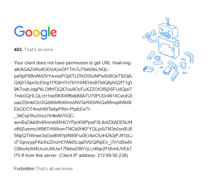

Stoph43 Posted June 23, 2025 Posted June 23, 2025 Hello Gang, we looking to get your thought / advice or any experience from anyone who has used Marmox Thermoblocks. - Where building a simple timber frame 2 story new build - Frame delivery is in a few months 140mm wall with an additional 100mm PIR inside, on concrete slab with 150mm PIR on top followed by screen - We're just finishing excavating the strip foundations and about to order the concrete. Cross section of the foundations below - Is it worth us adding a layer of Thermoblocks in between the 2 x 140mm block courses? (shown in RED arrow) Would they benefit in our situation? Would be great to hear your thoughts, Thanks
JohnMo Posted June 23, 2025 Posted June 23, 2025 Can you add an attachment - not sure what you have added but it doesn't open. I found the gains weren't worth the cost. I used thermolite blocks, with engineered bricks on top to attach stud walls.
