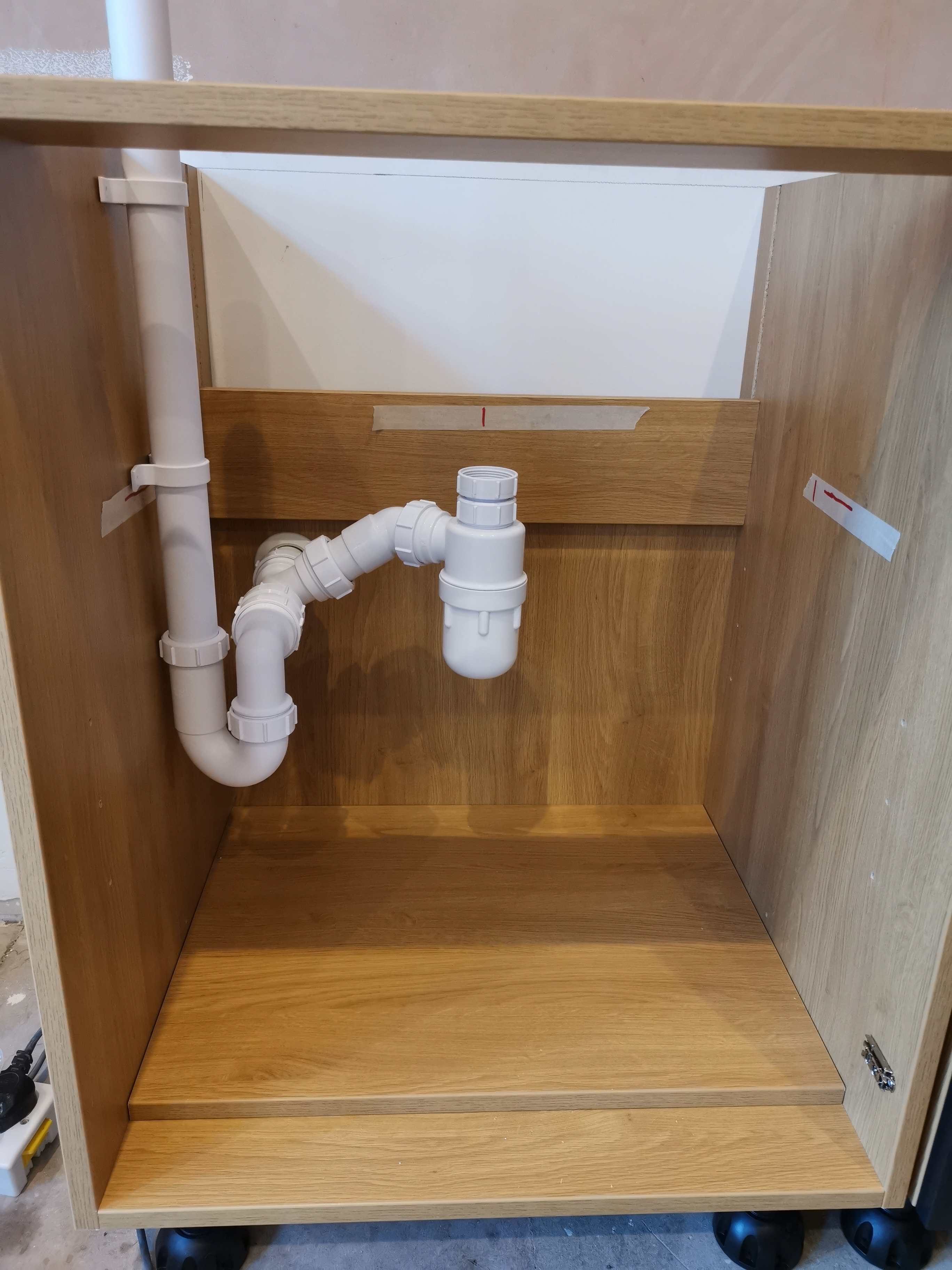

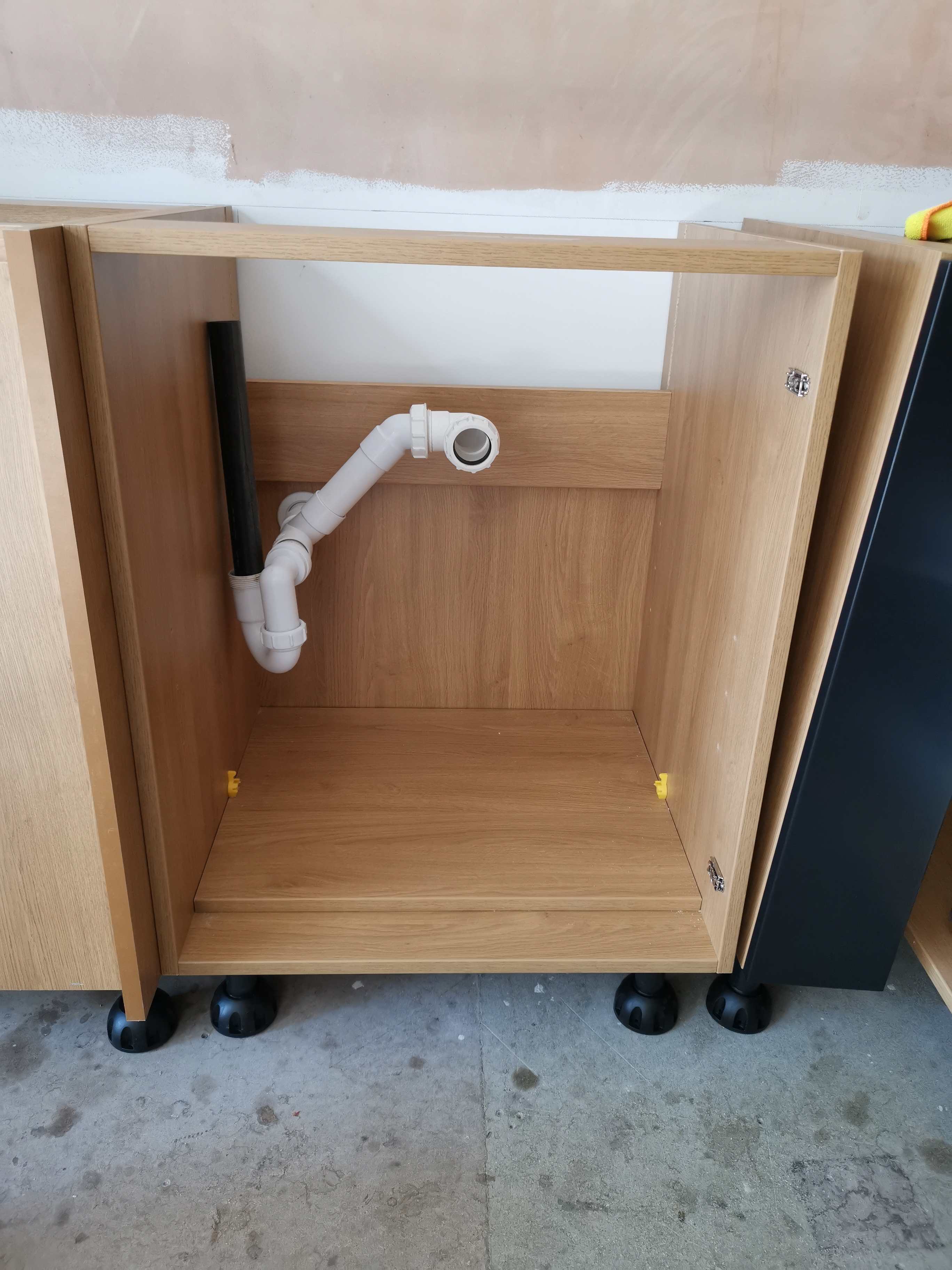

Super_Paulie Posted June 24, 2025 Posted June 24, 2025 (edited) I've been playing with my pipe this afternoon, and after that I thought I'd look at the plumbing under the sink. I've mocked this up with any old crap I could find in my plumbing box, so imagination is required. Then just a bottle trap at the end of this and Robert is my father's brother? @Nickfromwales Edited June 24, 2025 by Super_Paulie
Super_Paulie Posted June 24, 2025 Posted June 24, 2025 38 minutes ago, Nickfromwales said: @Super_Paulie yup. 👍 While you're here Nick, any recommendations on a bottle trap that isn't sh1t3?
Nickfromwales Posted June 24, 2025 Posted June 24, 2025 1 hour ago, Super_Paulie said: While you're here Nick, any recommendations on a bottle trap that isn't sh1t3? McAlpine is industry standard stuff. Floplast also good. Some are telescopic to make life easier.

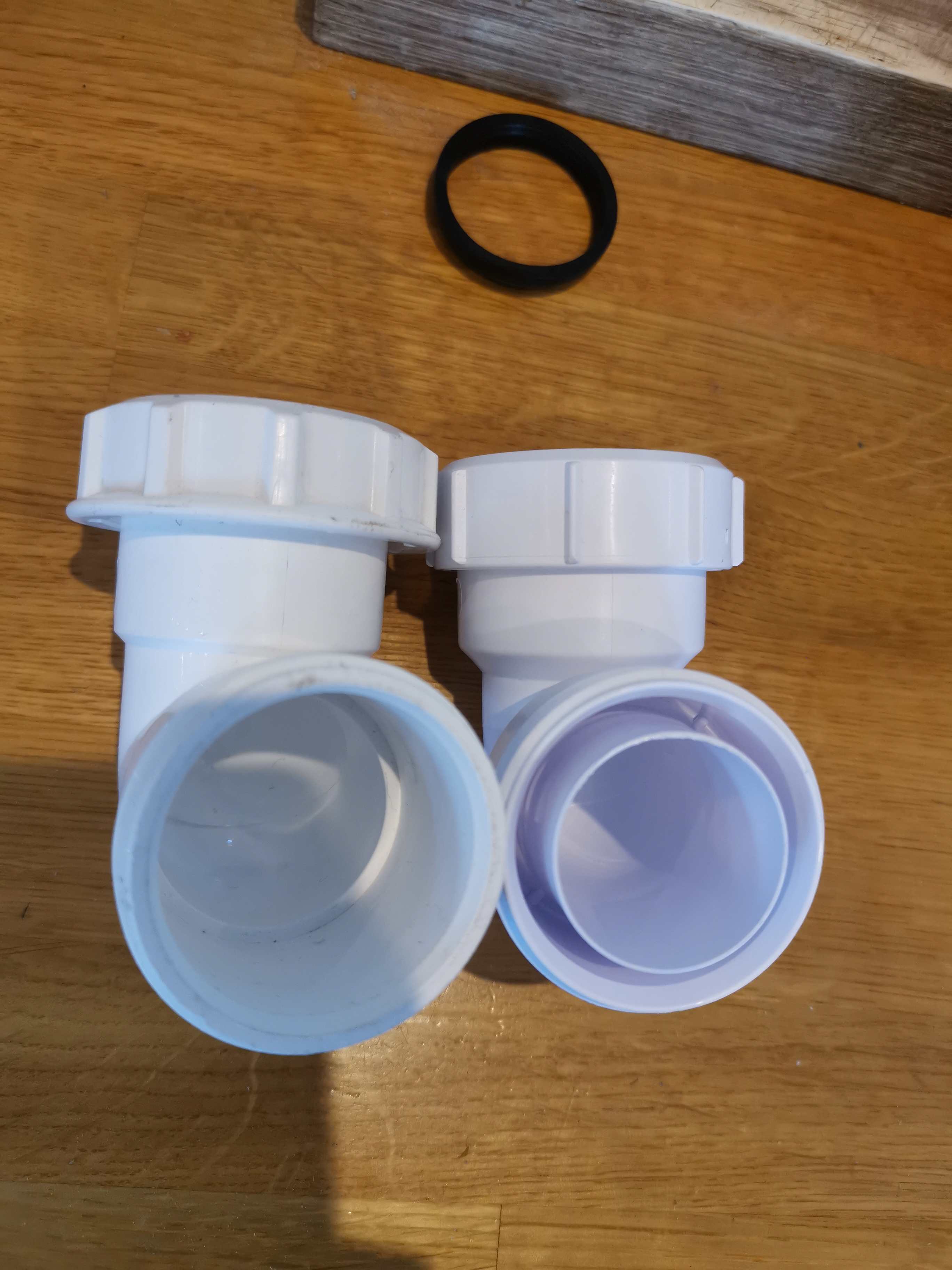

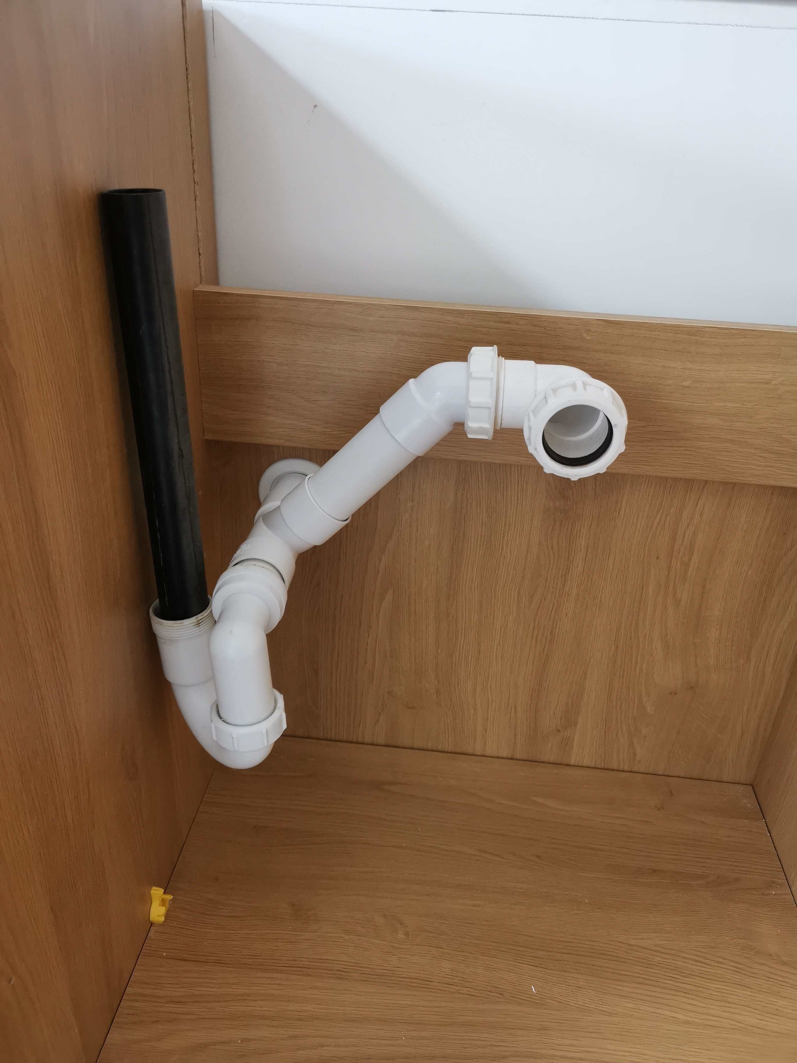

Super_Paulie Posted June 25, 2025 Posted June 25, 2025 (edited) 23 hours ago, Nickfromwales said: McAlpine is industry standard stuff. Floplast also good. Some are telescopic to make life easier. Pretty straightforward, just need to cut the standpipe to size. I ordered the "upgrade" you mentioned in a previous discussion which is compression elbow and a spigot for the top of the standpipe but the elbow has that flange inside and it won't go into the top so I assume I need a compression elbow-reducer to fit it. Other than that, I'm happy so far, cheers Nick. Edit. Actually just checked and the Floplast compression elbow doesn't have that internal flange like the McAlpine does. Edited June 25, 2025 by Super_Paulie
