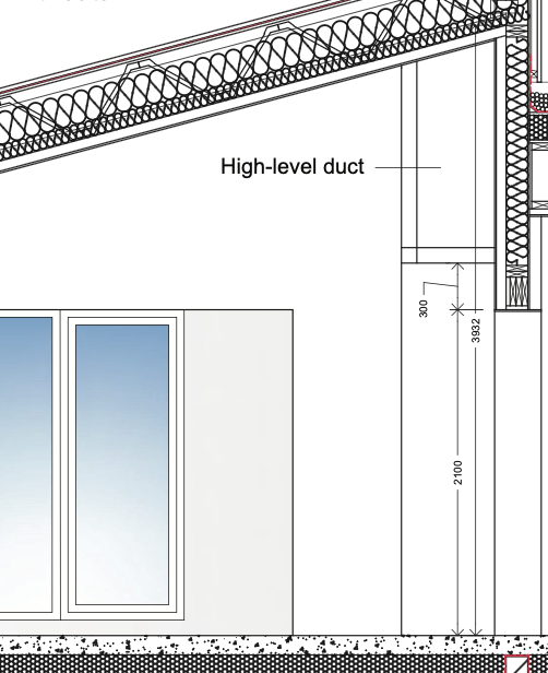

the only drawing with it in any detail is the snip above, which doesn't really detail any divisions / anything special.
the drawing has the plasterboard run past it but as you can imagine I need the void for first fix so can't fully plasterboard anything, I've plasterboard the wall section of it but need to leave the roof part until wired,

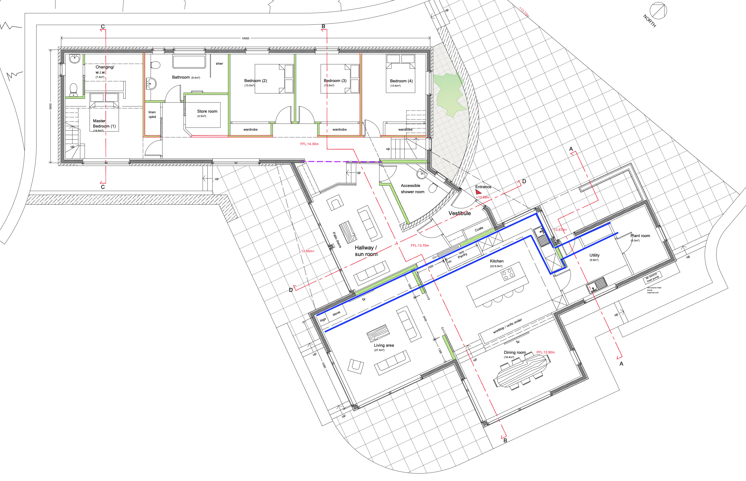

thanks for the replies, there is no fire rated partitions or protected areas,
I have not actually had any questions from BC on this im just trying to figure out if it is going to be something that is questioned as I can see that it might be something they could query as they are very focused on fire spread etc.
they have insisted on me putting an LD1 fire alarm system in so this may help.
the building has 2 sections, 1 single storey and one storey and a half, this section is single storey, the floor plan for the ground floor is attached. and I've marked up in blue where the service access void is
