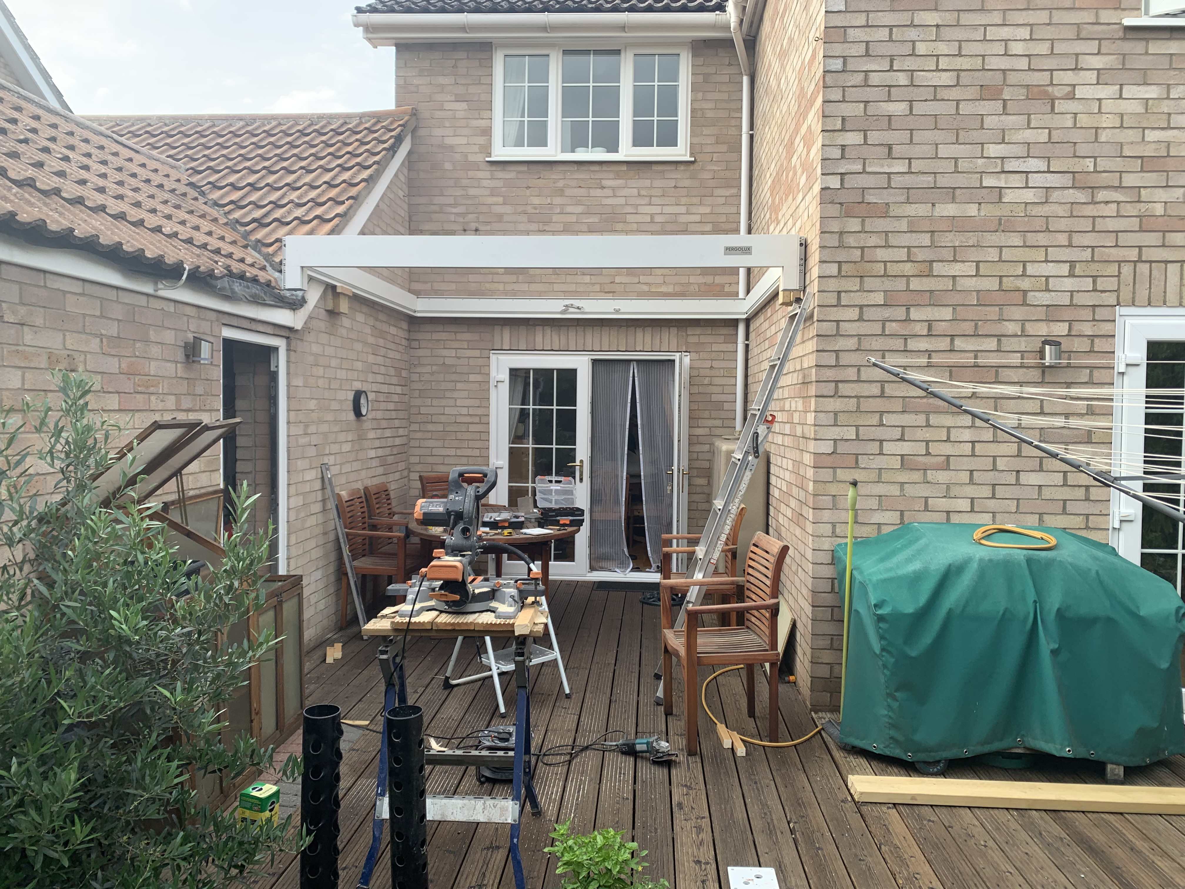

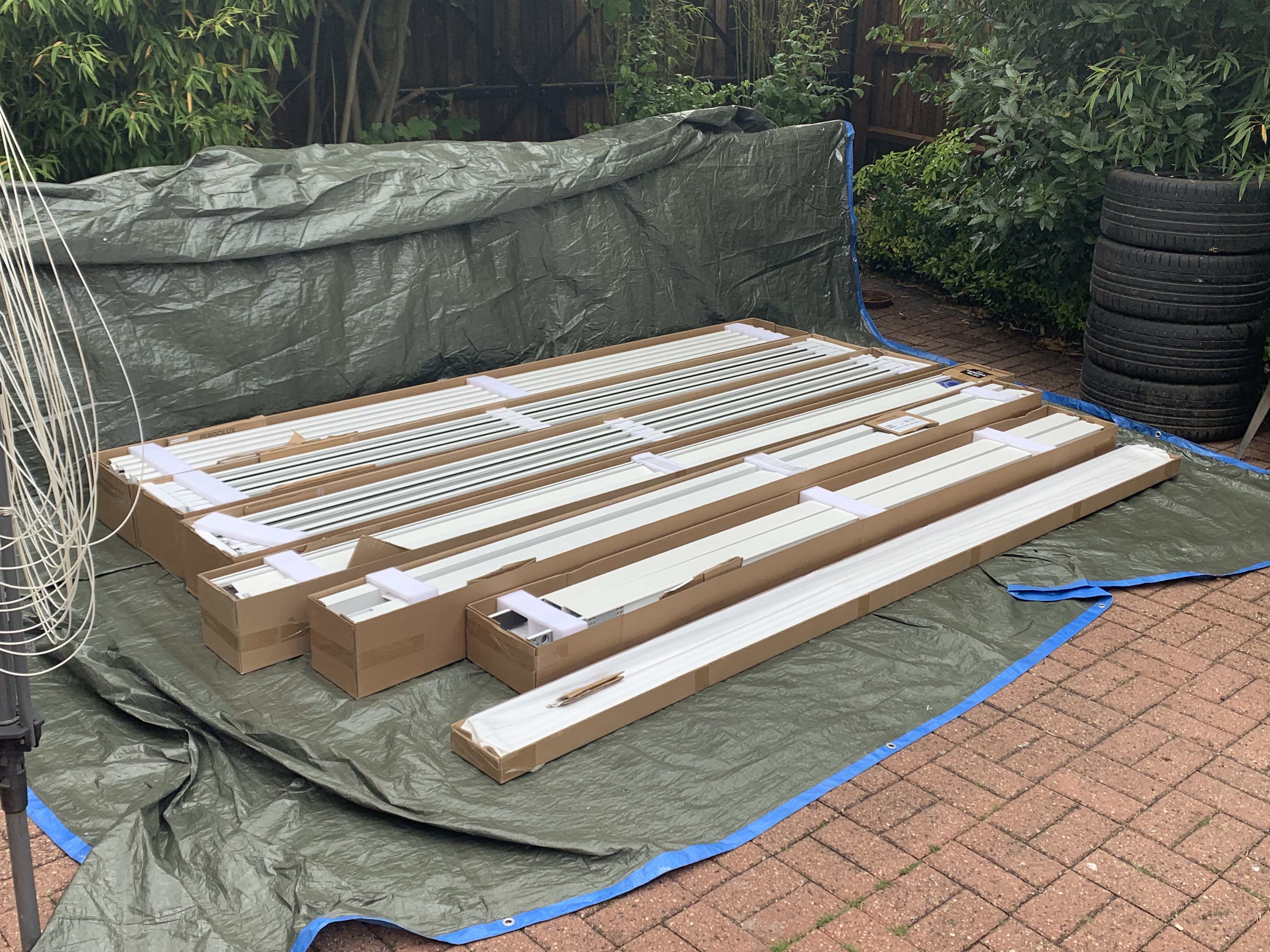

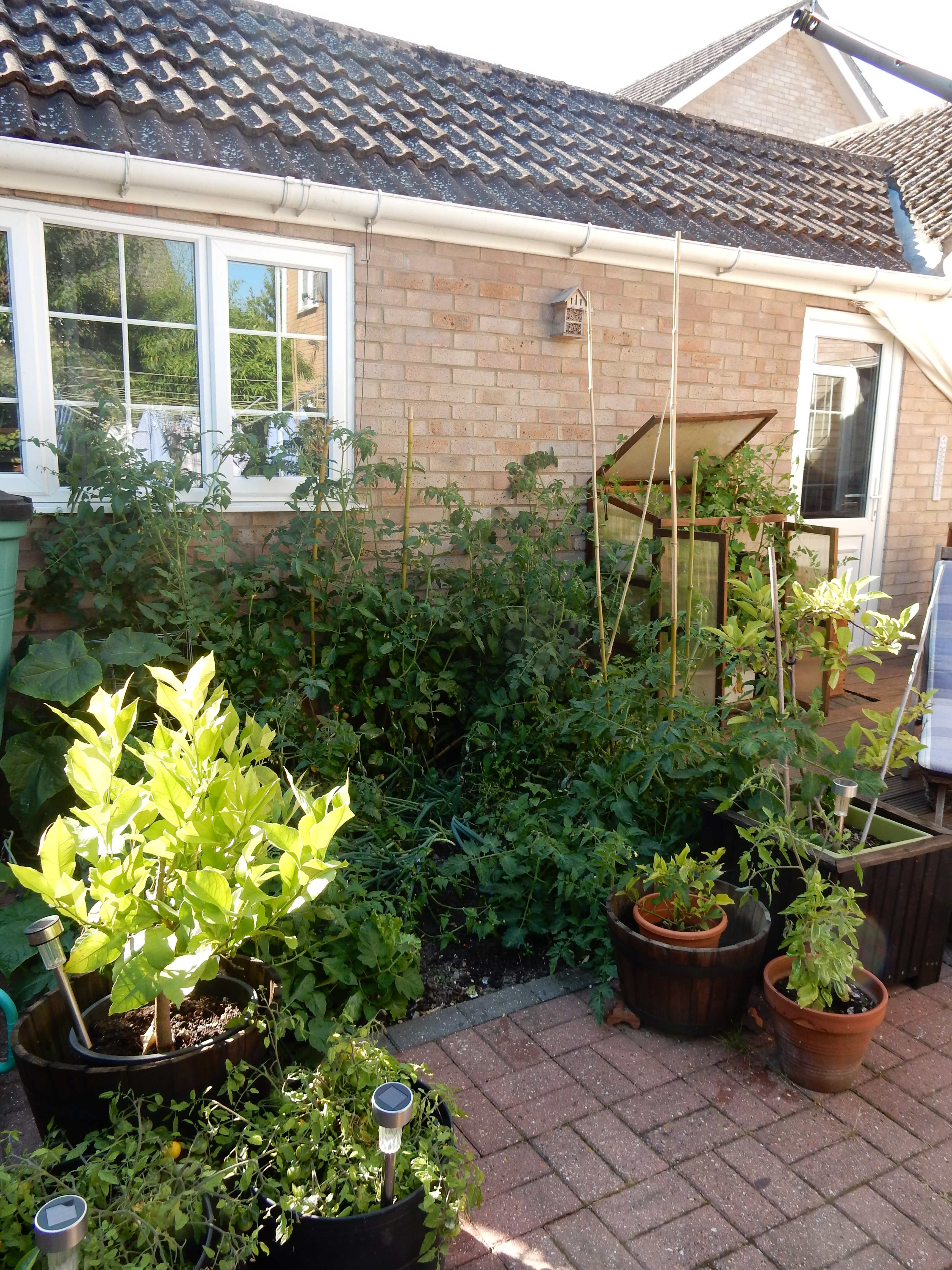

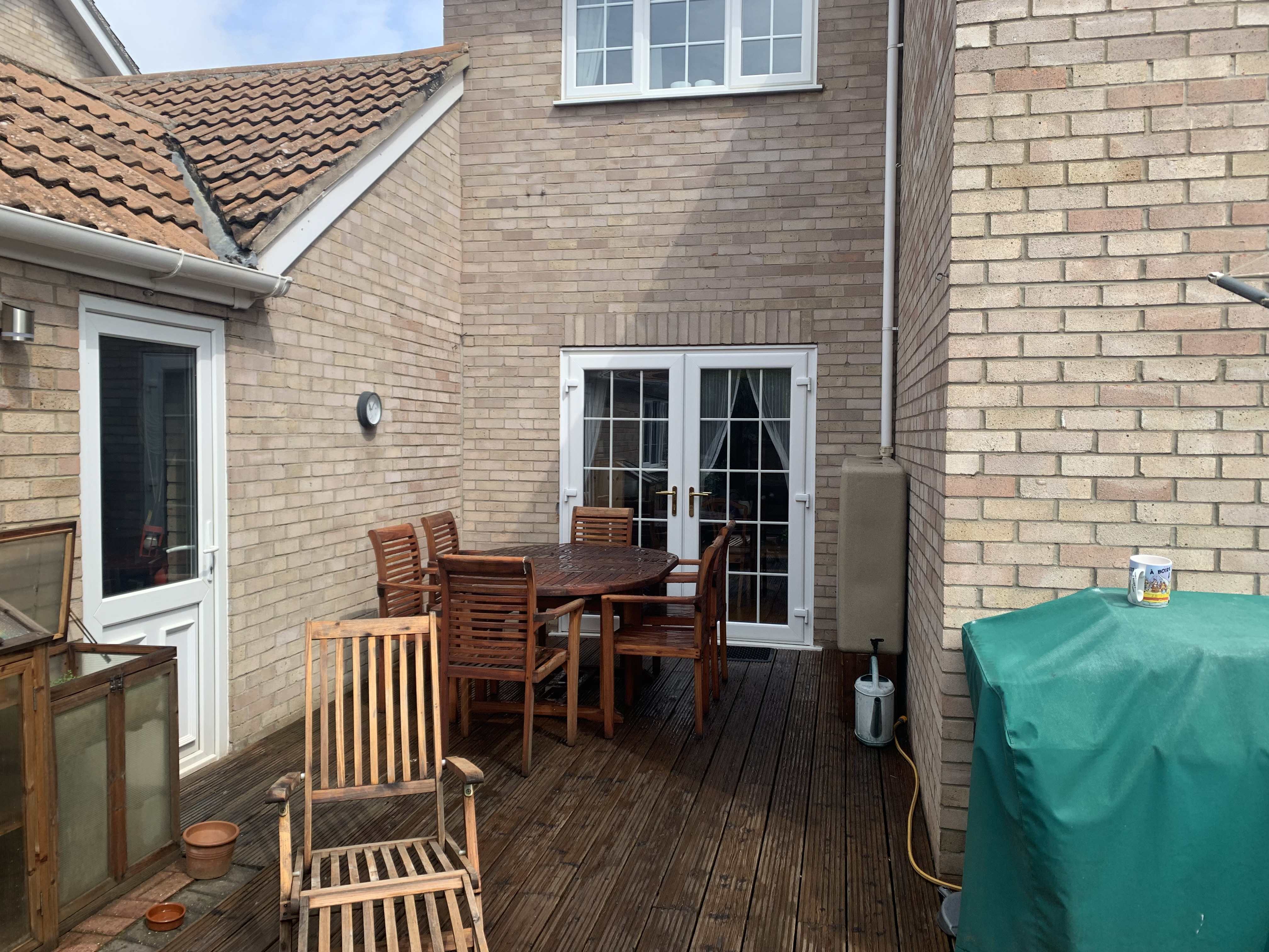

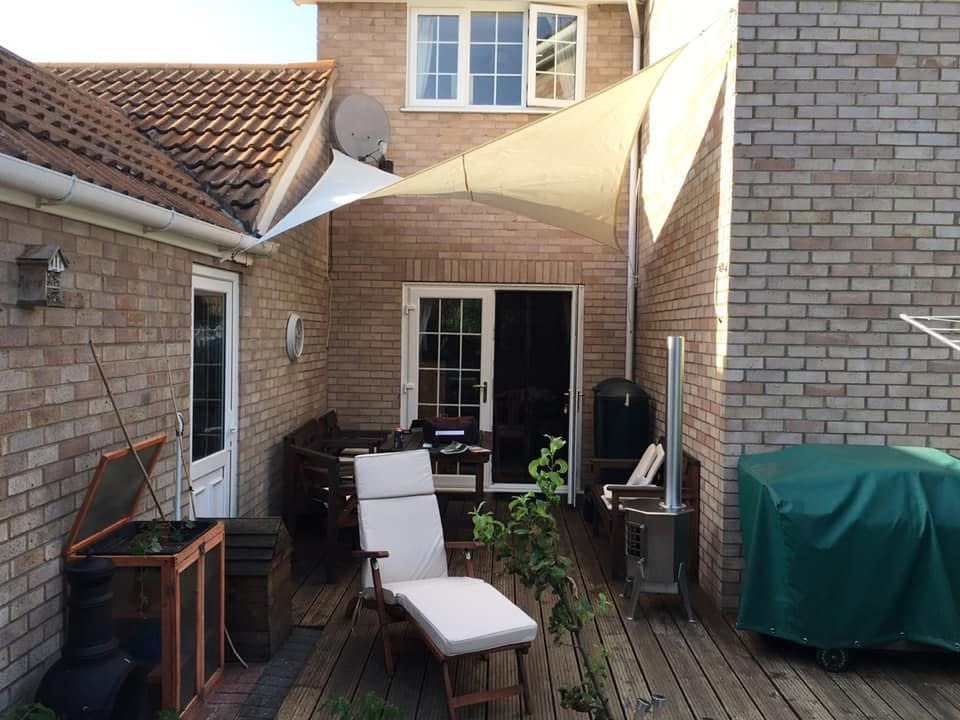

marshian Posted June 7, 2025 Posted June 7, 2025 Current area For the last 10 years we’ve had a sail over the area but they don’t last long (2 years at best) and the water run off in a downpour soaks the walls so we tried a mesh one which was better for not soaking the walls but not great for sitting under it when it rains Bought a pergola from a well known brand and it got delivered this week - today the plan is dodge the showers and see if I can get it installed un-packing the seven boxes took a while Then clear the area ready to start No written destructions are supplied - no packing list - apparently I have to download an app and watch a video and we all ignore destructions anyway so how hard can it be!!!!
JohnMo Posted June 7, 2025 Posted June 7, 2025 Will watch with interest - my next project apparently.
marshian Posted June 7, 2025 Author Posted June 7, 2025 39 minutes ago, JohnMo said: Will watch with interest - my next project apparently. it’s been on Mrs Alien’s list of “things I want” for a while so far I’ve got two legs assembled 🙂

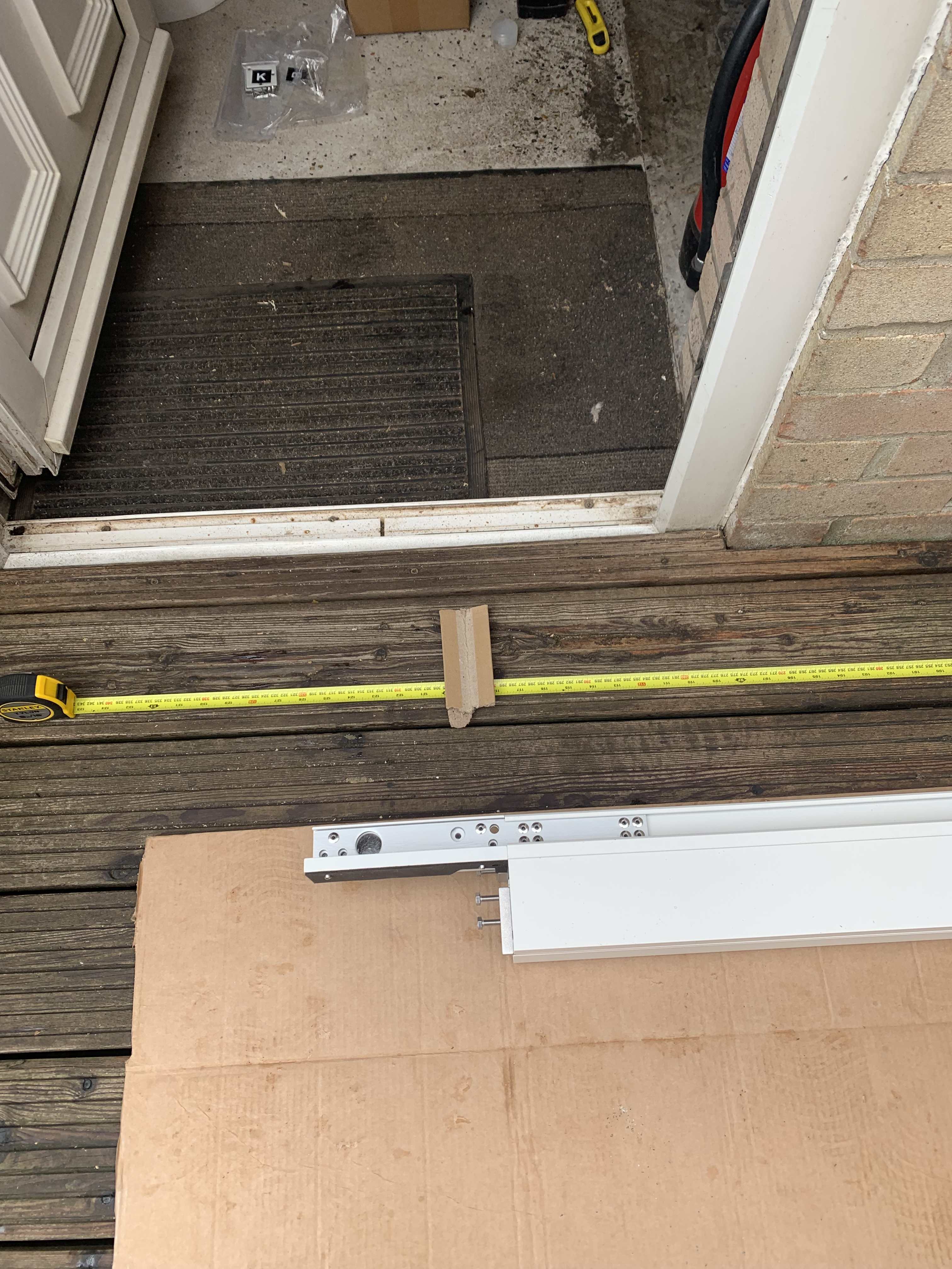

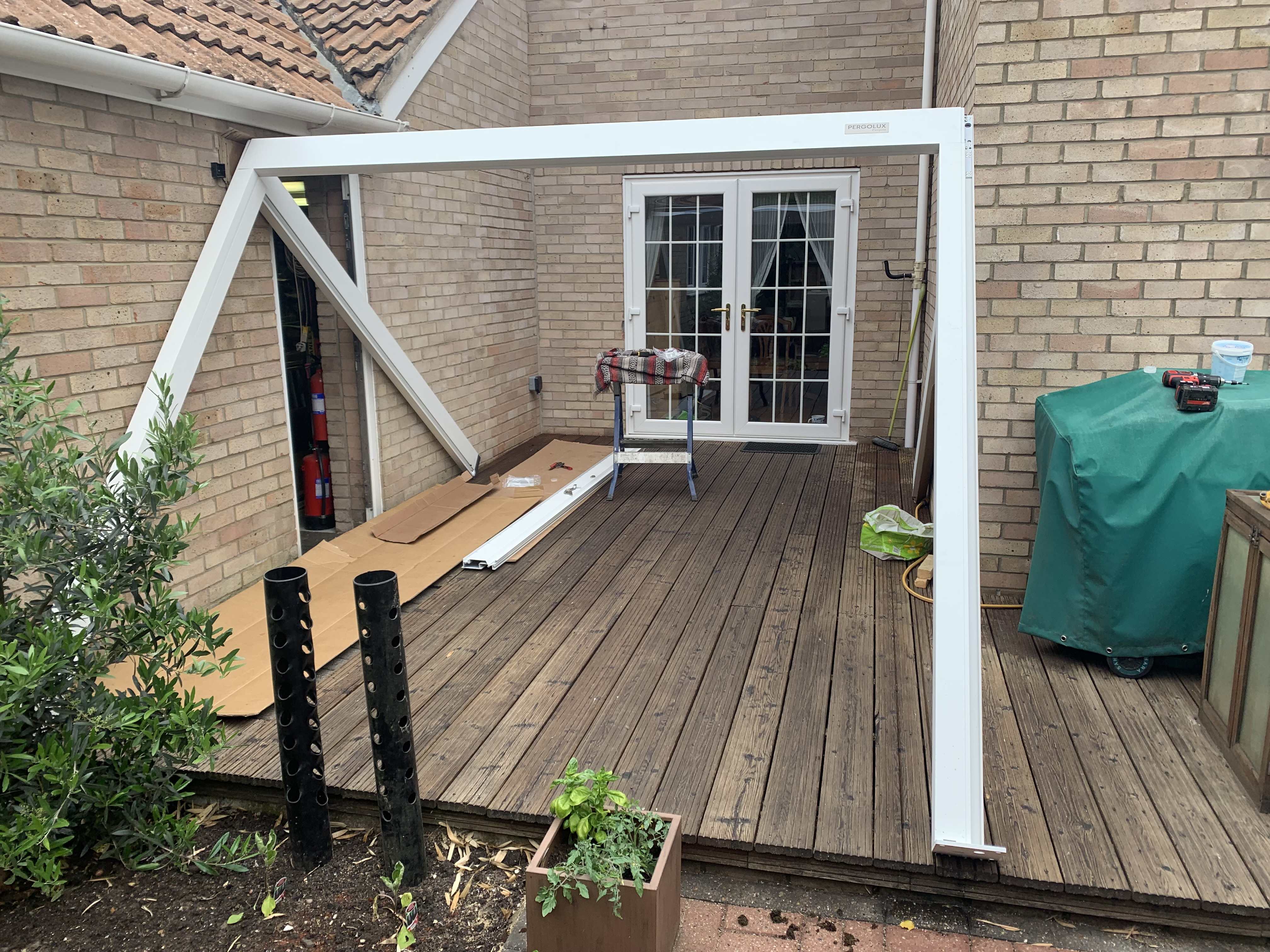

marshian Posted June 7, 2025 Author Posted June 7, 2025 The video “suggests” doing the wall mount next - so I’m going to ignore that - the decked area has a fall on it for drainage so the “suggested” height might not be right for the location (I already know one of the legs is gonna be in the middle of my garage side door so l’ll need to get creative there (3m x 3m) cardboard is 3m from mounting wall hahaha
marshian Posted June 7, 2025 Author Posted June 7, 2025 44 minutes ago, JohnMo said: Those pesky gutters clearance achieved Finished height will be above them wall mount end is the tricky bit I have to fit a 3000 mm width pergola in a 3070 mm gap and there is a 68 mm drainpipe there too I knew it was gonna be snug but I’ll find a way to make it work
marshian Posted June 7, 2025 Author Posted June 7, 2025 The intention is to have no legs touching the decking (shortened to minimum and then wall mounted is the plan) I can shorten the legs without voiding the warranty but I can’t make any alterations to the roof section without losing the warranty

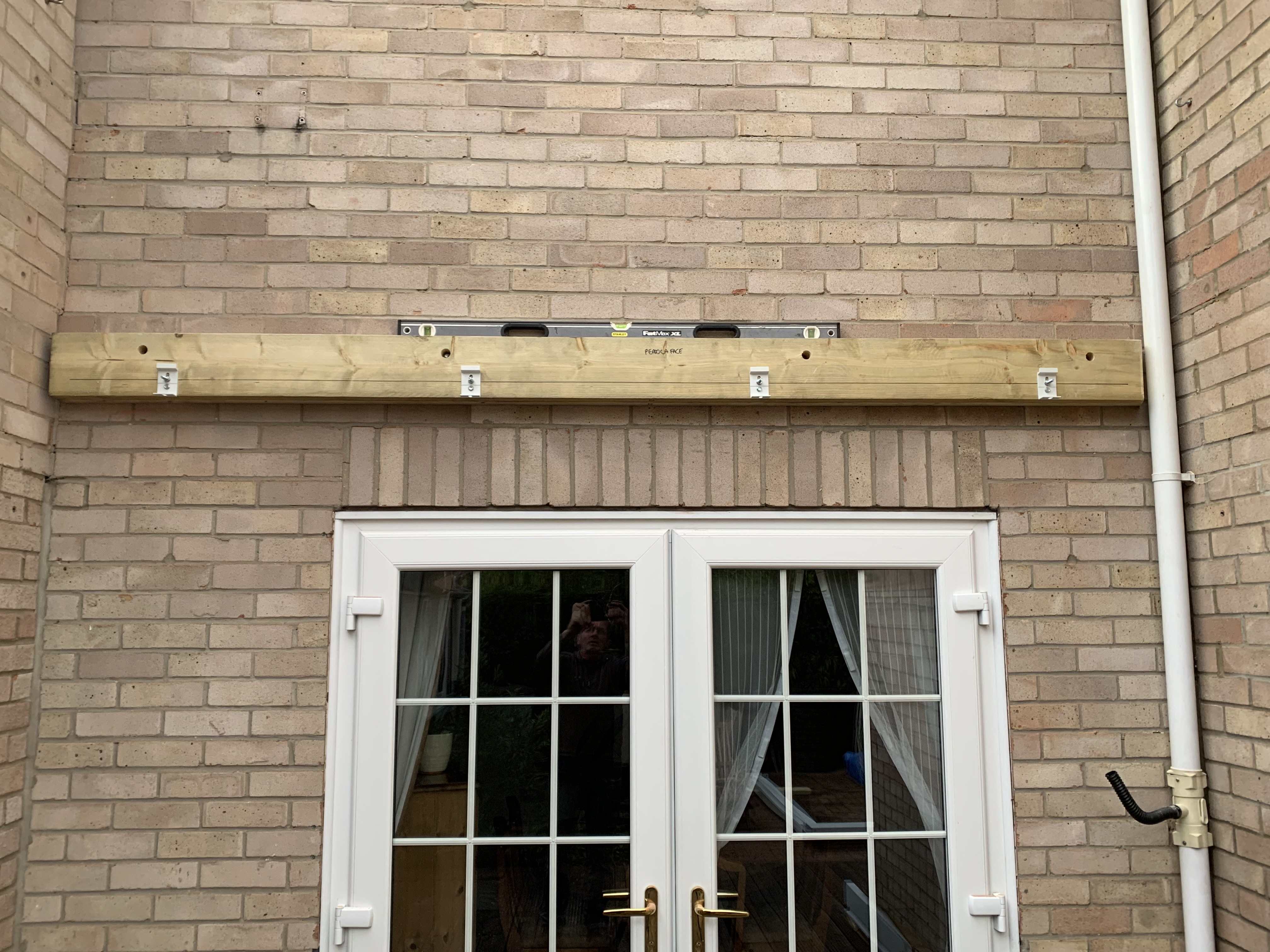

marshian Posted June 8, 2025 Author Posted June 8, 2025 Wall mount / spacer complete yes it took me all day - I’m a measure 100 times drill or cut once kinda guy (plus manhandling the beams on your own is hard bloody work) Mrs Alien is 4 ft 10 in socks and has the lifting abilities/strength of a small hen Doubled up beam both are 2940 x 170 x 45 mm in new money. First one bolted to the wall in 4 places with 12 x 100 mm thro bolts. Second beam coach bolted thro both with M8 coach bolts. Now I’ve got clearance for the down-pipe behind the pergola wall mount. Next I need to find some willing friends - it is a three man lift and there still isn’t a lot of wiggle room…. 1

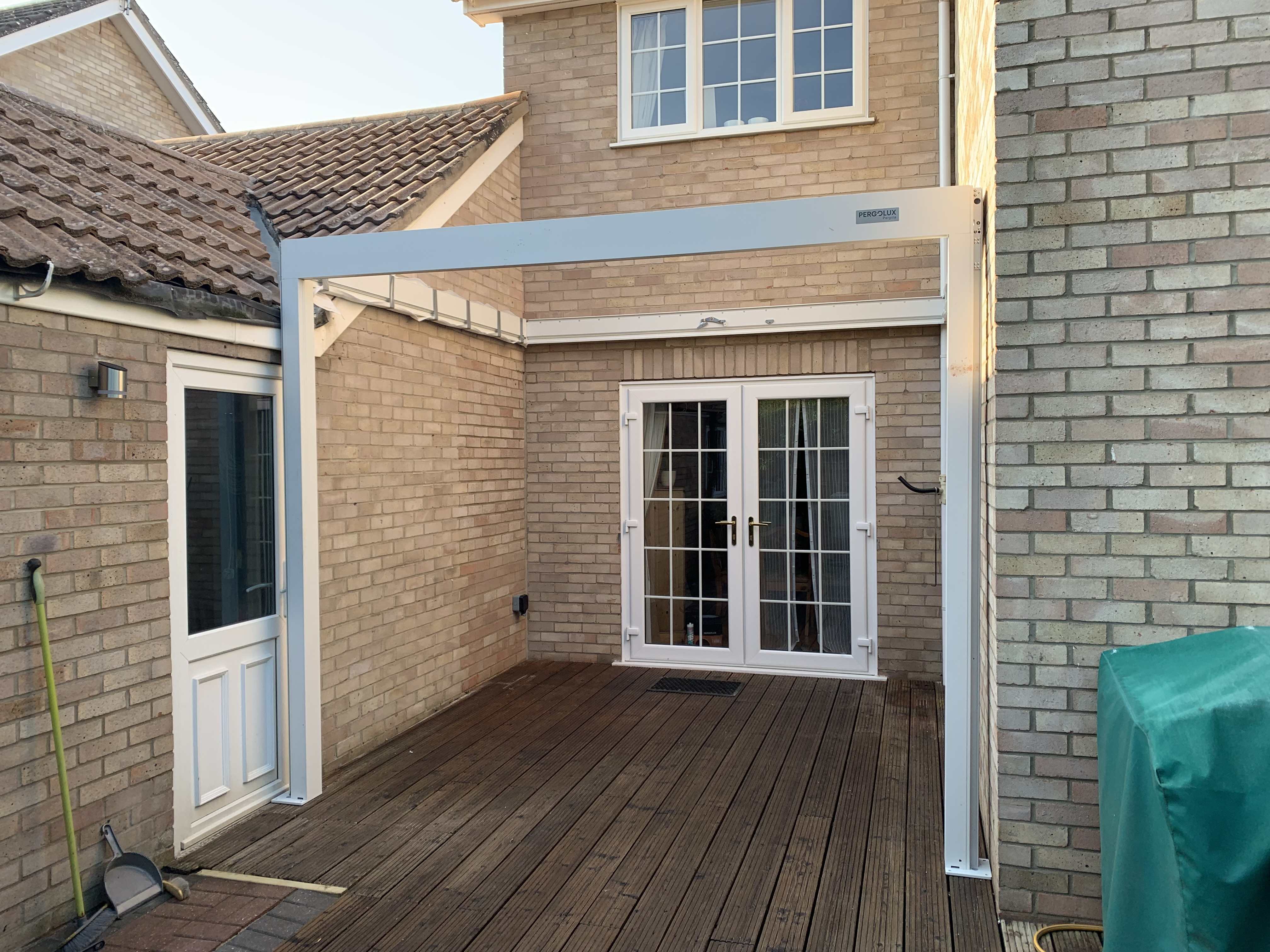

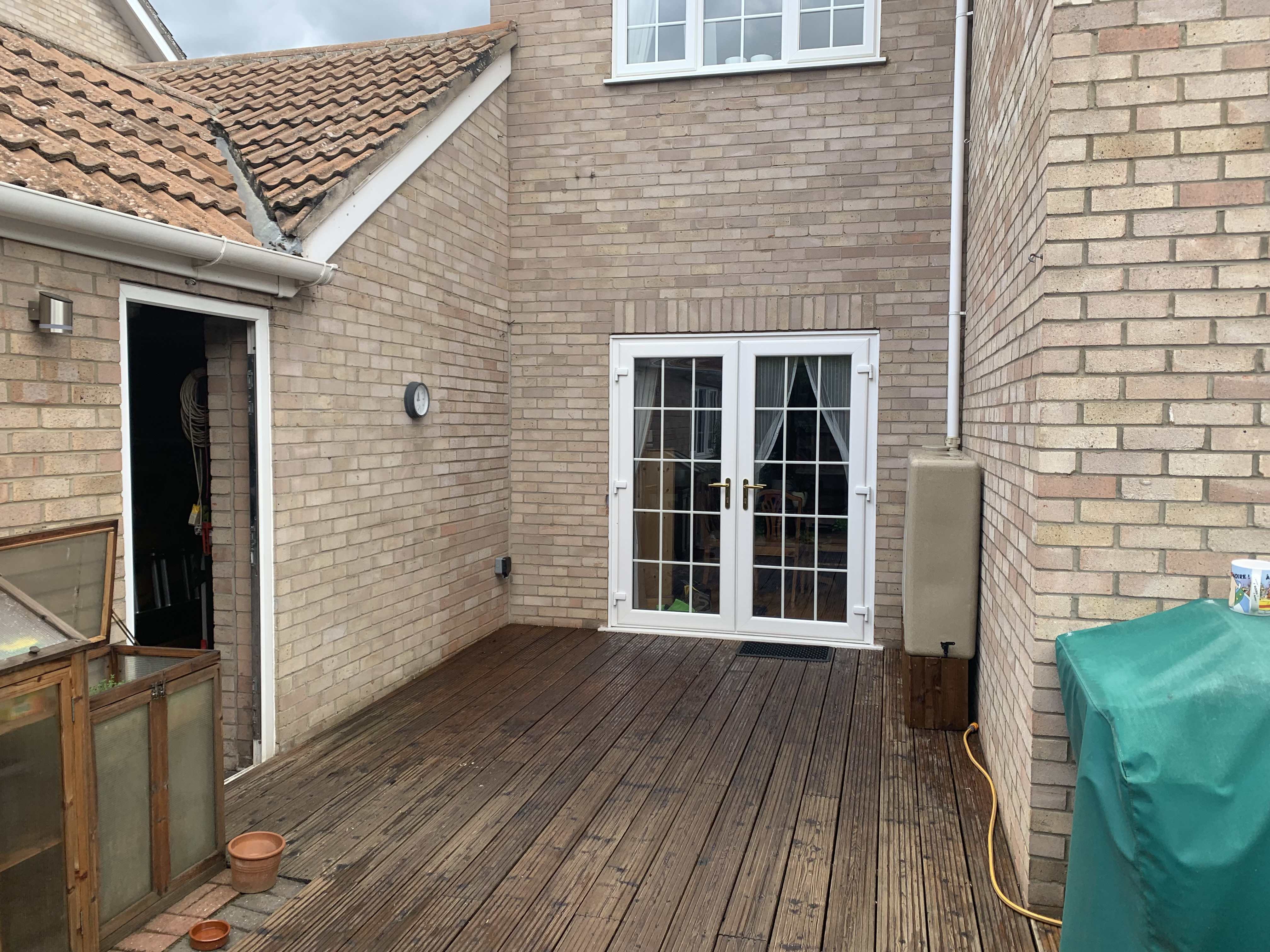

marshian Posted June 30, 2025 Author Posted June 30, 2025 I wasn’t wrong either @JohnMo has finished his finally found a picture of the normal sail arrangement at the weekend supported the side rails (once I had both sides level) and then removed the front and legs shortened the legs and modified the foot plates. next task make the support brackets

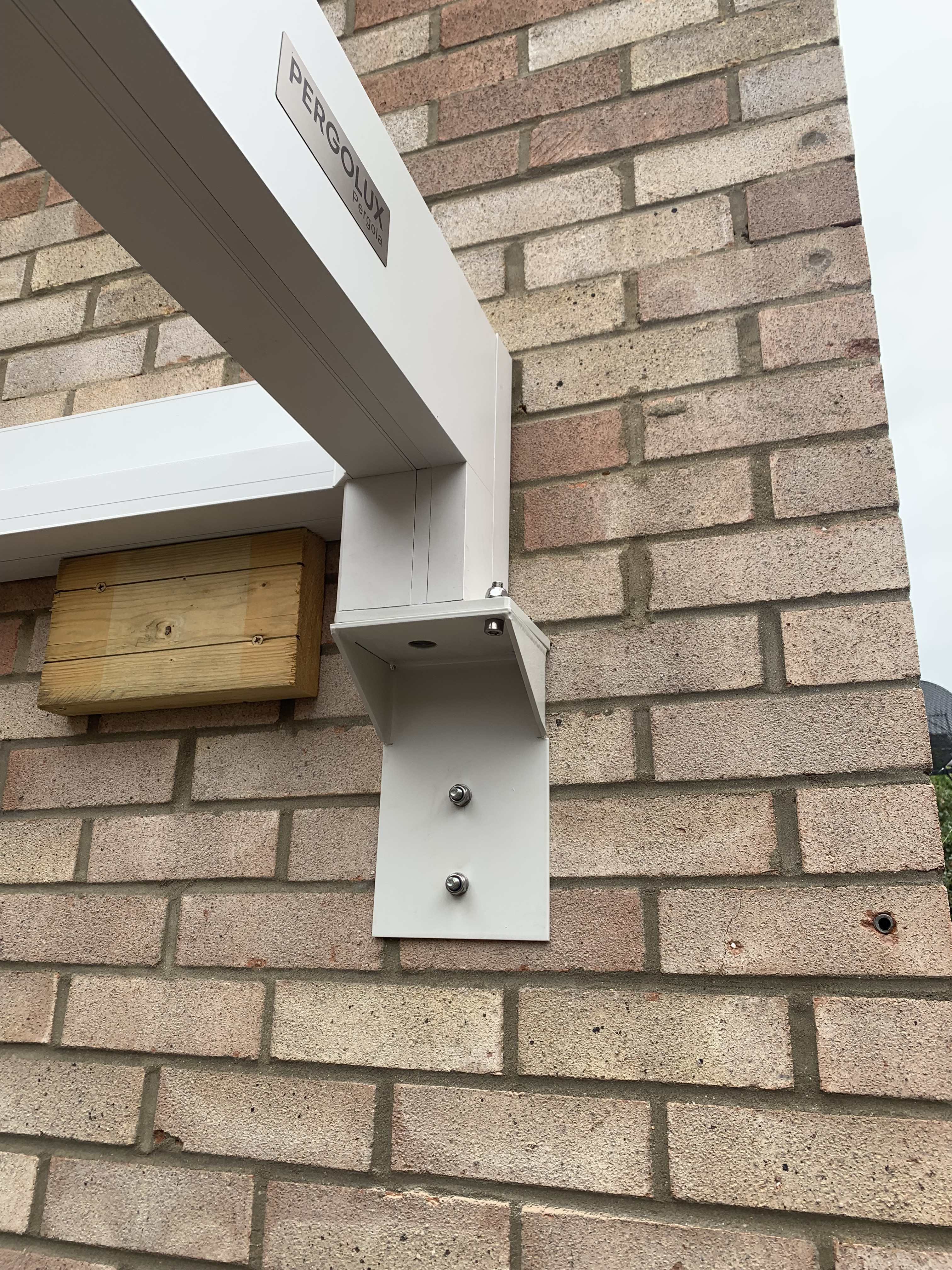

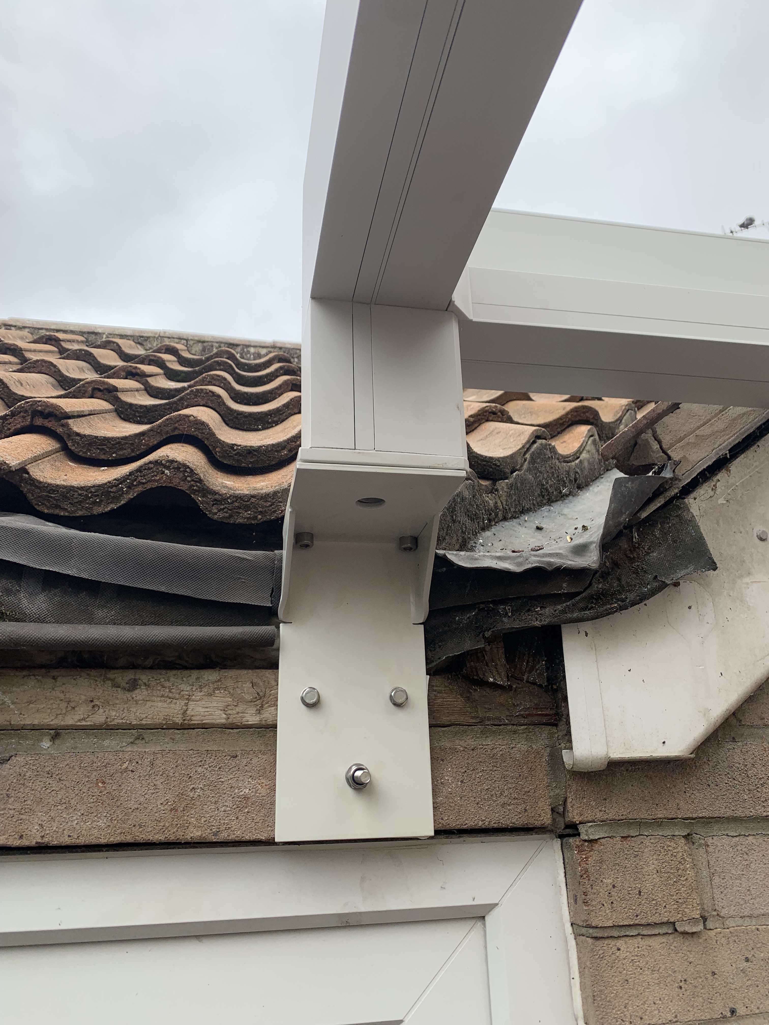

marshian Posted August 20, 2025 Author Posted August 20, 2025 This has taken a while…… Support brackets fabricated in 5mm stainless steel then welded up Fitted them and was very pleased with the overall look Mrs Alien not so happy….. so I sent them off to be powder coated in white to match now fitted And the other side you won’t actually see much of them the first one will be almost covered by the garage fascia board and gutter the second one by a water removal pipe stopping it draining onto the decking better finish the rest of it now 1

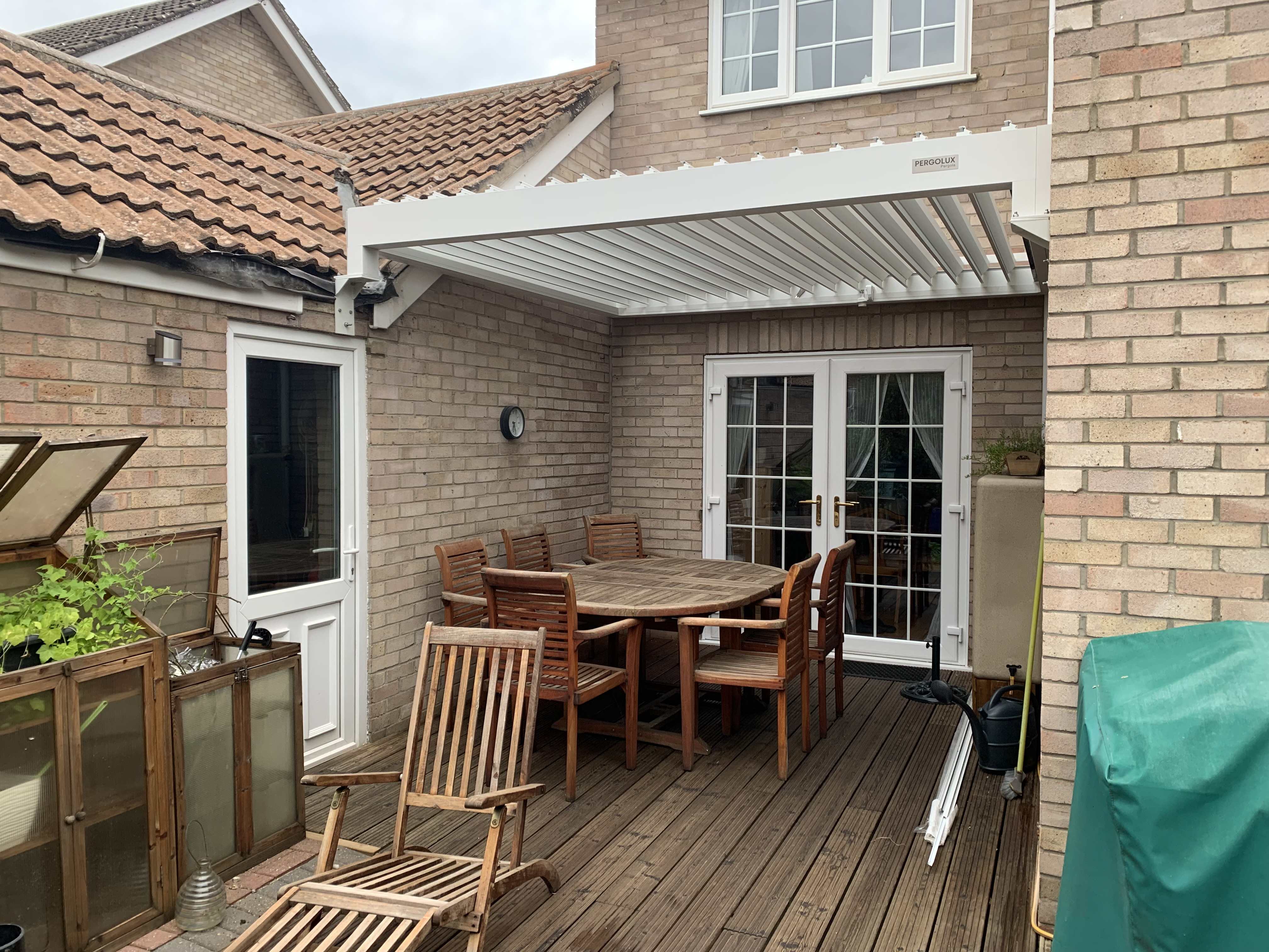

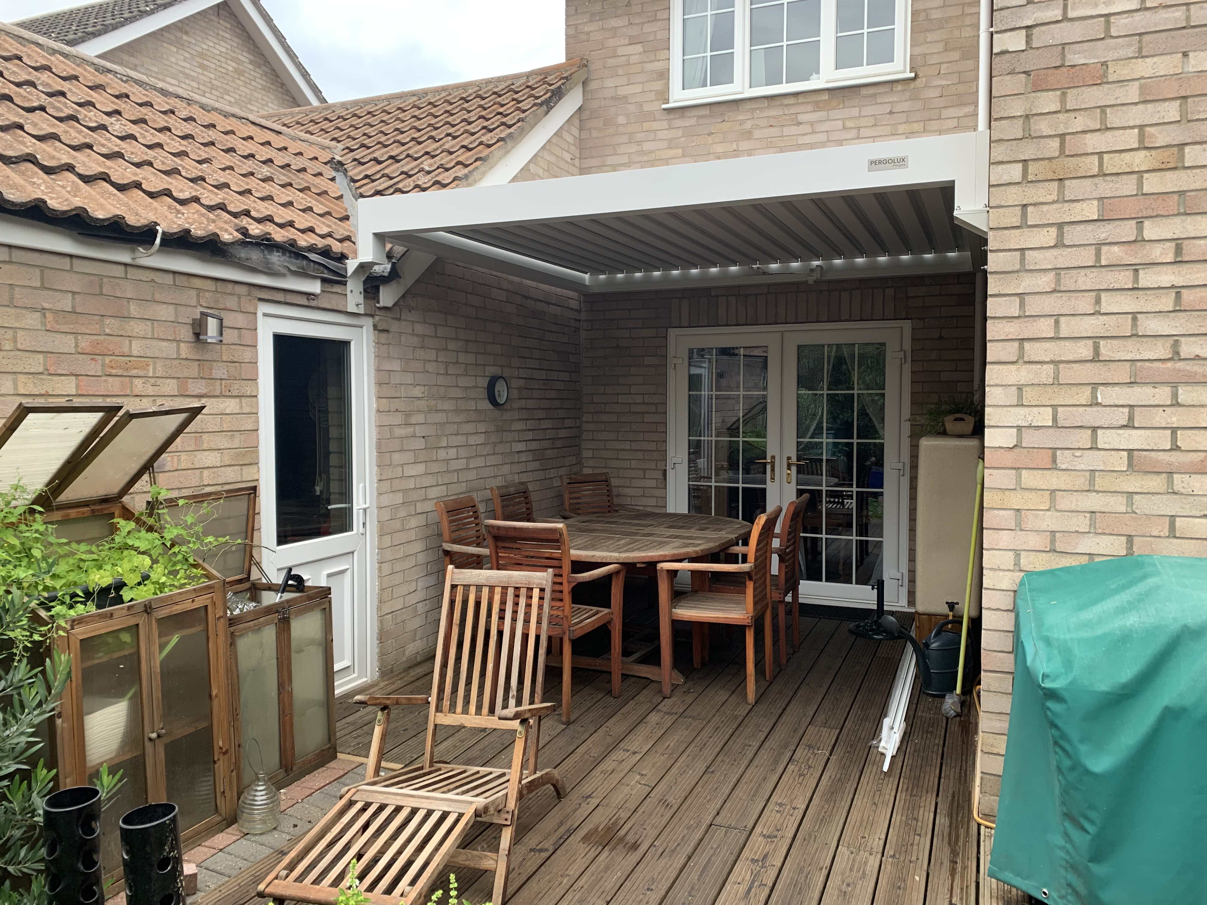

marshian Posted August 23, 2025 Author Posted August 23, 2025 Well bar a little bit of trimming work it’s done Louvres shut Louvres open suns gone and it’s cloudy so light isn’t the best for photos need to re-instate gutters and fascia and sort out the drainage but quite happy how it turned out - It was never going to be a quick job and limboing round a post parked smack in the middle of the garage side door would have been awful 3

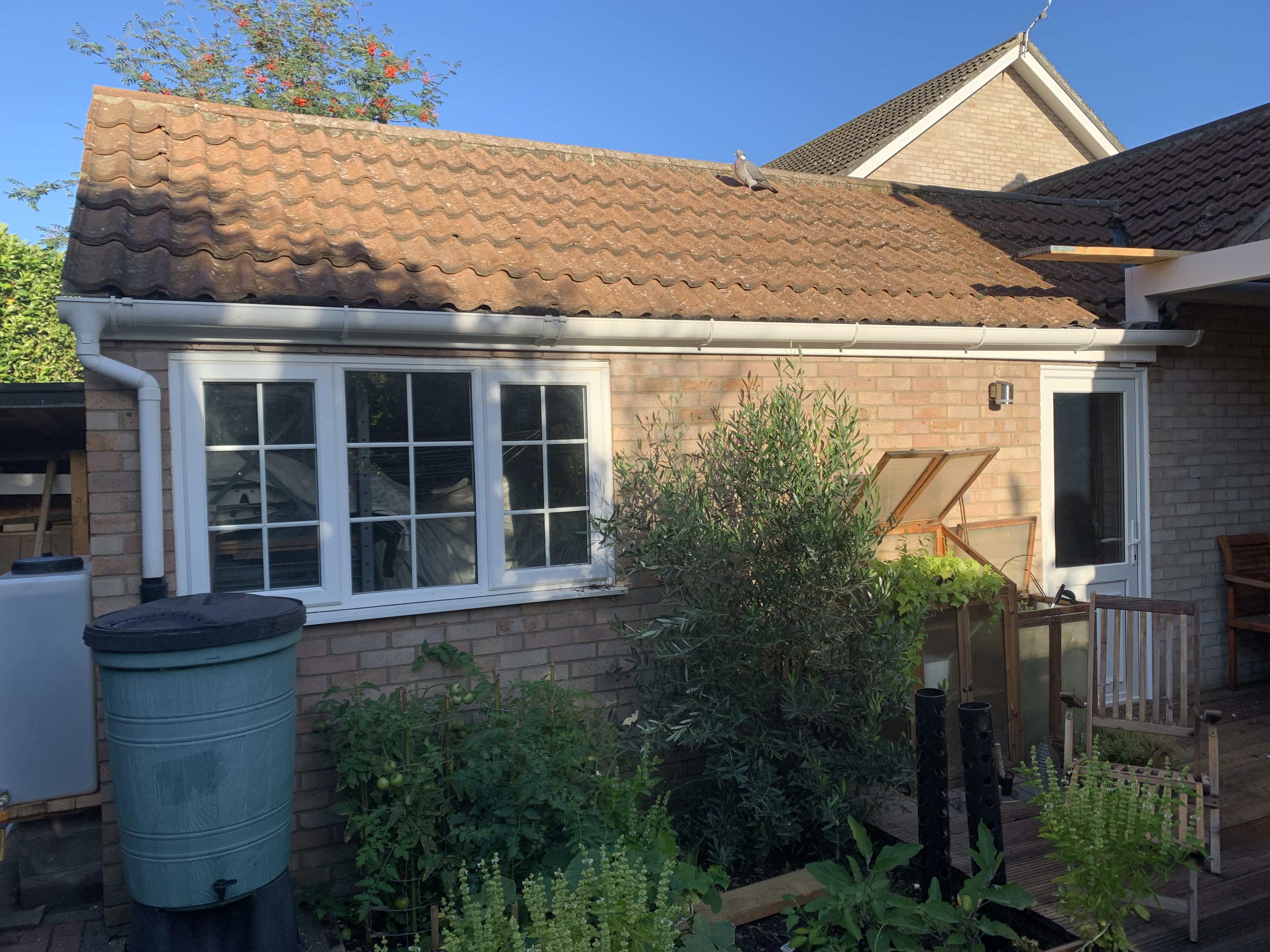

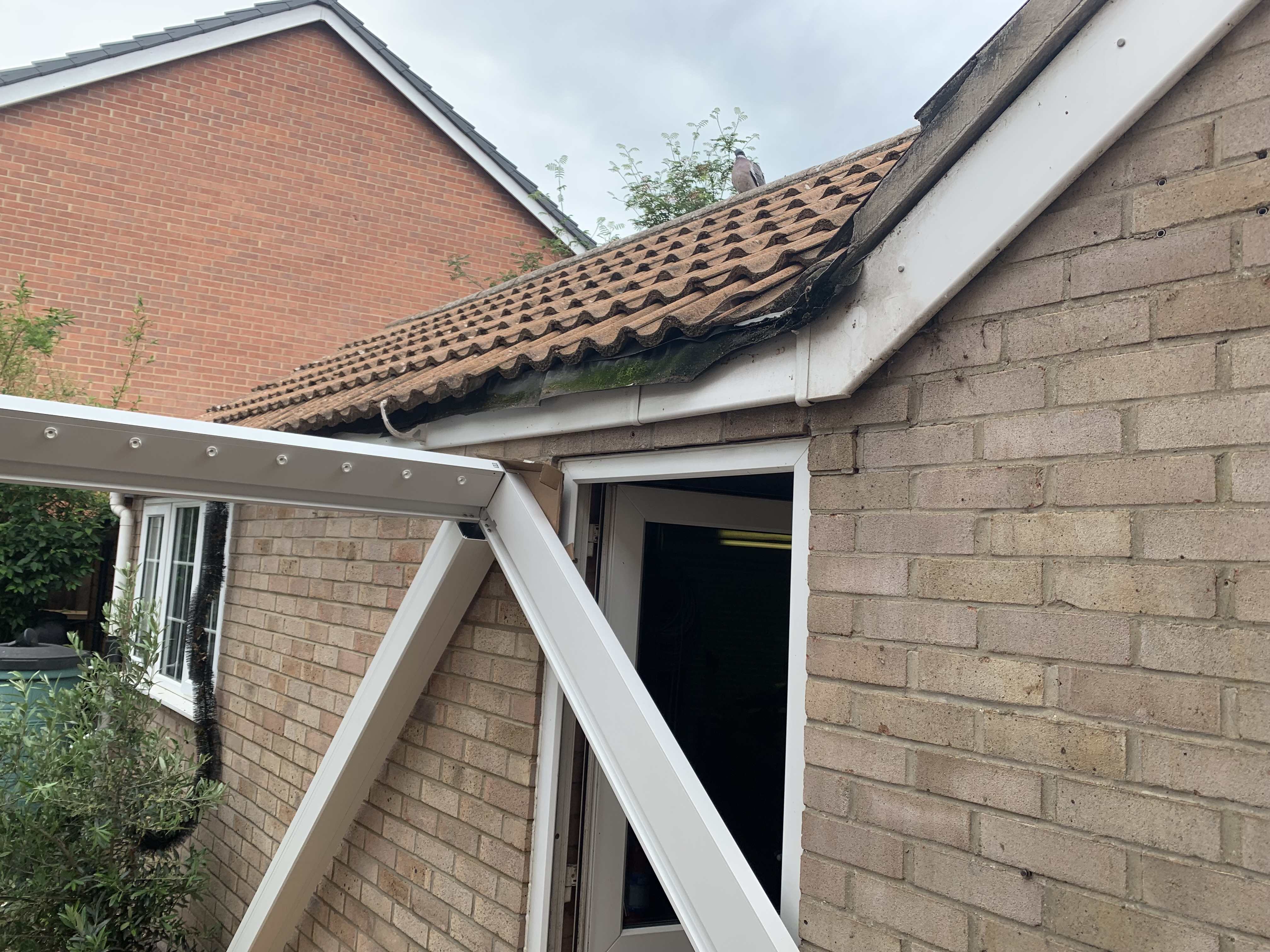

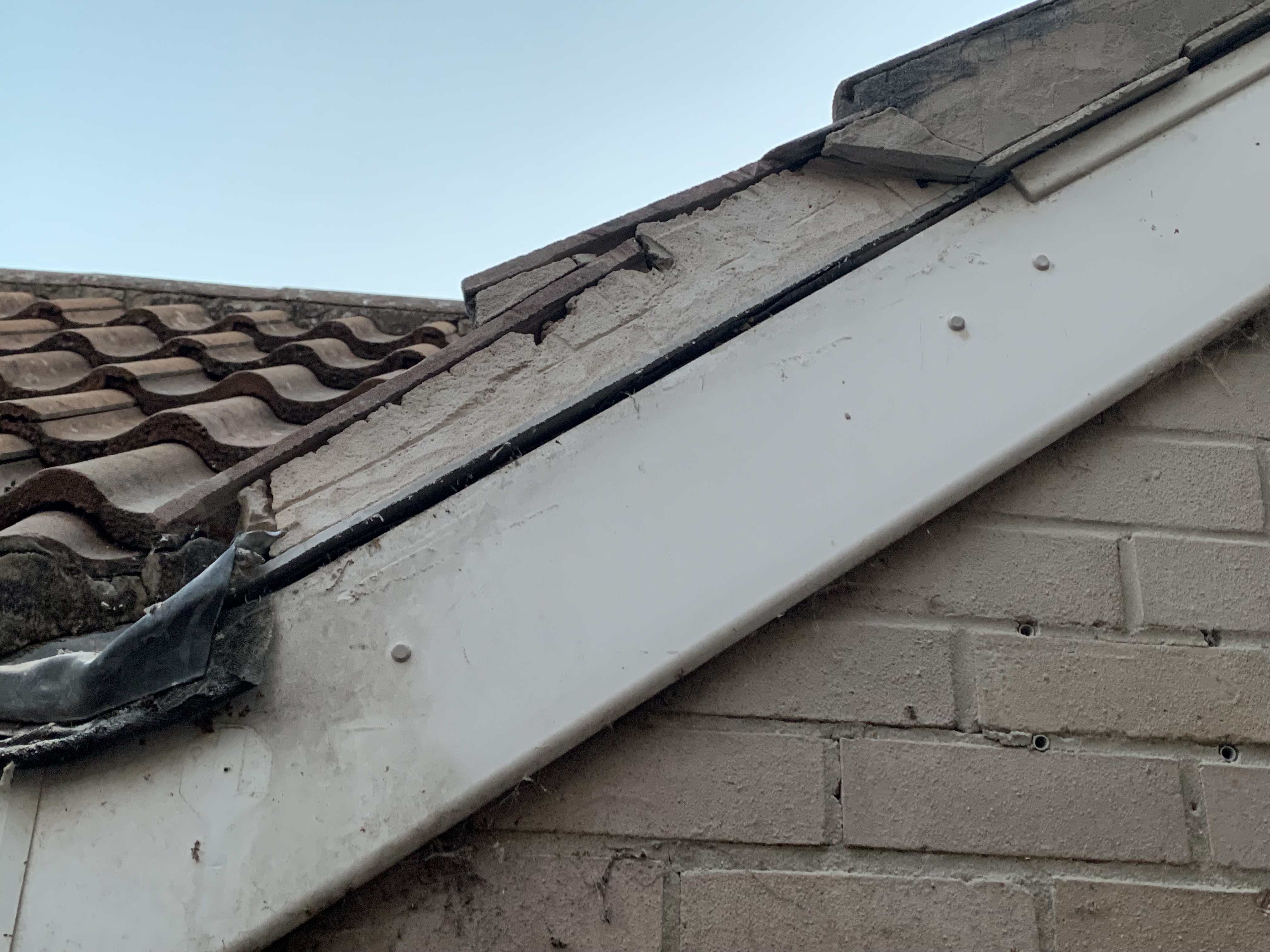

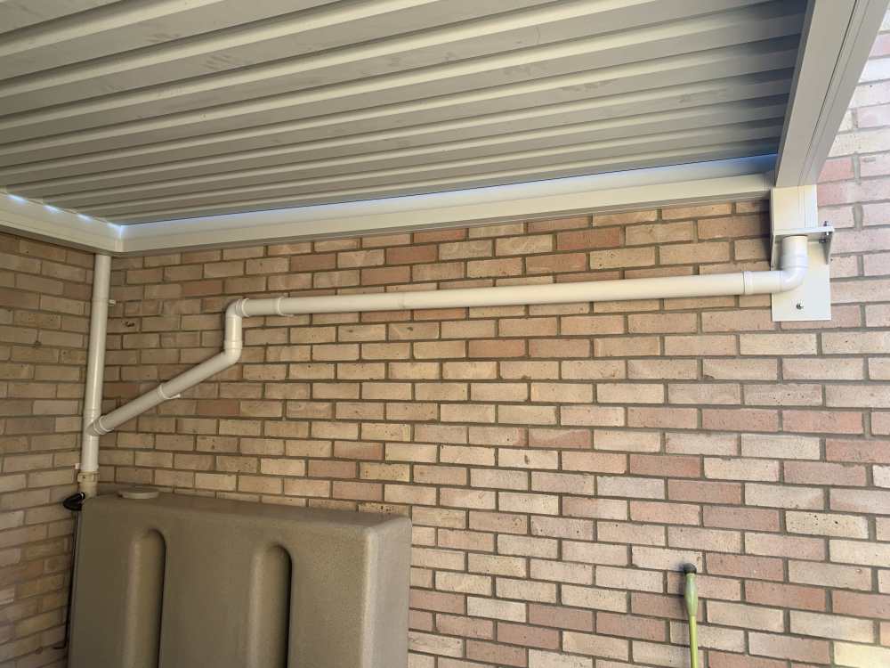

marshian Posted September 1, 2025 Author Posted September 1, 2025 Had to remove the fascia on the garage and re do that - wasn't happy with the previous job (not done by me I hasten to add) and it hadn't held up well The length of fascia sloped from old part of the garage to new part and it looked bloody odd and the gutter supports were all over the place - add to this the Gutter was above the slope at one end and below the other and tiles overhung 50% of the gutter width Library Picture from a few yeas back Refitted the gutters with better fall, neater support bracket spacing and I can now clean the gutters out without losing skin off the back of my hands Water drainage on the house side is done now - Not the prettiest set up but I had to work round the Y I needed to introduce as well as the rain water harvesting in the down pipe and the tank. I tested it with a 10 litre watering can and it coped absolutely fine , no leaks or drips. Just got to replace the fascia on the original part of the garage that no longer meets the adjusted main fascia with the gutters refitted (it's too short). No new pics cos it was dark by the time I finished I'll add them in tomorrow

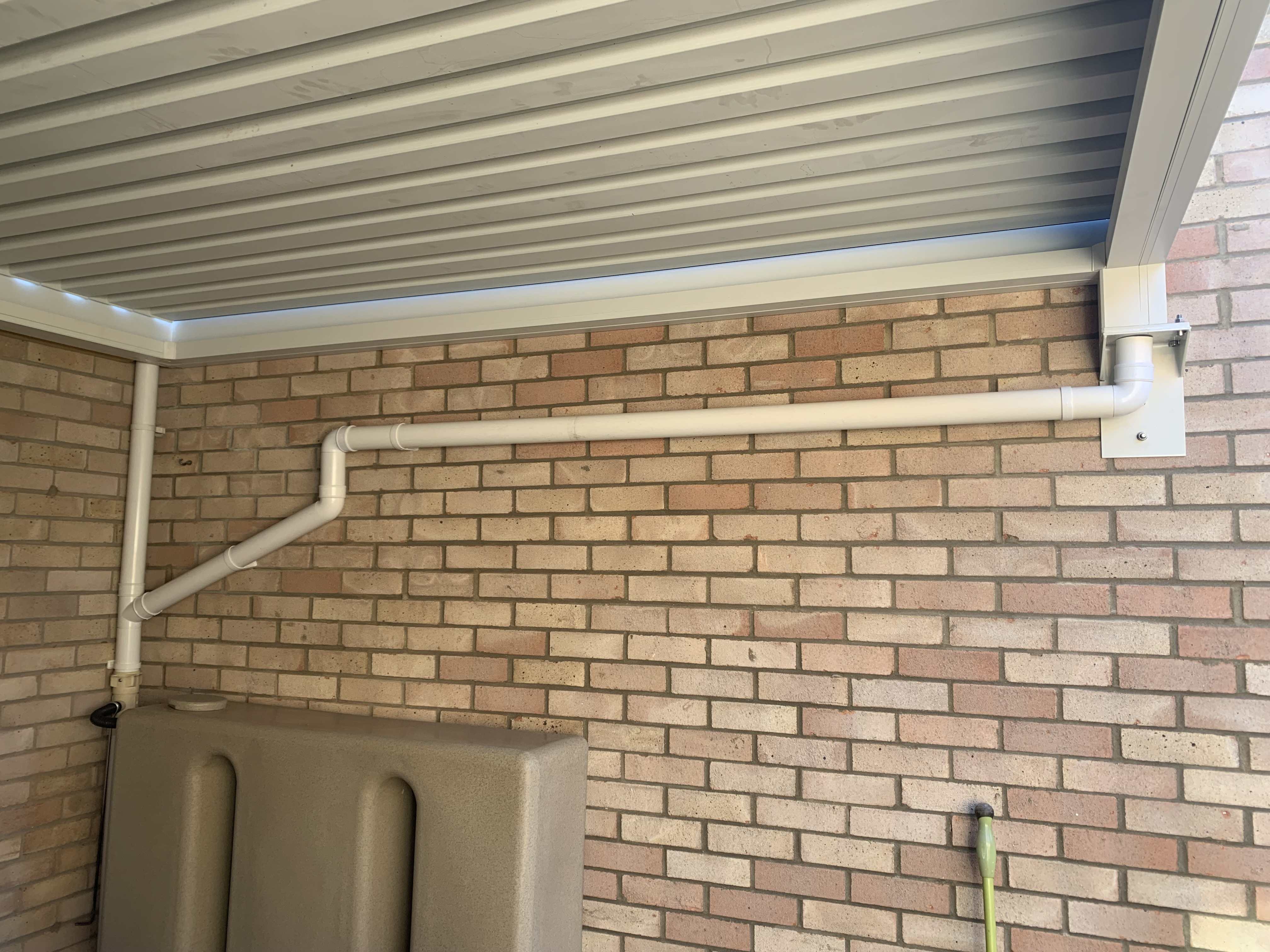

marshian Posted September 2, 2025 Author Posted September 2, 2025 Remodelled Gutter and Fascia (House side) Pergola Drainage would have been nice to have one length at the same angle but the pipe would have to run behind the 350 Litre water butt and I wouldn’t be able to harvest the rain water 1
