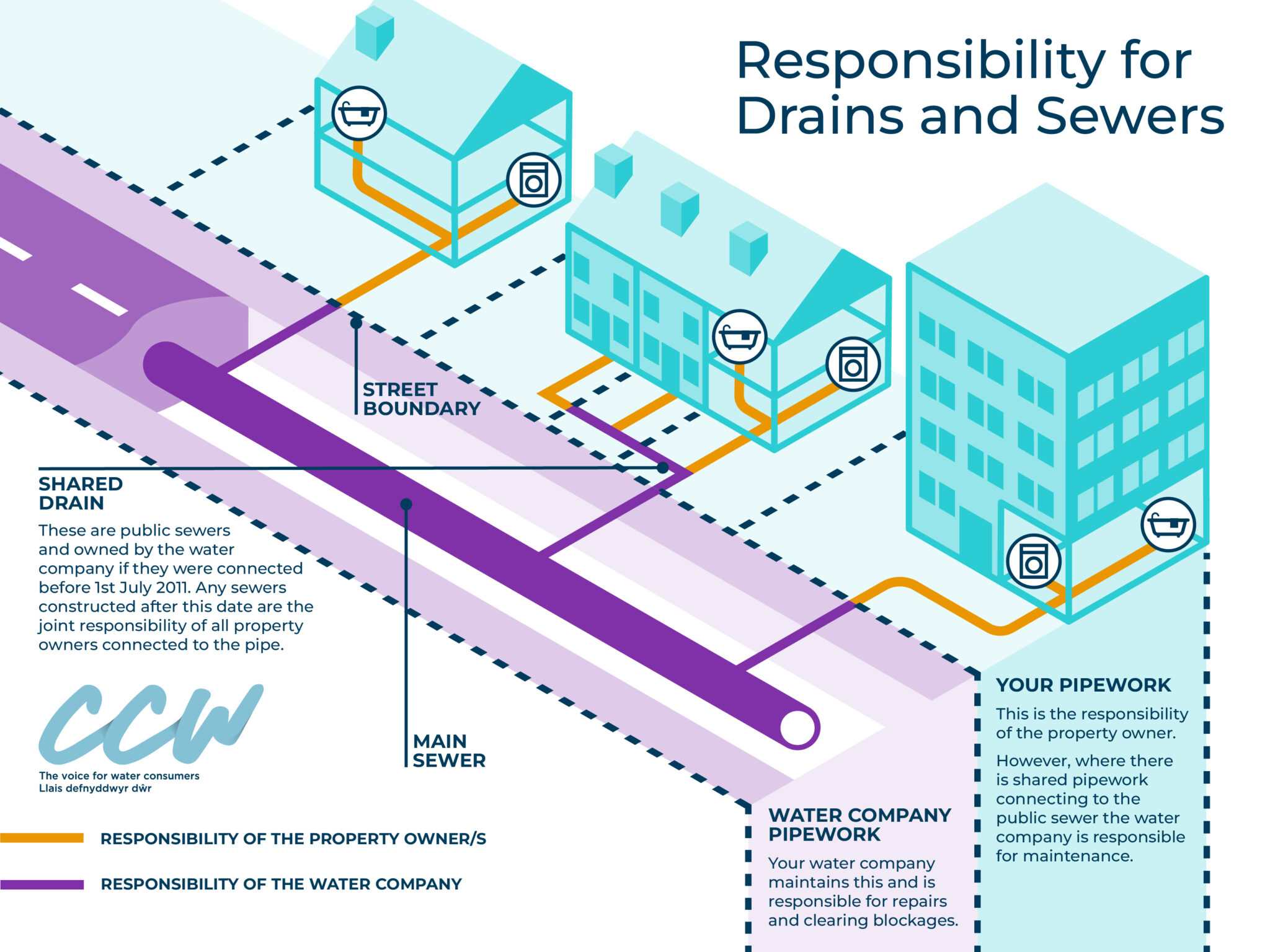

I believe the water co is now responsible for "shared drains". In this case the bit from the inspection chamber to the main sewer and from the Inspection chamber to your neighbours fence.
However some sites like this one in Wales says this only applies to sewers connected before 1st July 2011..
https://www.ccw.org.uk/faq/who-is-responsible-for-my-drains-or-sewers/
Drain-or-sewer-pipe-responsibility-2048x1536.thumb.jpg.4e5911ecaa4ff09a43e63279f27518c0.jpg

Hi in a simple way we did. the sewer from next door runs across our land and joins ours so in my understanding thet then becomes a public sewer. We obtained verbal permission from the owners to cross approximately 4 meters and connect into the Main Sewer which was all done with permission from the Water Authority and the Council. The connection has been inspected and passed by them too.

Thanks for all the replies. I have learnt that there was a cut-off date for Water Companies to become owners of Sewer pipes not the news I was hoping for but at least it has cleared the position up Thanks all!
