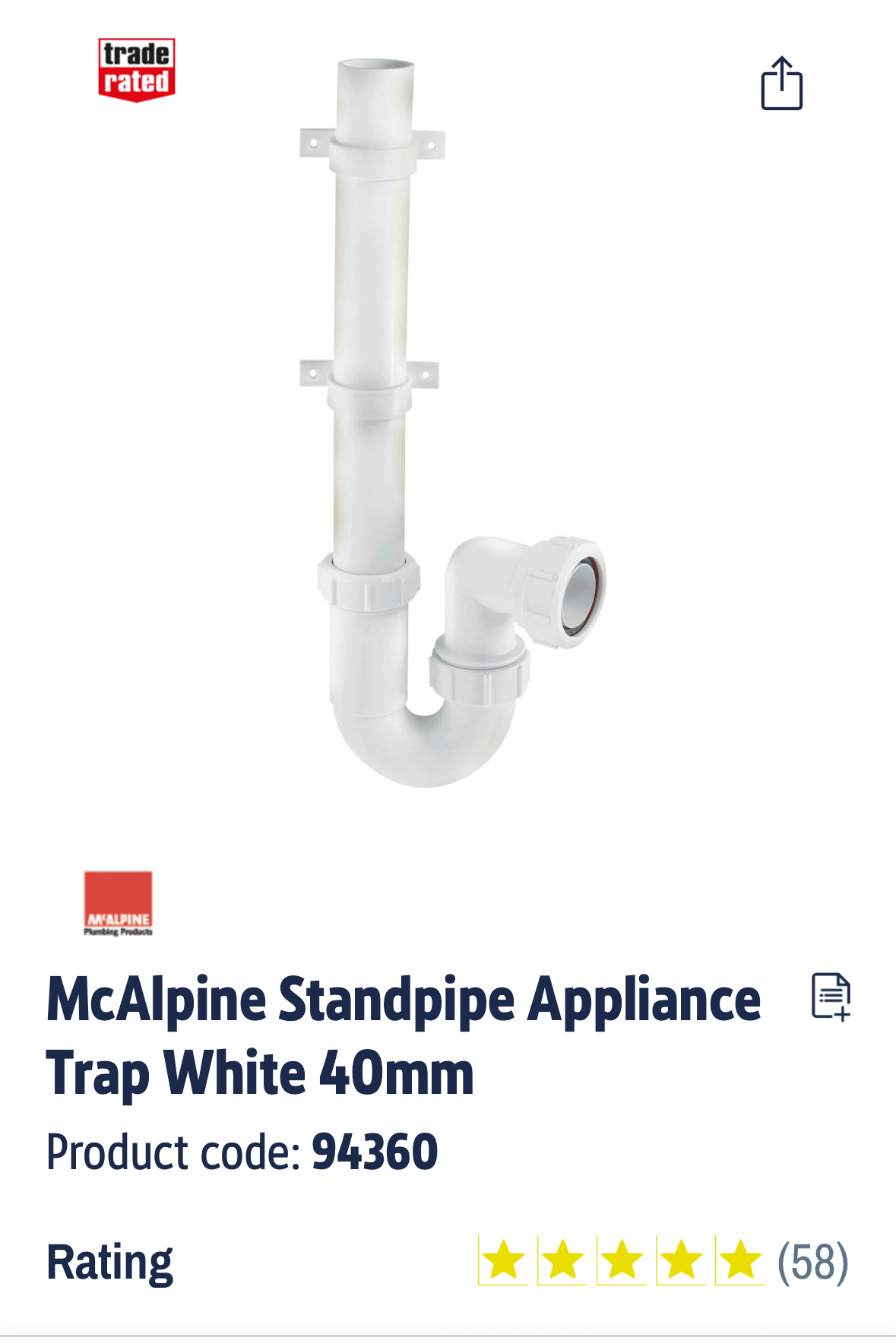

PLEASE, T off the waste pipe and install a washing machine trap, and connect the appliance(s) via one of those:

I hadn't even thought of the dishwasher slurps and noises that would be heard using a "stubby" pre-trap connection, so I'm pleased you pointed that out.  I'm good with the idea of using a standpipe for the dishwasher, but I'm confused as to how and where the sink waste and standpipe would connect, especially given their different heights.  Are you able to explain please?
Also, what height does the standpipe need to be relative to the appliance and/or sink?  is there a minimum or maximum?

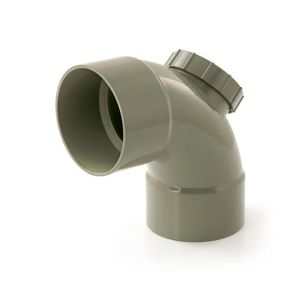

You can get bends with access..
solvent-weld-double-socket-access-bend-921-2-x-110mm-olive-grey-24966_24966_p_1_1.jpg.8cb8bb6151e85400834607fe1c68f04a.jpg

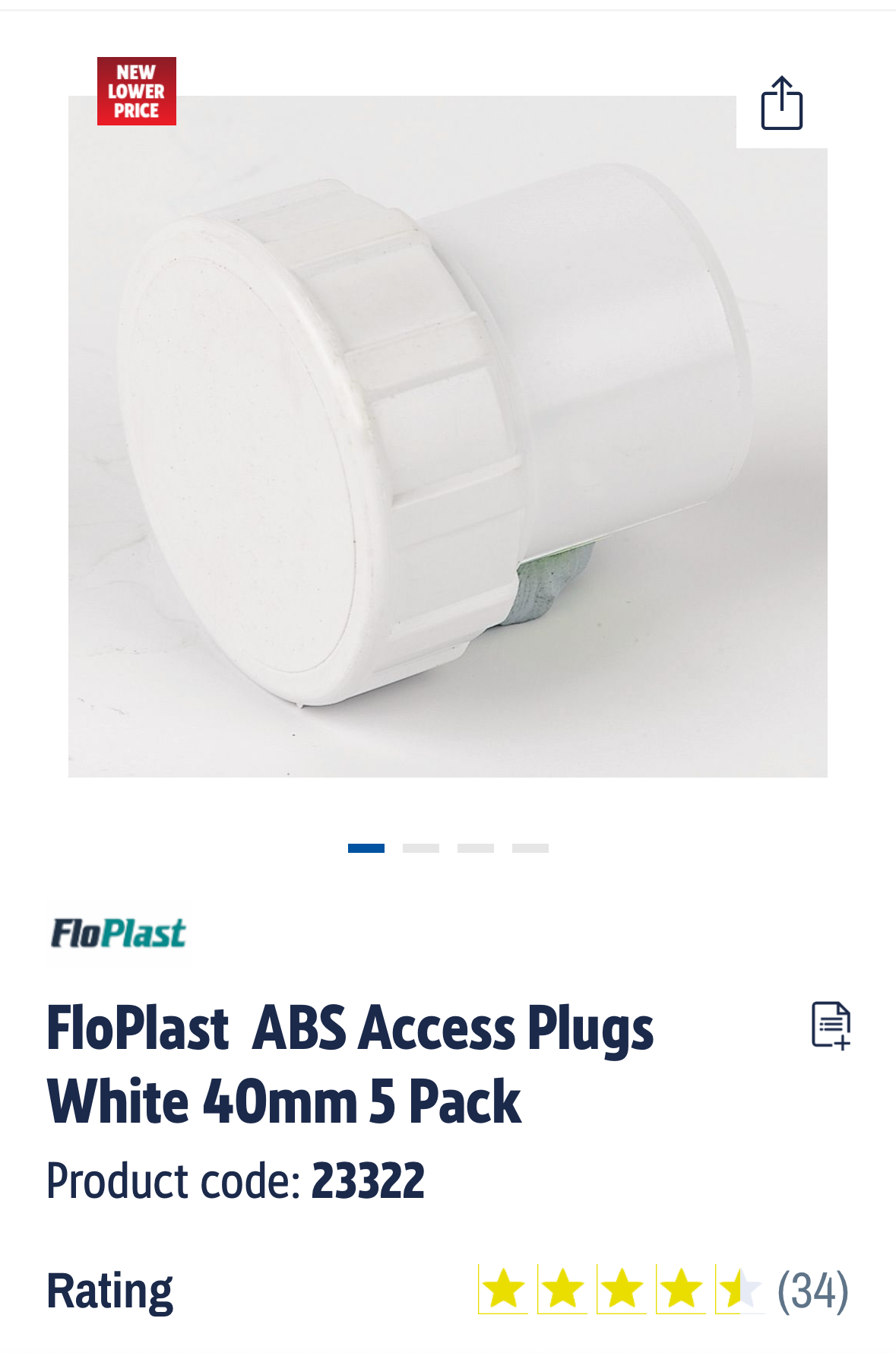

or make a bigger access out of a Tee and screw cap..
images(5).jpeg.f8ba80740e642395a0200070afd19036.jpeg and  download(2).jpeg.814eb586e9003c0dad078775663793fa.jpeg

Typically you set the top of the dishwasher stand pipe as high as you can under a worktop allowing room between the under side of the worktop and downpipe to hook the washer hose in the top. Then run a horizontal pipe from the bottom of the stand pipe along the wall to the outside with the appropriate fall.
Somewhere along that pipe you insert an upside down T and vertical pipe for the sink. Normally the trap for the sink is close up under the sink.

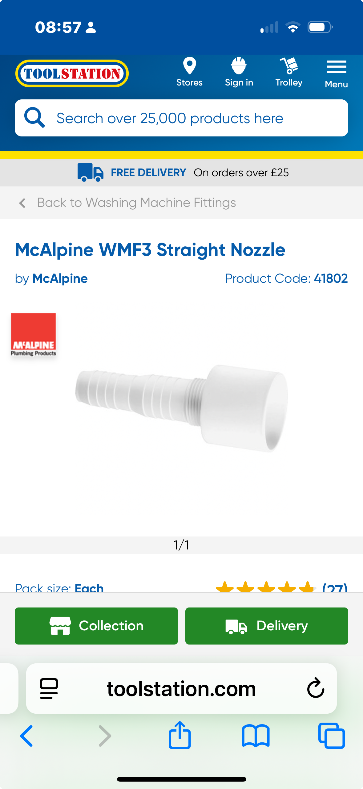

Nope. Open end of the upstand needs to be a minimum of 3/4 of the height of the appliance iirc, but as an ‘upgrade’ you can close off the connection to the upstand by fitting a compression 90° bend and one of these:
..which will close off the water from the room altogether.
I like this plan better than just stuffing a waste pipe down a vertical pipe.  Thank you. I wouldn’t have thought of doing that even though I’ve used these things to connect wastes before.
