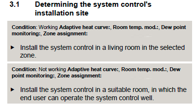

sharpener Posted Thursday at 21:27 Posted Thursday at 21:27 Nothing about height, this is the full extent of the MIs on the subject: I suppose the accessibility guidance would be the same as a light switch but I do not have my IEE On-site Guide to hand. More important is to site it in a sensible room. Hallway is not always a good choice, it may be draughty or unrepresentative of the rooms you are actually trying to heat. There is an offset adjustment which may help circumvent this. If like me you are not using it to sense room temp and just rely on the WC then it may be more convenient to put it with all the other controls in the plant room. Often I have seen pix where it has been installed in the airing cupboard where it is neither use nor ornament.

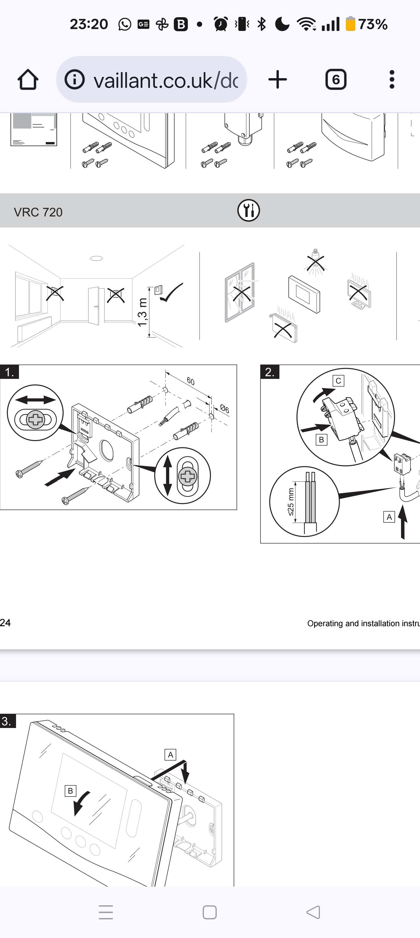

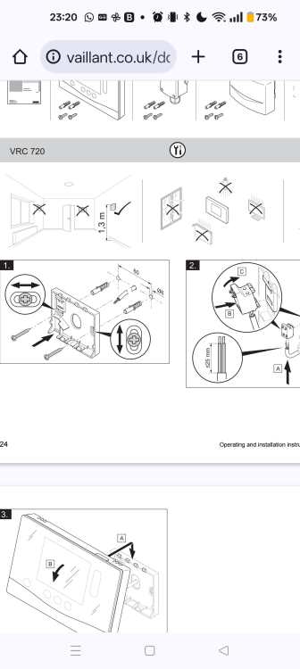

JohnMo Posted Saturday at 22:21 Posted Saturday at 22:21 On 29/05/2025 at 20:04, JohnMo said: The instructions will tell you the height to mount it. Just follow the instructions? Quick search and it's 1.3m above the floor. Middle image.
