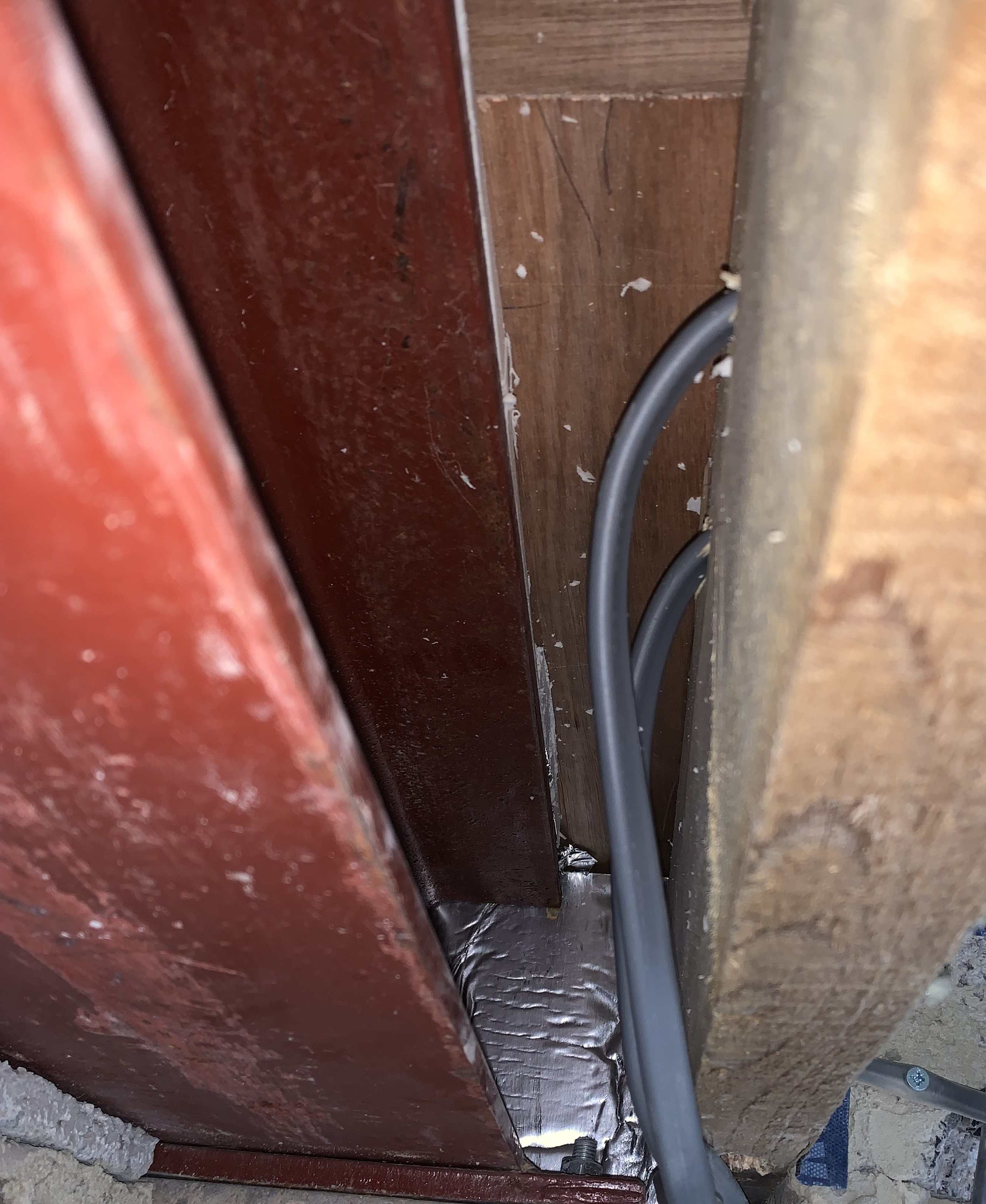

Spinny Posted Monday at 17:51 Posted Monday at 17:51 Looking to prepare the junction between walls and ceiling structure ready for plaster boarding. How should I be finishing this area adjacent to the steel ? The silver PIR insulation across the end of the steel is the top of the cavity insulation in the wall. I am thinking somehow I need to seal it so that warm air in the ceiling doesn't contact any cold air squeezing through the top of the PIR where it meets the plywood deck. Thinking I should somehow put some more insulation around the steel and the top of the inner leaf it sits on ? (Have rockwool but that wouldn't be vapour/air tight)
Nickfromwales Posted Monday at 18:57 Posted Monday at 18:57 You could use Illbruck fm330 (closed cell) foam. That's airtight and won't bridge damp / moisture, plus will help insulate the beam. I think just stopping airflow through there would be suffice, so the foam should be a good option imho. 1
Spinny Posted Tuesday at 11:27 Author Posted Tuesday at 11:27 Thanks Nick, looks like good stuff although not on the high street it seems. But how do you use it for ceilings though when the can has to be inverted ?
Redbeard Posted Tuesday at 12:56 Posted Tuesday at 12:56 1 hour ago, Spinny said: But how do you use it for ceilings though when the can has to be inverted ? You *may* get away with using an extension tube (flexible brewer's/wine-maker' tube is what I have used. I say *may* because the extra length slows the flow and if the first 'hit' is not fast enough nothing sticks and you just end up with a foam floor. It has worked for me, and also it hasn't...
