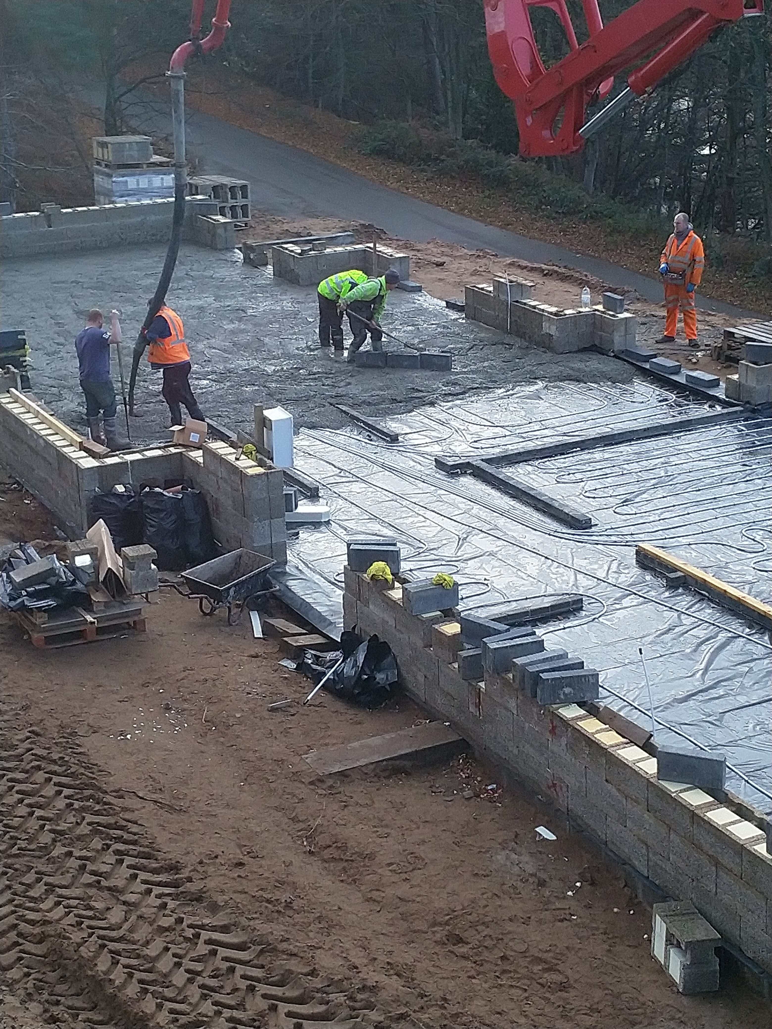

JohnMo Posted Monday at 10:45 Posted Monday at 10:45 9 minutes ago, marmic said: thank you - 75mm with fibre? Yep 9 minutes ago, marmic said: just sand i assume to get around pipes No, like this, insulation (PIR) polythene barrier sheet, UFH pipes clipped to insulation through polythene, then 75mm of concrete. Power float smooth. Just like this

nod Posted Monday at 12:38 Posted Monday at 12:38 1 hour ago, JohnMo said: Yep No, like this, insulation (PIR) polythene barrier sheet, UFH pipes clipped to insulation through polythene, then 75mm of concrete. Power float smooth. Just like this 1 hour ago, marmic said: maybe none of them listened then! frustrating as original intent was no screed with insulated precast 'slabs' ready for self leveller, but had to change as manufacturer moved the goalposts. But too late then to change the timber frame! That picture isn’t a screed I think your getting a bit confused
marmic Posted Monday at 12:57 Author Posted Monday at 12:57 18 minutes ago, nod said: That picture isn’t a screed I think your getting a bit confused no confusion! pls see earlier responses / comments!
JohnMo Posted Monday at 13:42 Posted Monday at 13:42 (edited) 1 hour ago, nod said: That picture isn’t a screed I think your getting a bit confused I wanted as the OP to do the screed before walls, so just used a normal concrete, it really doesn't care about the weather. For clarity we have zero screed, just concrete over the UFH pipes. My build-up is 200mm rebar concrete slab, then 200mm PIR, then as described further up thread. Edited Monday at 13:46 by JohnMo

JohnMo Posted Monday at 14:04 Posted Monday at 14:04 I just got my ground contractor to do it. Normal concrete lorry and in our case, but because of distance and access, we use a concrete pumping lorry also.
