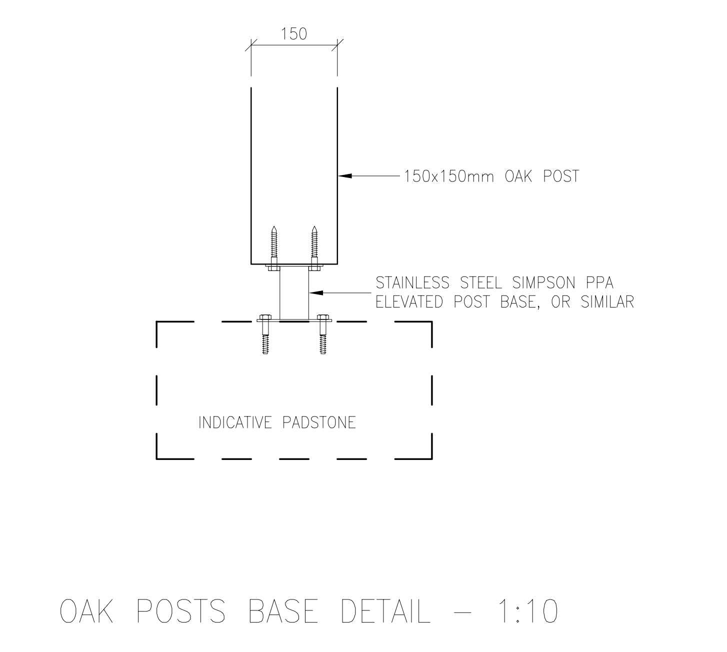

Benpointer Posted May 18, 2025 Posted May 18, 2025 Hi all, we have five 150mm x 150mm oak posts supporting roof overhangs in our single storey TF design. The TF designers have specified "Stainless Steel Simpson PPA elevated post base or similar" to fix the base of each post on concrete pads. I can only find galvanised steel Simpson PPA post bases online, which I guess might well see us out but it seems a shame to install something that will rot before the posts do. Does anyone know where I can get s/s oak post bases? (In a previous project I screwed in 4x 20mm s/s studs into the bottom of each post and concreted them into the pads, leaving a gap of about 25mm between the base of the post and the top of the pad, so I guess that's another option.) Pics attached:
Redbeard Posted May 18, 2025 Posted May 18, 2025 (edited) Get them made to your Structural Engineer's own design. Yes, not every steel fabricator will do stainless, but some will. Edited May 18, 2025 by Redbeard Added 'structural engineer's...'

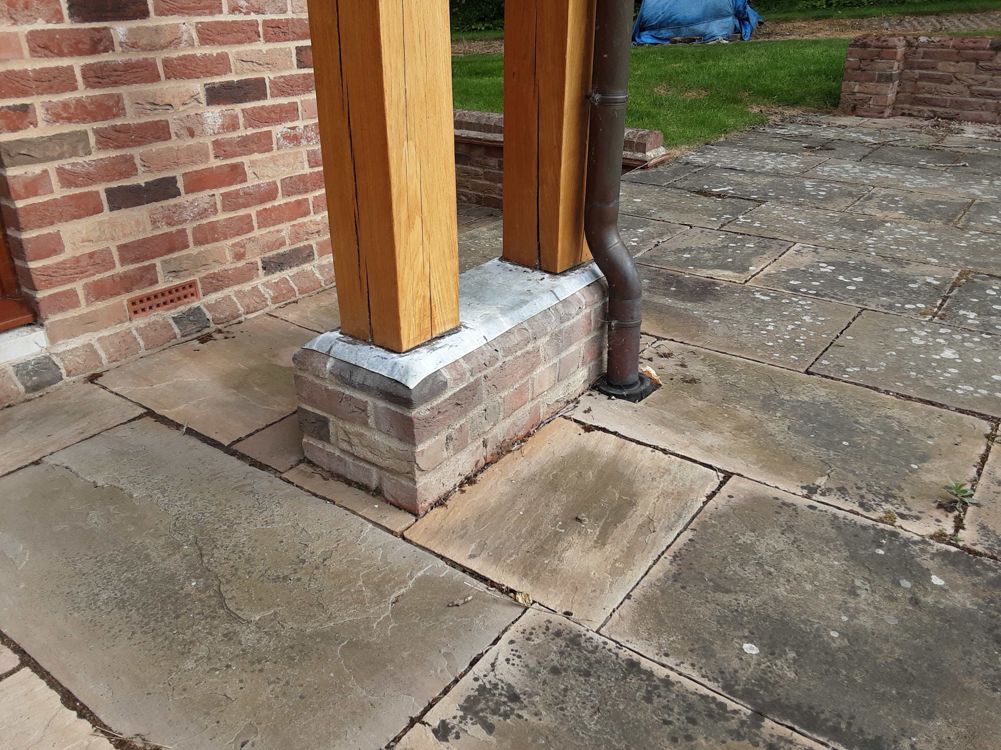

Temp Posted May 18, 2025 Posted May 18, 2025 Range of different SS bases here... https://www.speedyfixings.com/post-supports/adjustable-elevated-post-bases/ We opted for brick base, with a 22mm SS locating pin... 1
