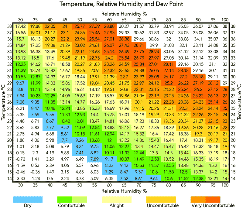

My worry is in the upper floors where pipework runs in a joisted floor. I’m not sure what the air temp might reach because of the larger space, air tightness and increased insulation but unless I’ve misunderstood, the table below indicates that my current room in roof dew point in summer at 40 % rh and reaches 35 degrees quite regularly, the dew point is just above 19 degrees.
How would I manage the flow temp to ensure it runs above the dew point for the relative RH?

If running pipes through your loft they should be insulated anyway. Pipe insulation is generally closed cell, so pipe isn't affected.
We are 50% humidity inside, the area of the UFH manifold is about 20 degs. So the dew point (from you chart) is 9.25 degs. So min flow temp is 3 degs away from there. Floor is a good margin off dew point, no matter what the house temperature. So no issues with UFH. If in doubt insulate pipes (they should be for cooling anyway).

So here if the surface temp of the floor was say 30 degrees and the RH within the house was 50% the dew point would be around 18.5 degrees meaning the flow temp of the water in the upper floor area would need to be above that because the UFH pipework isn’t insulated.
Or am I missing something?

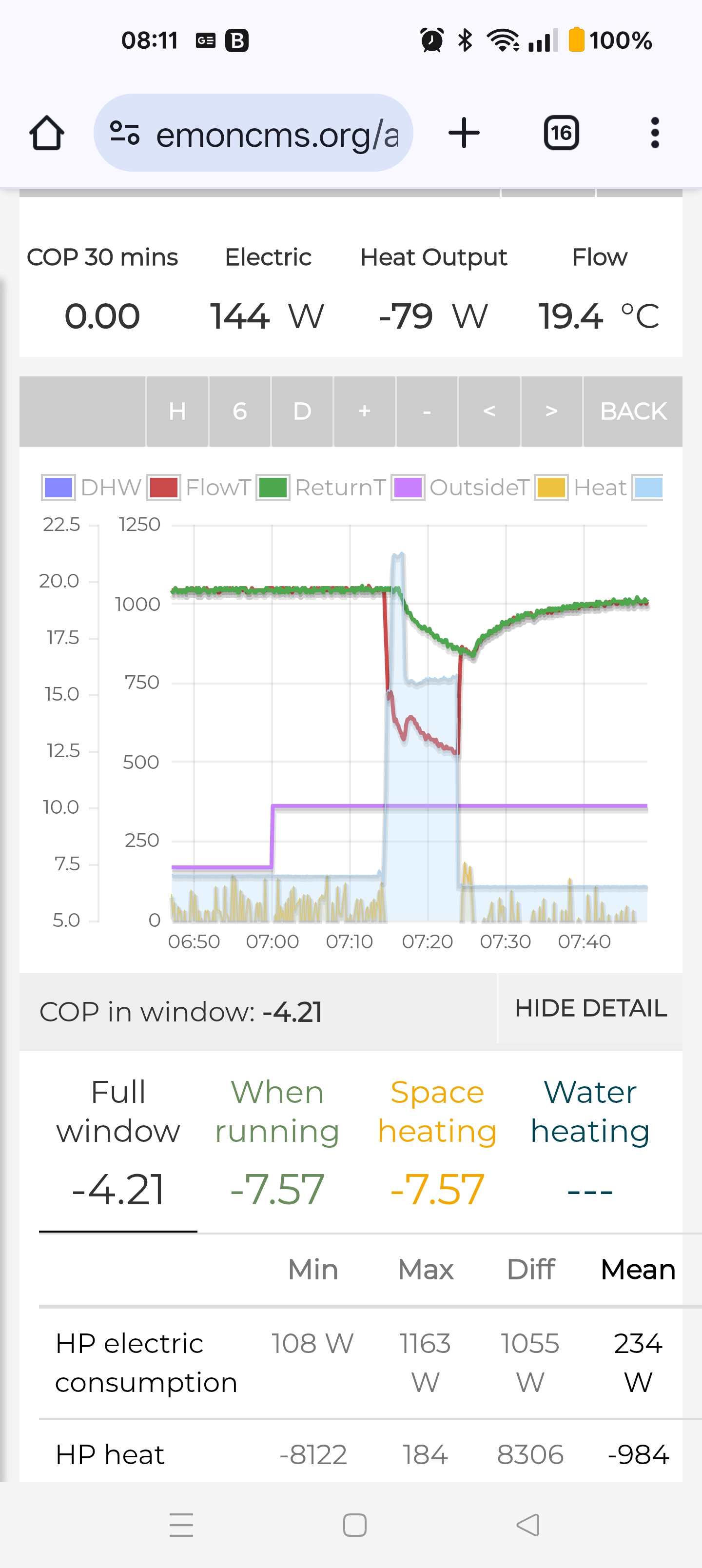

I think set point depends on how the ASHP controller handles hysterisis. Plus what temperature it really brings the floor down to.
Mine doesn't really run for long generally in the 10 to 15 mins range and then off from 10 mins to 4 or 5 hours. Really depends on what the sun is doing and ambient temperature. This is the last cycle. As you will see (red line) it's not spending any time at a cold temperature.
Screenshot_2025-05-13-08-11-51-50_40deb401b9ffe8e1df2f1cc5ba480b12.thumb.jpg.d88cda0a40236aba6bc23608525cb119.jpg
Set point will depend on how your ASHP responds, if runs for hours on end, 16 degs may be better set point

of the floor was say 30 degrees and the RH within the house was 50% the dew pond would be around 18.5 degrees meaning the flow temp of the water in the upper floor area would need to be above that because the UFH pipework isn’t insulated.
I would say you are missing something. You treat cooling the same as heating - low and slow. Set it on weather compensation. So it's always ticking away. Then you never ever hit 30 degs. Most the time the house is 20 to 22. If you get loads of solar gain you may get short excursions slightly higher. But you shouldn't be in the 30s.
So you are looking at a dew point of 12 or below.

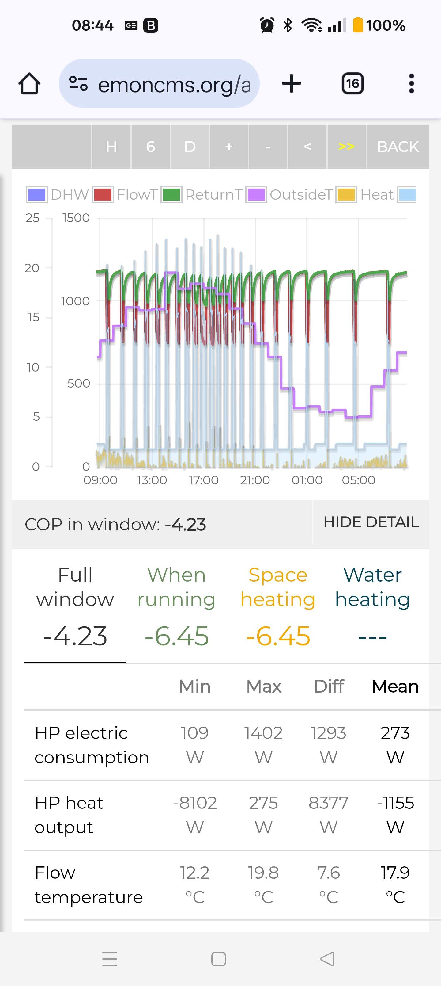

I've just taken a wider view of the ASHP operation so over 24 hrs.
The mean flow temperature is 17.9 Deg. So pretty high really.
