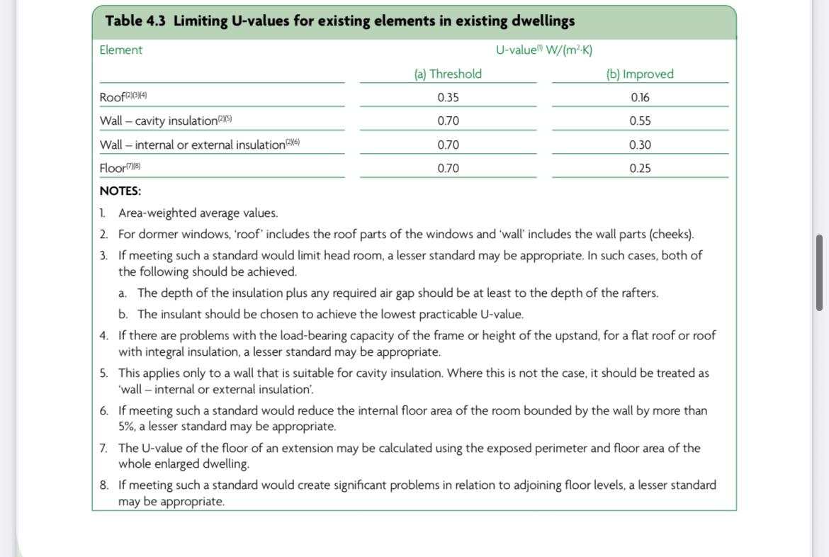

You will only need a U-Value of 0.25W/m2K and in any case if it causes problems with adjoining floor levels you can use less.

Thank you for this information, that is absolutely huge news for my project. Please could you link me to the specific regs on this? Thank you!
Sorry I see now that image below your post was the regs I require, I’ll have a delve into them when I can. At first glance it would be this table for a garage conversion?
This has some pretty huge implications for my build as the current architect design is to meet 0.18 in the walls and floor.
