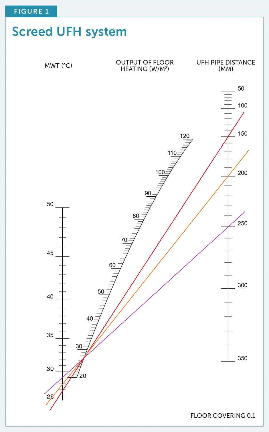

  2. I've read that I should try to achieve UFH pipe centres as close as possible to minimise flow temps. How do I calculate whether 150mm or 200mm is appropriate?
Closer pipe centres do reduce flow temperature to a certain point, but you will always have a minimum flow temperature acceptable to the heat pump.
So heat output will be 3550÷132, so average output is 27W/m².
Simple graph that shows UFH output, just draw a straight line pipe centres and 27W/m² and project to mean flow temp. Mean flow temp is the average of flow and return temperature. So a flow of 30 return of 26 would be a mean of 28.
Once I know the individual heat loss for each room I can then use the graph to determine pipe spacing for various mean flow temps and I need to make sure that I don't go below the min flow temp of the ASHP. e.g

5.      With these heat loss figures I then calculated the required UFH spacing for each room using the graph that @JohnMo posted earlier. I assumed a Mean Water Temp of 30 degrees. The 2 outliers were the Utility room and the snug. The Utility room has a small useable floor area for UFH so needs tighter spacing. The Snug is a bit odd - and might need another look, but am assuming that the wider spacing is down to the relatively large useable floor area and the fact that there is only 1 small window.

If you feel the utility needs heat, do at 150mm the rest I would do at 200mm and fine tune flow rates when you see how it all settles out.
