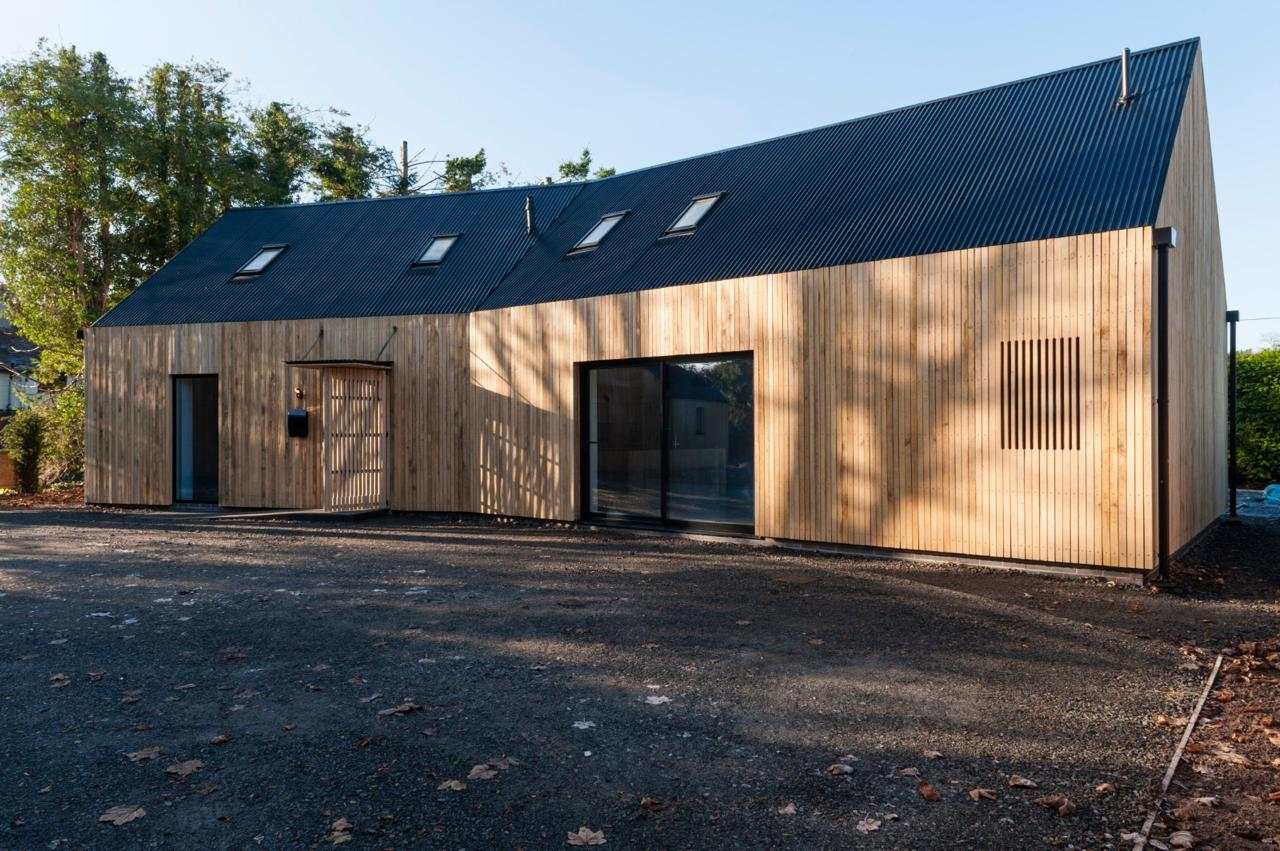

Bramco Posted April 29 Posted April 29 @Great_scot_selfbuild We have black corrugated roofs and walls to the 2 storey section of the house - images here -> https://lhc.net/projects/ashcroft-creating-a-low-energy-family-home/ Our son was the architect and specced the tin. From memory it has at least a 45 year guarantee - I think it was Firth steels. We used a company in Leominster to do the actual supply - Thomas Panels and Profiles. They suggested a contractor to do the actual build but we sacked him off half way through and our main contractor finished things off. fastenings were EJOT. I can get more detail if you need it. We found it hard to find examples to go and see in real life - there's probably more around now. You're a long way away in Surrey but you're always welcome if you are up our way to have a look at ours. 1

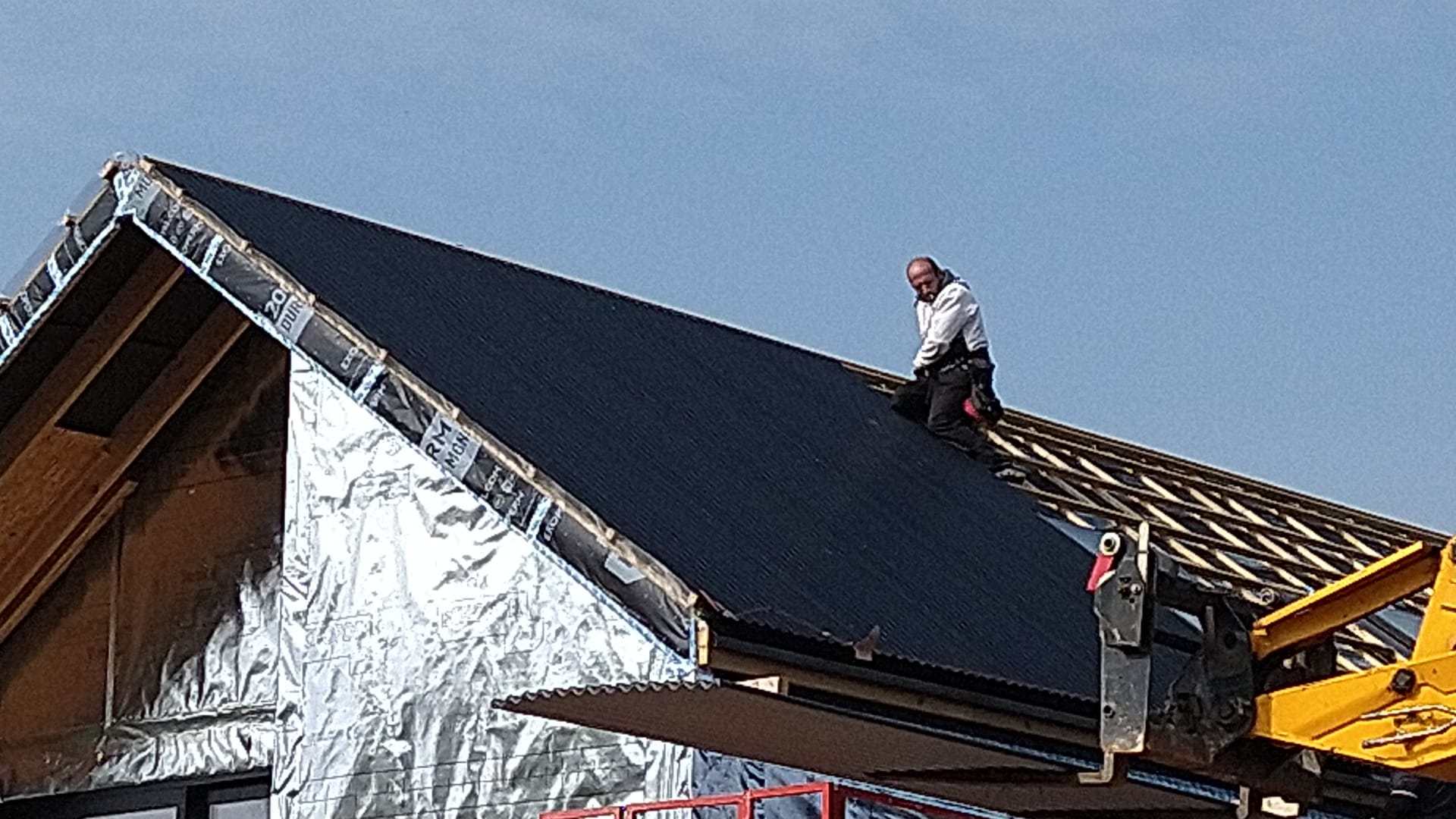

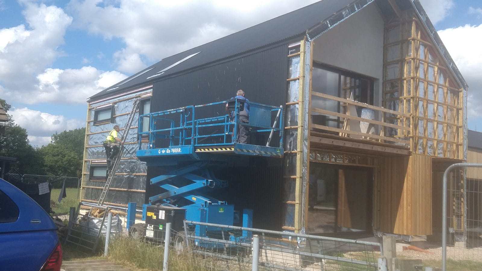

Great_scot_selfbuild Posted May 5 Author Posted May 5 On 29/04/2025 at 14:43, Bramco said: @Great_scot_selfbuild We have black corrugated roofs and walls to the 2 storey section of the house - images here -> https://lhc.net/projects/ashcroft-creating-a-low-energy-family-home/ Our son was the architect and specced the tin. From memory it has at least a 45 year guarantee - I think it was Firth steels. We used a company in Leominster to do the actual supply - Thomas Panels and Profiles. They suggested a contractor to do the actual build but we sacked him off half way through and our main contractor finished things off. fastenings were EJOT. I can get more detail if you need it. We found it hard to find examples to go and see in real life - there's probably more around now. You're a long way away in Surrey but you're always welcome if you are up our way to have a look at ours. @Bramco Thanks for the response and link - would certainly like more details please. In particular, I'd like to know what goes underneath the corrugated material (any photo of the build-up?).

Bramco Posted May 5 Posted May 5 1 hour ago, Great_scot_selfbuild said: n particular, I'd like to know what goes underneath the corrugated material (any photo of the build-up?). @Great_scot_selfbuild here's a couple of photos - not great but they show the build up. 1

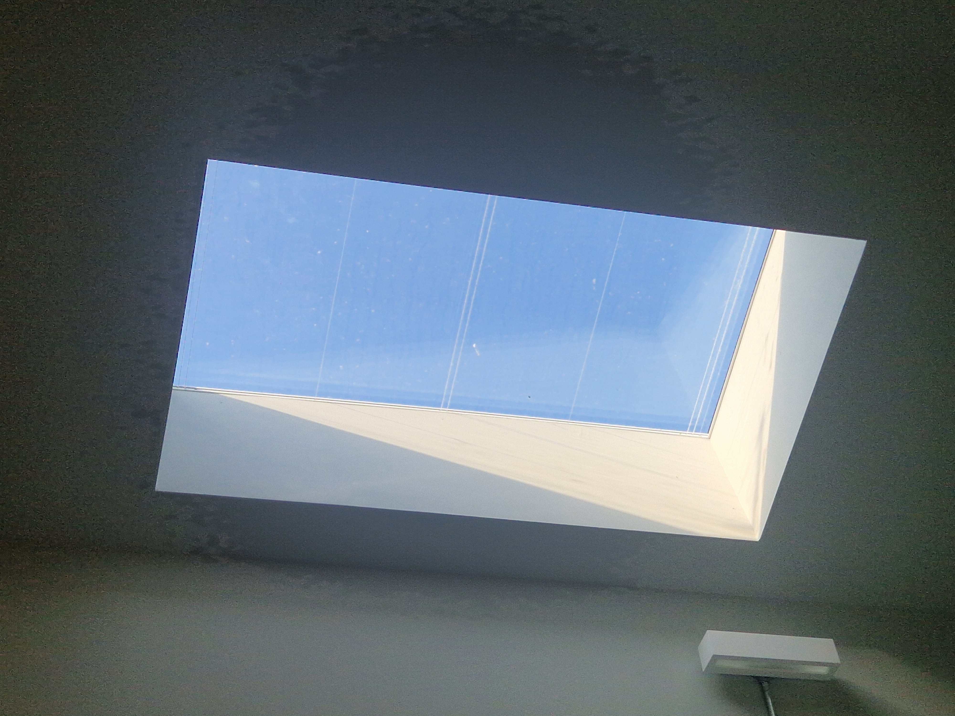

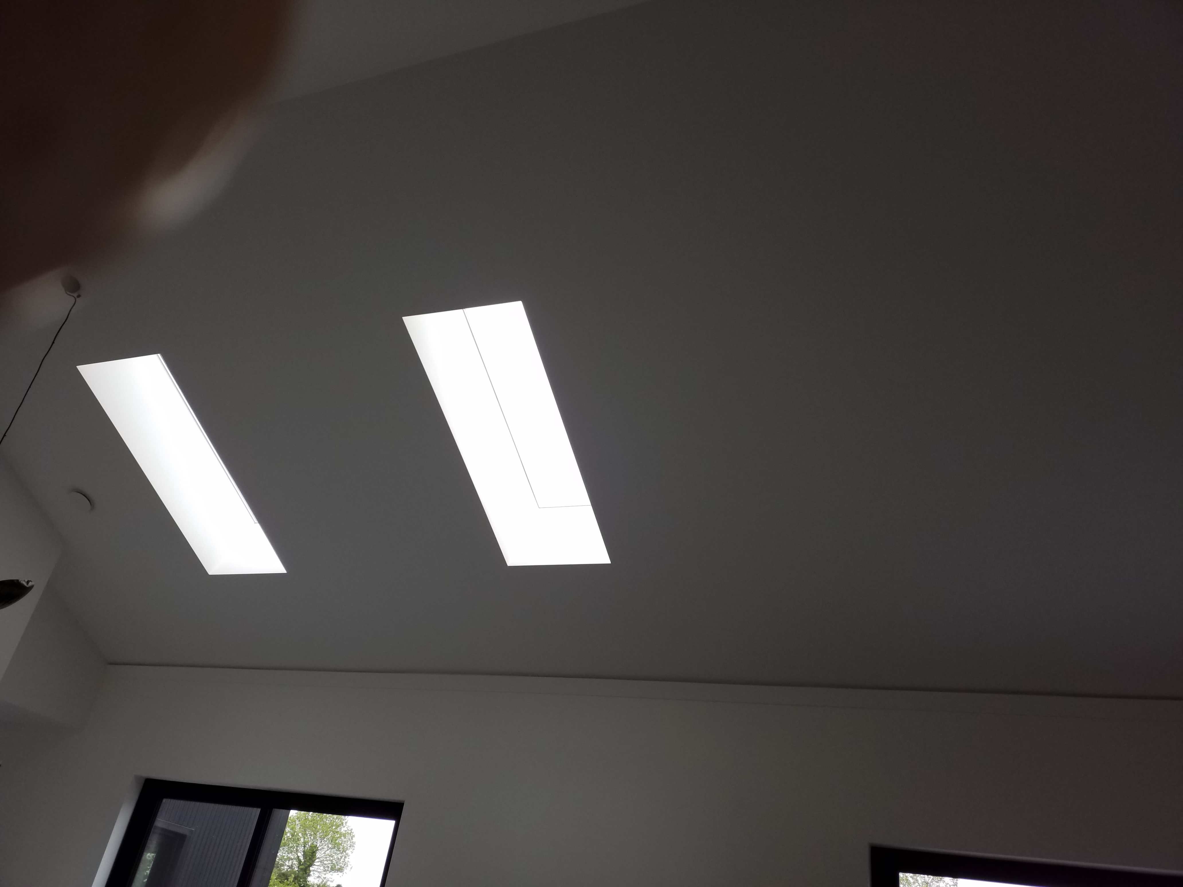

Bramco Posted May 8 Posted May 8 @Great_scot_selfbuild See the attached photo from inside. The Roofmaker roof lights have an internal lip that the plasterboard fits into, so it's a very clean look. We haven't got any blinds. The roof lights come with remotes but can also be hard wired to momentary switches for up and down. I think they've changed the controllers now. Ours are hefty black boxes, I think the new ones are integrated into their switches. They also do rain sensors. We only fitted one and ganged it to all of the roof lights. We also have one momentary switch in the hall which we can use to put all the roof lights down. Again, this is ganged to all of them. 1 1

Great_scot_selfbuild Posted May 8 Author Posted May 8 @Bramco, @Tom, thank you. I filled in their quote form but they’ve come out far higher than the velux options I’m looking at (the roof light windows I’m needing are all within reach and aren’t needing the same sort of remote access control as yours). It turns out I had actually looked at this brand when we were looking for the fixed roof lights for our garage also.
