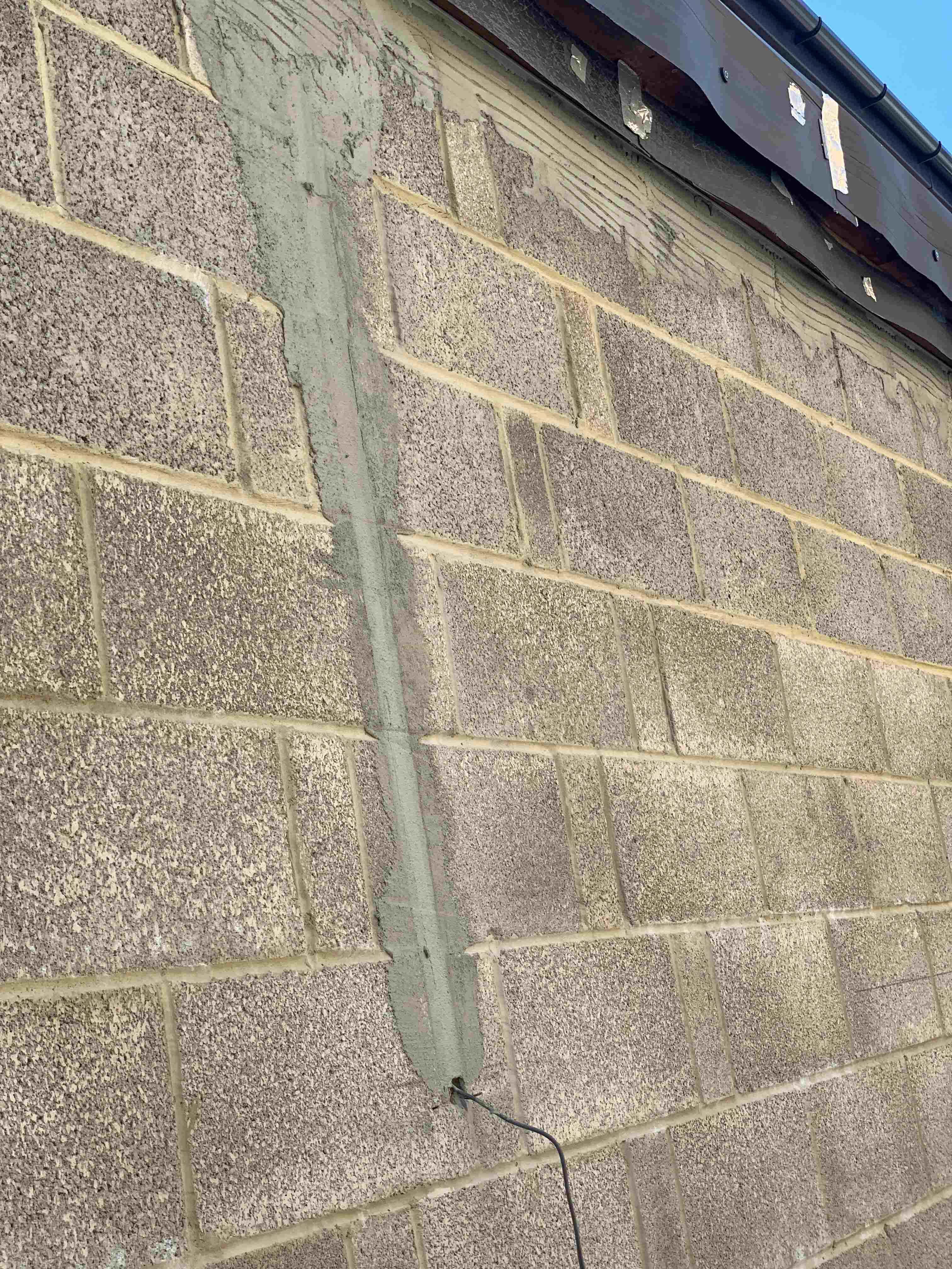

Spinny Posted April 20, 2025 Posted April 20, 2025 Am due to have k-rend on the outside of the extension. I have wires coming out through the blockwork in the right position for some outside wall up/down lights. Also wire coming through for an outside power socket. Also have one cable currently dangling down the outside of the wall which was put in for another outside light and taken through the wall at ceiling height to then run down the outside wall down to chest height. What should I do with the cables to prepare for the rendering ? Should I cap the one down the wall with something (metal or plastic) ? Unfortunately I cant pull all other wires back through because of their route and internal insulation. Will rendering around these wires cause a problem for a good finish ?

Spinny Posted April 30, 2025 Author Posted April 30, 2025 Renderer is here and has kindly routed out the blockwork, put the cable through some channel I had bought and mucked it into the wall to make ready for rendering over. (just thought I'd say what happened rather than leave open ended) 1
