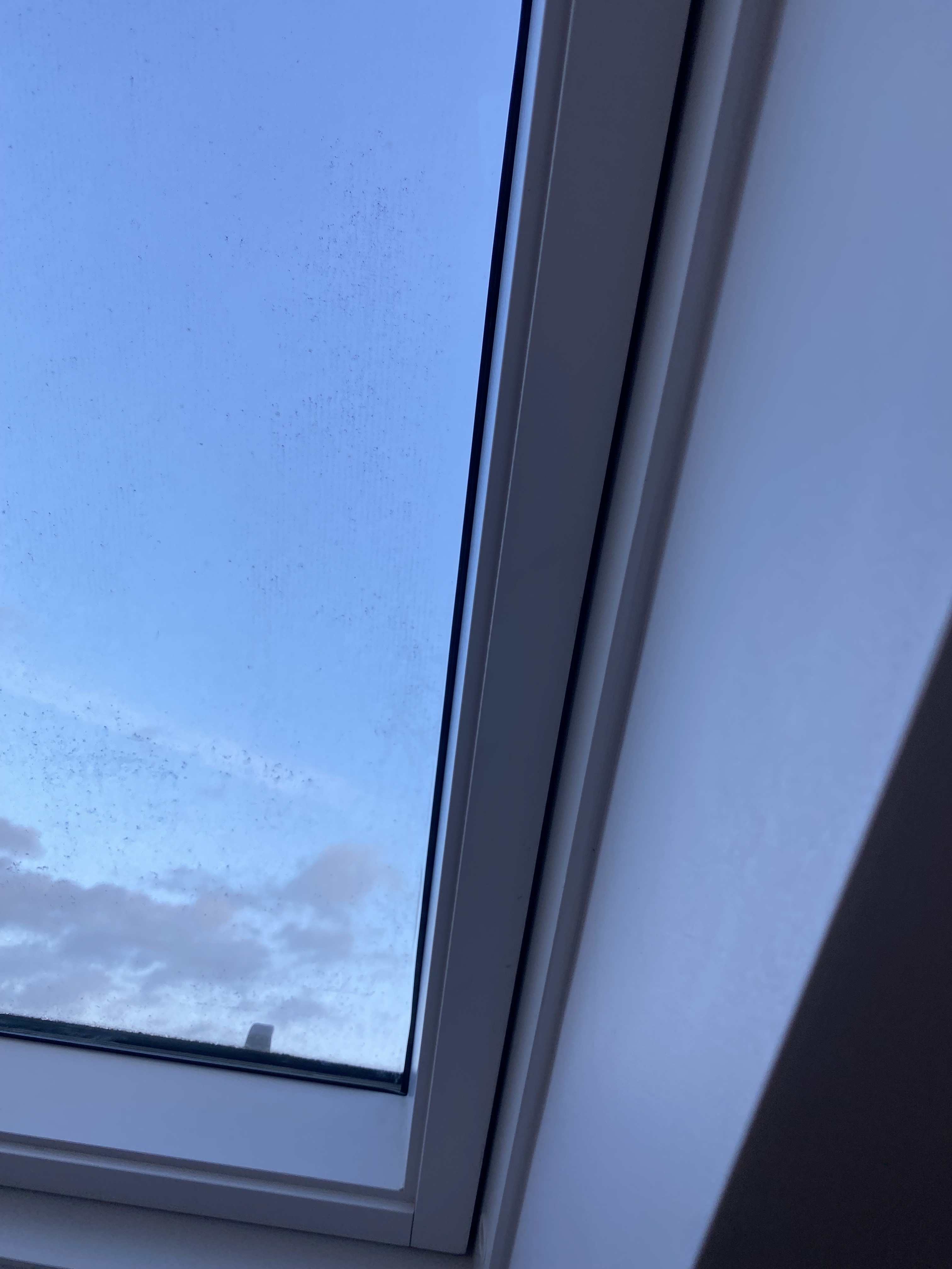

I suppose the alternative is to get new, triple-glazed Velux for the three southern-facing skylights, and move those three double-glazed Velux to create new skylights on the southern side, thereby giving me a nice view from my desk... but I'm starting to think that most people here are not friends of having lots of skylights.
Yes; the combination of glass panes makes a difference to the acoustic performance too; not all triple glazing is identical.
Also consider the structure of the hole that they sit in, which may also be a weak point.

Oh, I solved my first-floor noise problem (expensively!) by having a new set of sliding windows (heavy single glazing, high transparency) installed 15cm away from existing double-glazed windows (which had good specs, but were not top-of-the-line; the fake architect got in the way of that, unfortunately). So: outer set sliding sideways, inner set opening inwards.
But that's not what I meant! These are skylights, which open by tilting.
Aha? What do you mean? I can share pictures (and a plan) if that helps.
Posted (edited)
Then triple glazed with a spec focusing on sound insulation is likely your best option.
I mean that where the window meets the reveal your 180mm of insulation between inside and outside falls to very little; you're potentially relying mostly on the thickness & density of the plasterboard (unless the plasterboard is right up against a 180mm deep rafter):
Right, I've thought about that. Is there any solution to that? (In a future society, maybe windows would be surrounded by a layer of vacuum insulation, but I doubt a random insulation person who is trying to charge me twice what he should would agree to it.)

Well, around the windows, I can put as much cork as I want. The minimal spacing between windows is 10cm. Right now the insulation between pairs of windows close together is as thick as elsewhere (which is idiotic and not what was planned: it makes one hit one's head); I think 5cm should suffice, no?
