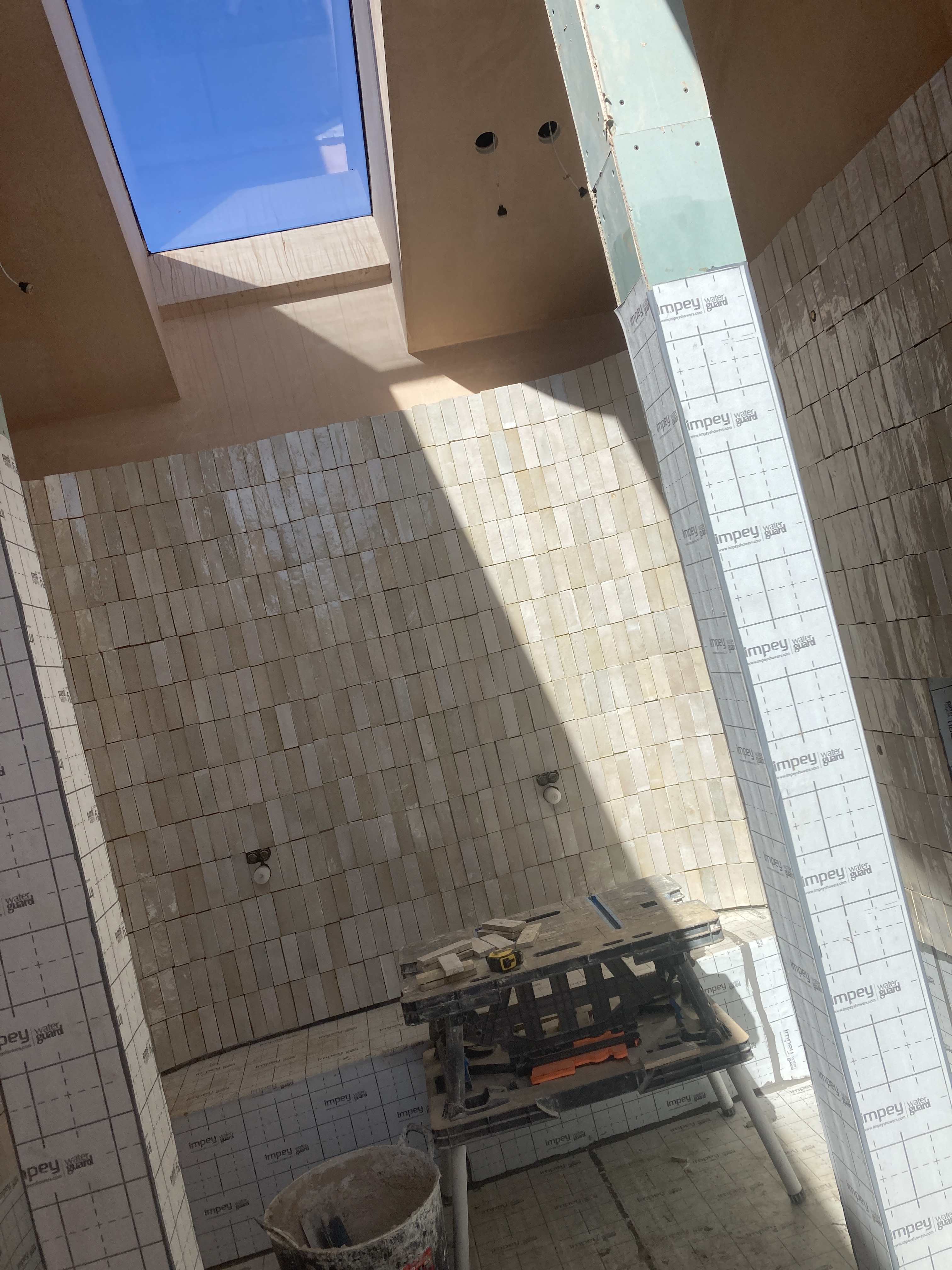

nod Posted April 1, 2025 Posted April 1, 2025 Just now, nod said: Why not just use plasterboard and tank the joints The majority of my jobs are PB Even wet rooms Todays job All plasterboard and tanked They have paid 270 m2 for just the tiles
