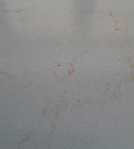

Colink Posted March 14 Posted March 14 A family member has had new manufactured quartz worktops installed 1 month ago. Worktop now has about 8 pinholes some the size of a pin head). See image and short video attached Is this to be expected and is an epoxy repair an acceptable solution or should they be demanding a new worktop? quartz-worktops-holes2.mp4
BotusBuild Posted March 14 Posted March 14 I know what I would be doing and it doesn't involve a repair of any kind. If the installer/manufacturer insists let them do it on the proviso that they fully understand that if the repairs are not satisfactory then a replacement will be installed instead.
