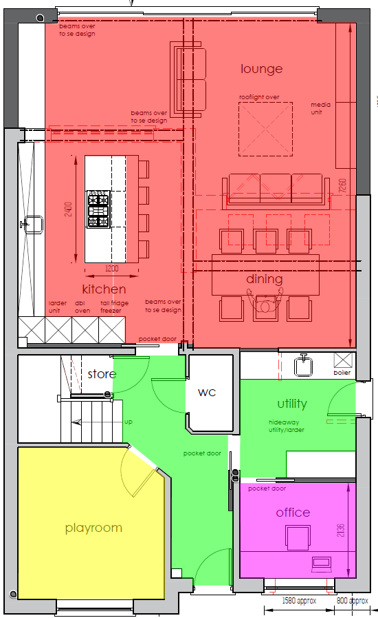

foundationsmcr Posted March 11, 2025 Posted March 11, 2025 Hi, for context I'm extending a property that was built in 2013 to current building regs. I'd like to install a wet UFH system running off our existing Combi boiler, and have ruled out digging down (cost and disruption - we have a small young family to consider!). Obviously I'd like to minimise the threshold increase in terms of floor build up as best I can. We are planning to finish the downstairs with LVT flooring. I'm lost with all the various options and suppliers, but need an estimate to build into our remortgage costs. How do I go about narrowing down the spec and cost quickly? What info do I need and how do I find it out to help secure an estimate. I understand our flooring is a concrete base, but I'm no builder and don't know where to start with this. Can anyone help? Many thanks

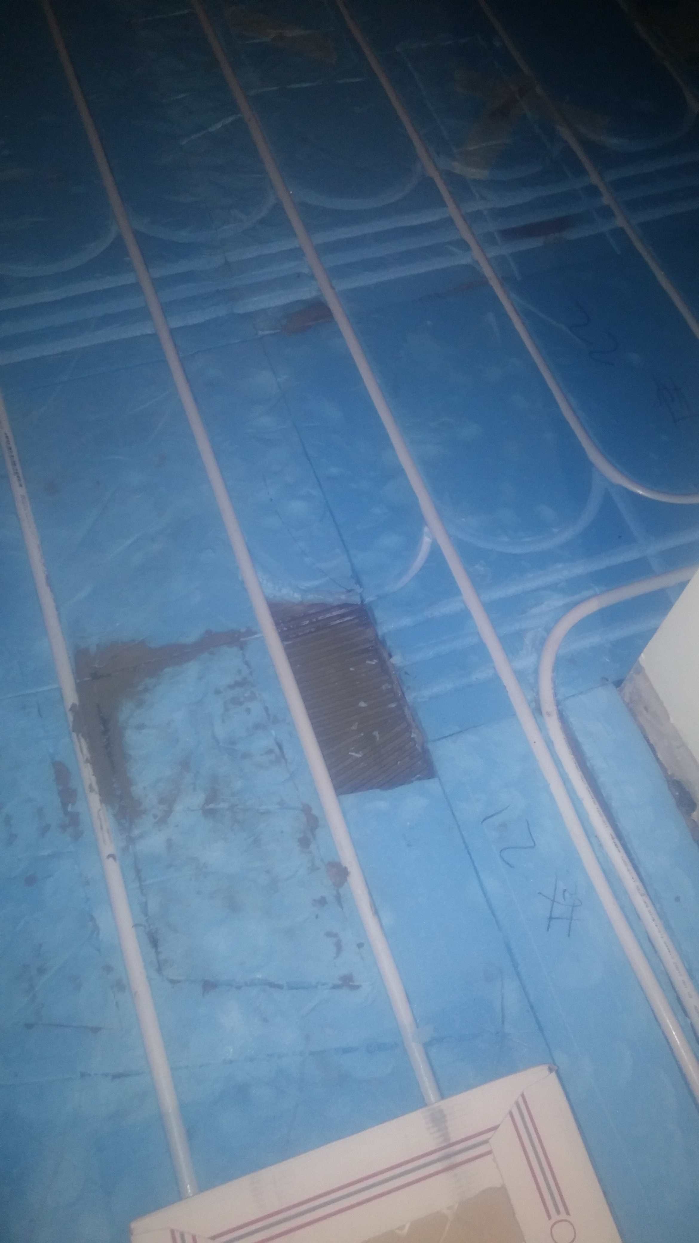

Andeh Posted March 11, 2025 Posted March 11, 2025 We did an overlay system in a 2006 house, 10 years ago. 25mm Insulated tray, on tile adhesive, 16mm pipe, latex screed. 50mm build up, but some careful shallow ramps with the neighboring carpet corridors meant it worked. Heat up times similar to radiators, so was controlled as one. Afraid this is the only pic I have from back then!

Andeh Posted March 12, 2025 Posted March 12, 2025 About 50mm overall... 10mm tile adhesive.... 25mm insulated trays...15mm thin screed then tiles on half, carpet on half. About 40sqm in total.

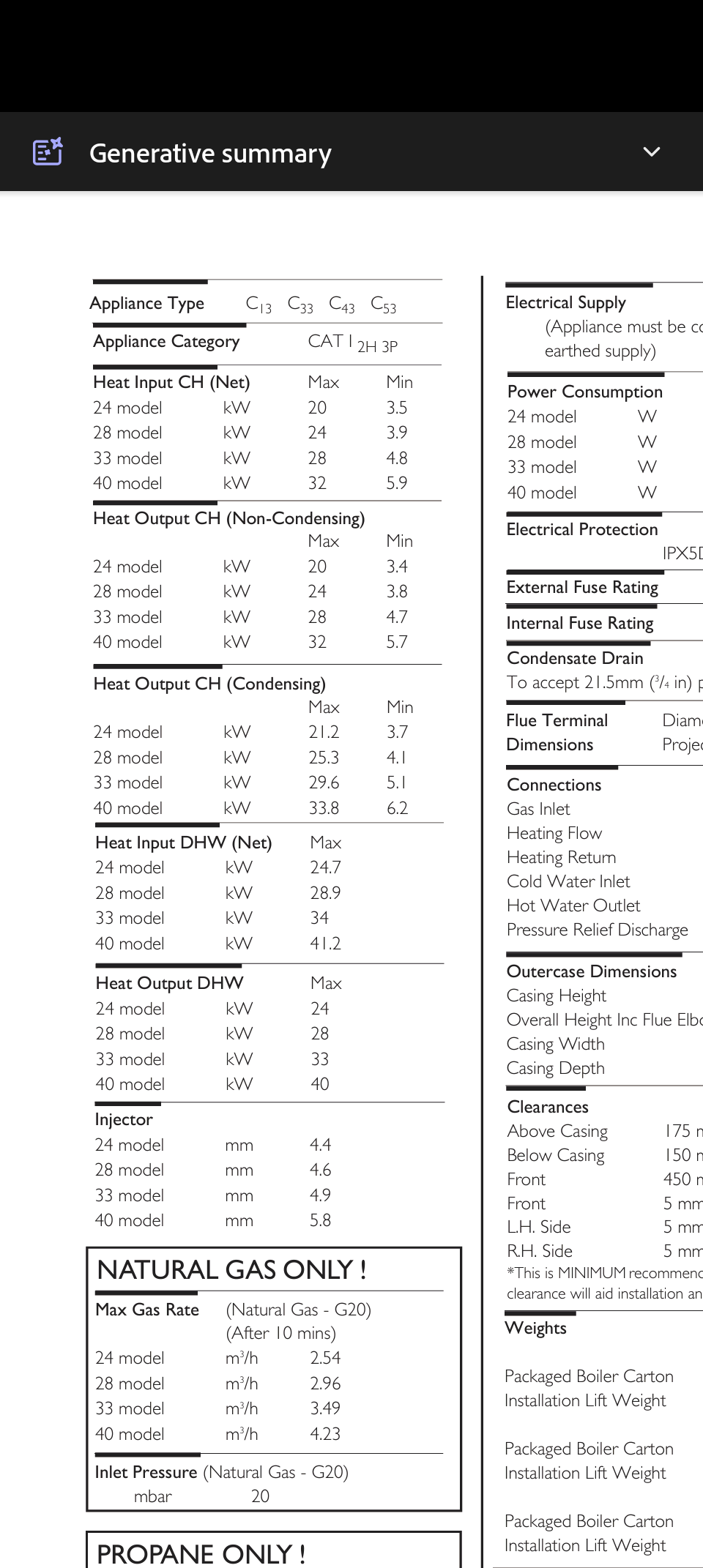

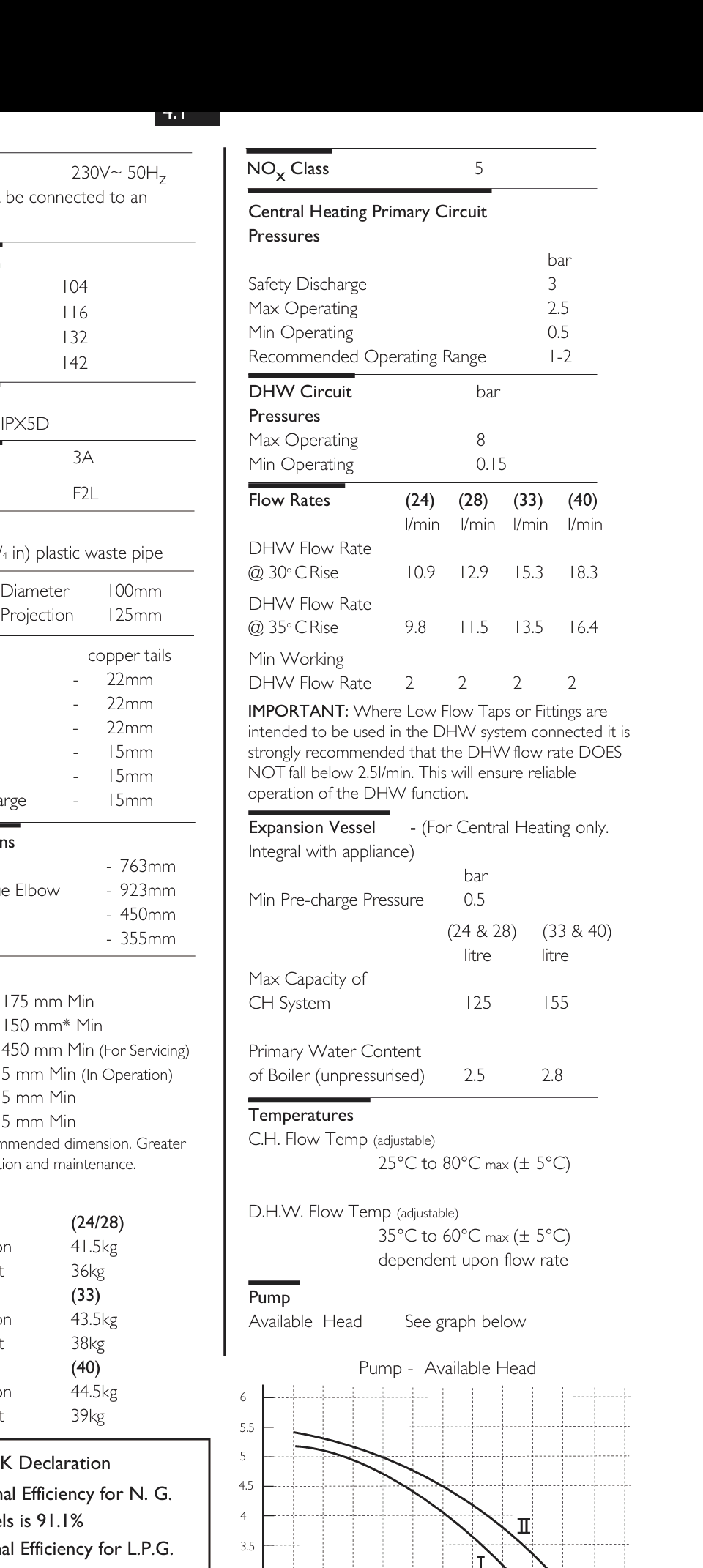

marshian Posted March 15, 2025 Posted March 15, 2025 On 11/03/2025 at 20:34, foundationsmcr said: Baxi Duotec 2 Combi Which specific model? Max Heat Output? Do you still have the installation manual for it? (because if you do that will tell you exactly what min modulation is) If I look on line for installation manuals - the range of min modulation across different version is pretty damn large - Some have min modulation of 3.7 kW on CH others are as high as 11kW depending on the Version (Peak Output) IMO you will struggle if your actual boiler doesn't modulate down to a min of around 5kW - you'll almost certainly need a volumiser to keep cycling to a minimum. Many Combi boilers have massive heat outputs to meet the needs of HW but this compromises the space heating side (CH) of the boiler.
JohnMo Posted March 15, 2025 Posted March 15, 2025 2 hours ago, marshian said: almost certainly need a volumiser to keep cycling to a minimum I always thought that, my original setup had one and I zoned to death. But have found UFH in concrete/screed absorbs heat really well due to a massive density compared to air. One of the reasons to keep the existing floor engaged is it will soak up the heat well. Your issue comes with zones and not having the flow rate to keep the boiler happy, especially if you only have one tiny zone open - there just isn't any flow. Short cycling will occur - A volumiser doesn't help with flow rate either. They help with water capacity but a fully engaged floor is just way better. I can quite happily run my boiler doing about 8kW or heat pump doing 5kW for hours at a time without house overheating (using 0.1 Deg hysterisis thermostat). UFH just isn't the same as a radiator system, especially when you can have plenty of concrete to work with, as the OP can.
foundationsmcr Posted March 16, 2025 Author Posted March 16, 2025 (edited) On 15/03/2025 at 10:38, marshian said: Which specific model? Max Heat Output? Do you still have the installation manual for it? (because if you do that will tell you exactly what min modulation is) If I look on line for installation manuals - the range of min modulation across different version is pretty damn large - Some have min modulation of 3.7 kW on CH others are as high as 11kW depending on the Version (Peak Output) IMO you will struggle if your actual boiler doesn't modulate down to a min of around 5kW - you'll almost certainly need a volumiser to keep cycling to a minimum. Many Combi boilers have massive heat outputs to meet the needs of HW but this compromises the space heating side (CH) of the boiler. Our boiler is a Baxi Duotec Tec 2 - 33 GA model Max heat output is 33KW DHW and 29.6KW CH (Condensing) I think the Min/Max is 5.1 / 29.6 CH flow rate temp 25-80 degrees (+-5 degrees) I'm not sure if I'm reading the correct element of the manual. I've snipped some tech details and attached them. Will this require a volumizer? As mentioned, we will still be running Rads upstairs. I'm reading some conflicting into on single or multi zones. We have young kids and doors are open/closing constantly, so would it therefore be better to have one single zone? If attaching pipe to the concrete, how do you prevent the screed leaking out with no DPM type barrier down to contain it? Thank you all, this is a steep learning curve! Edited March 16, 2025 by foundationsmcr

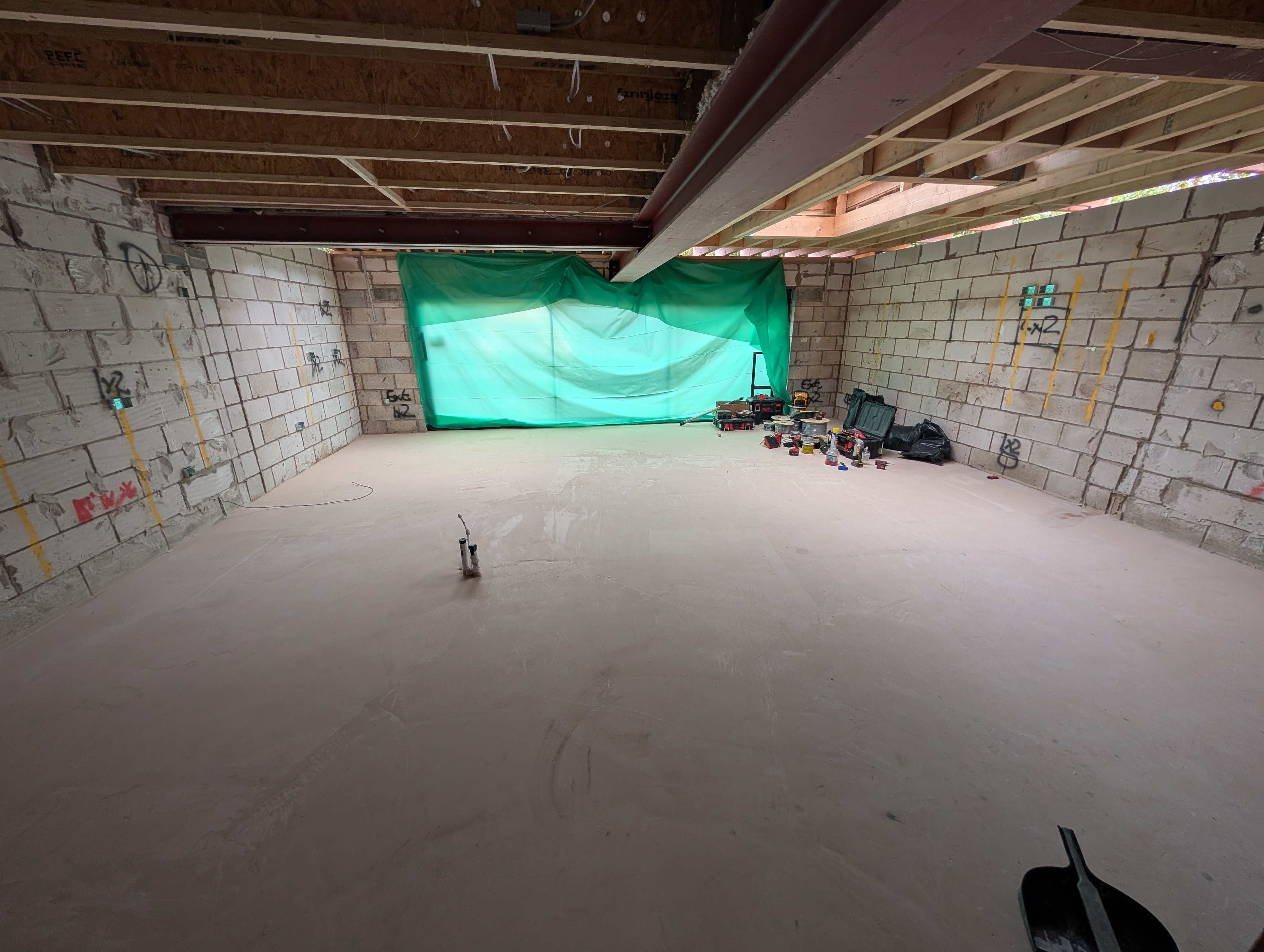

foundationsmcr Posted June 6, 2025 Author Posted June 6, 2025 Latest update, it looks like I'm going to install a wet system laid directly onto the existing slab (and built up slab in the "new" floor space) by milling the channels for the pipe, then lay a wet screed over , and LVT on top. After careful consideration, this gives me the best option to maintain the current external door thresholds as the datum floor height. We will be installing some "flush finish" sliding doors which will run in grooved track across the back of the house. I need to establish the FFL. What's the recommended method to do this? Here's a pic of the current floor, and new floor with the sliding door opening at the very rear (the tiled floor will be pulled up obviously)

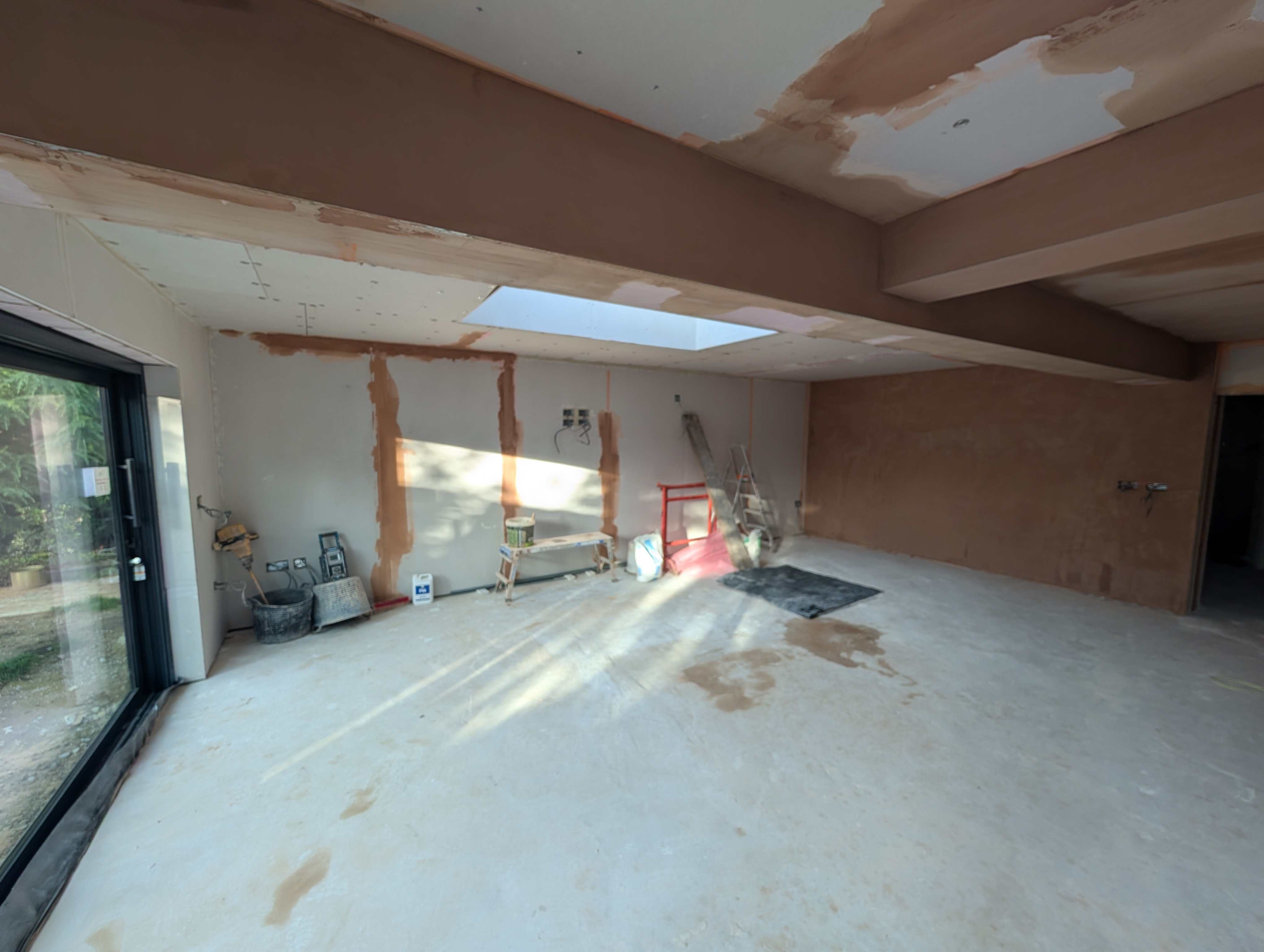

foundationsmcr Posted October 3, 2025 Author Posted October 3, 2025 It's been awhile and I thought I'd provide a further update for those interested in the floor milling approach to UFH. We're close to our kitchen installation now, the UFH has been in situ and running for around 4 weeks and so far so good. The house is toasty warm, the pad has heated up nicely and isn't on continuously which is good. Our LVT is due to be laid next week so we'll see how it performs once that is down. Overall I'm really happy. Obviously there are more preferable options, but given our limitations I'm really chuffed with how it has turned out. Thanks for all the comments and advice. 1 1
