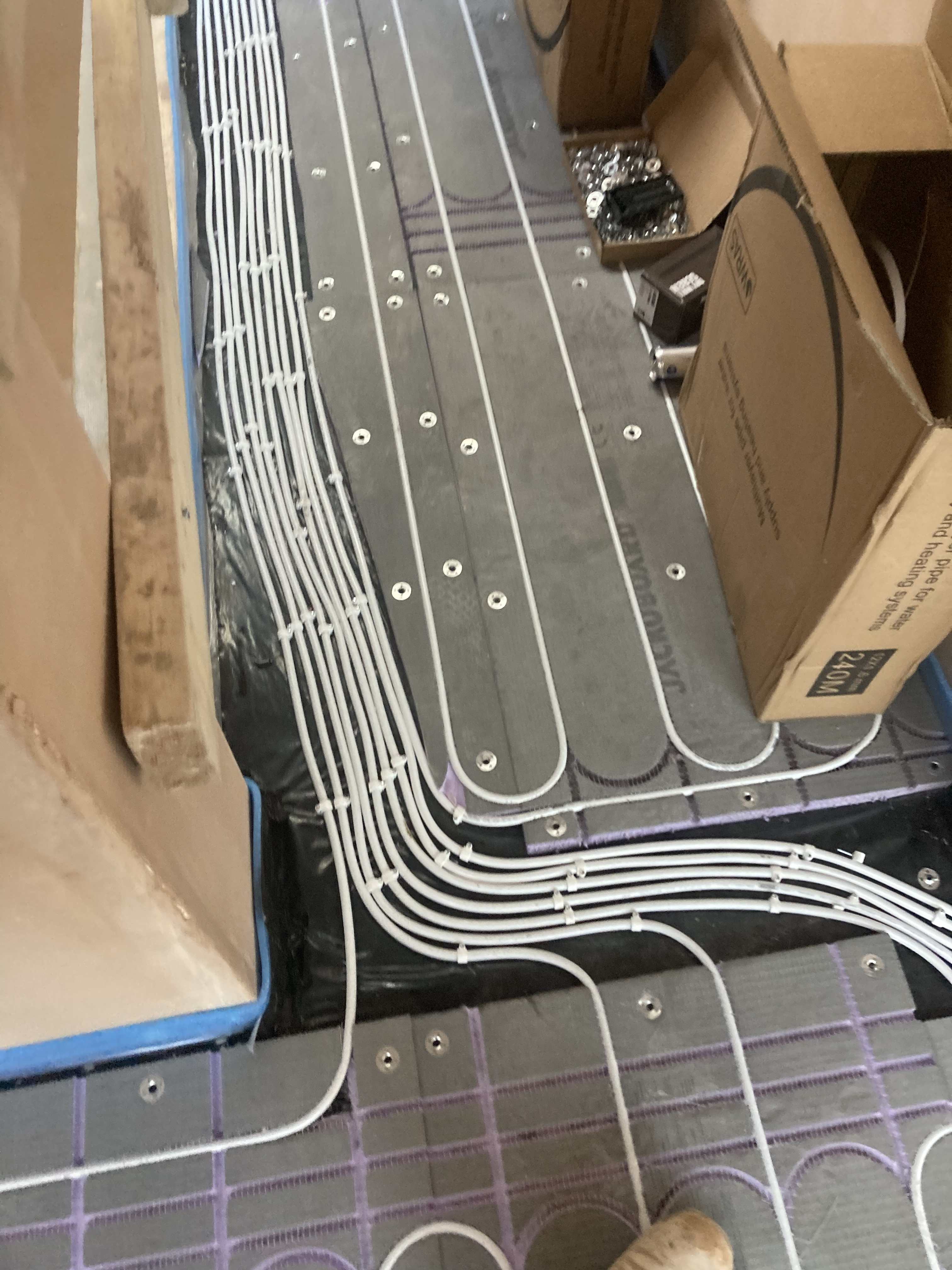

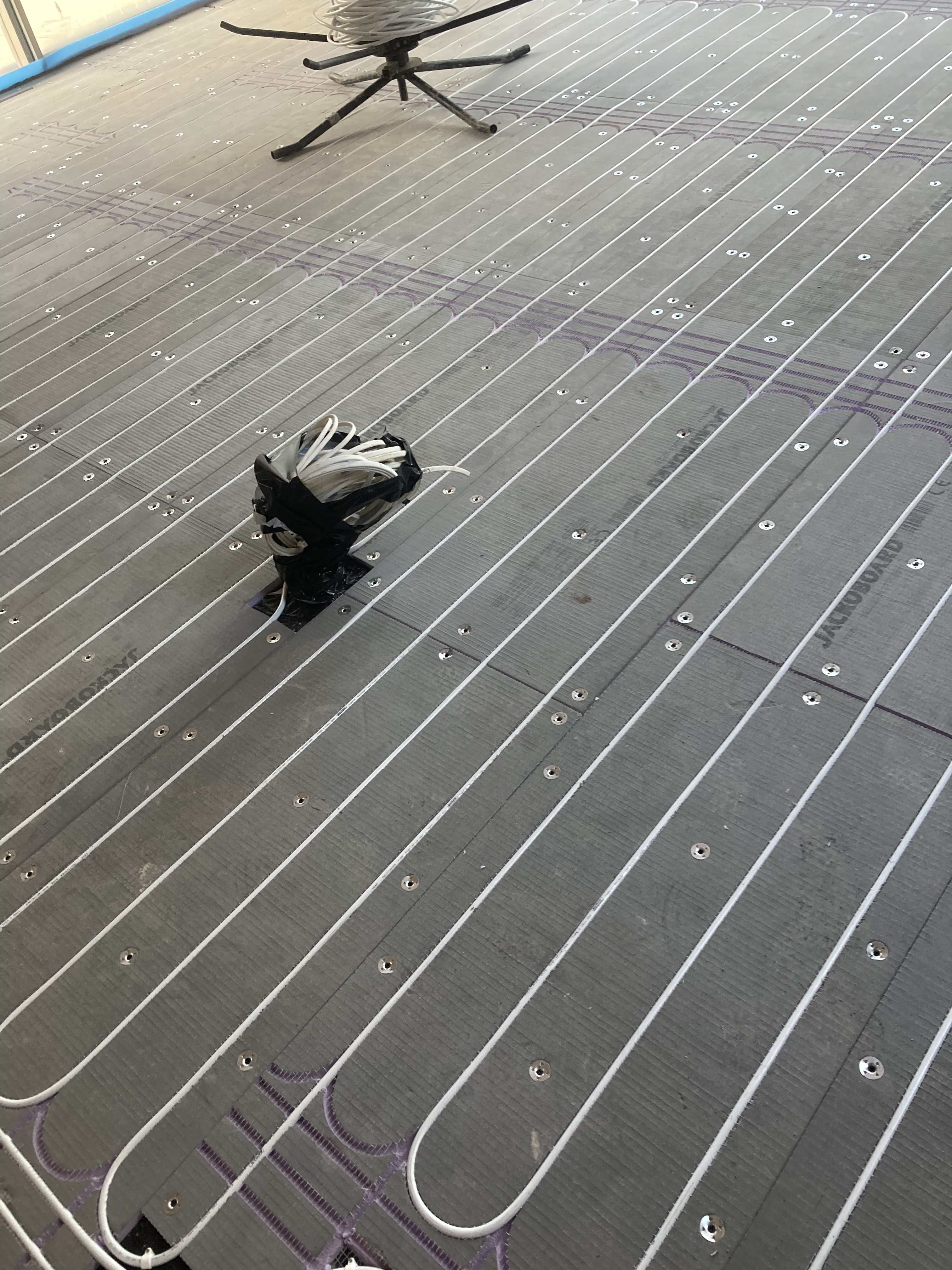

This is one I’m doing for a friend
Super easy 10 mil screed to go on the top
I don't see why not. Maybe need a bit of plastic down first to stop the screed running through any gaps?
Are your joists engineered to take this load?
Another alternative is laying the pipes between 25mm battens and surrounding with a dry mix.
Superfoil in that situation will add almost no insulation value. Don't you have acoustic insulation between your joists? That will provide insulation.
You could could just do egg crate panels screwed down and the screed over

Nod, looks like you have done a great job. please can I ask what diameter underfloor pipe you used? and where you got the clips from. plus what screed are you putting on top of the jack boards.
answers to the other questions. yes I will have acoustic insulation between the pozi joists. And I will investigate the egg panel idea.and the pattern and dry mix.
