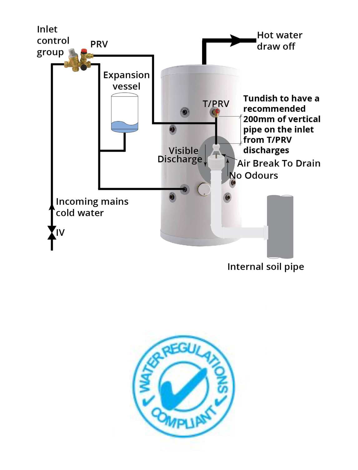

The above pic is from Hotuns site, but I really doubt the longevity of their waterless tundish offerings which have the non-return arrangement. Note that the above pic shows the tundish as the only air break stopping stench from the stack getting into the house. :/
I’ve used these once and was not overly impressed tbh, as the guts and spring / plunger just seem ‘feeble’, so won’t use again. Tundish and proper waterless trap every time for me!
