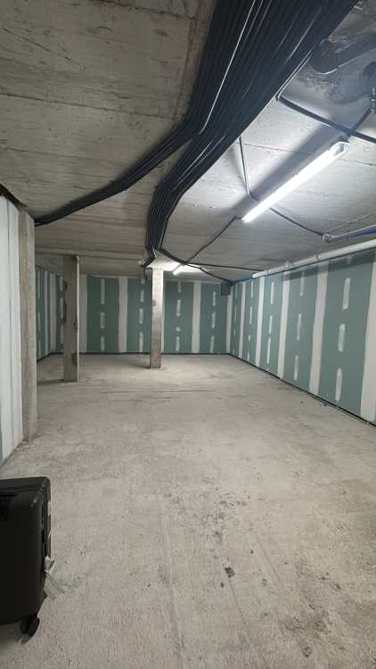

Mat1 Posted February 22 Posted February 22 I have a 65m2 "semi finished" basement that I want to finish into a cosy entertainment/living space. I'm in Ibiza where the lowest temperature in winter is about 8degrees and we don't get much rain. The houses in general are never warm. Currently the space is uninsulated but dry and well ventilated. Some of my neighbours have done amazing looking conversions but none with any internal damp proofing or insulation. It's hard to know whether it's necessary given the climate. It will have heating of course. Currently the plan is to tank the whole thing with Sika damp proof slurry then low profile insulation for the walls and floor. 25mm XPS/PIR for the walls and floor. The XPS will potentially have the UFH built in. Anything I'm missing here? Can anyone suggest any other build-ups for the walls and floor? 1
Conor Posted February 22 Posted February 22 What's the winter time soil temperature where you are? That will largely determine your insulation / heading needs. 1
Mat1 Posted February 22 Author Posted February 22 Hi based on the data I could find I would estimate 8-10C. Similar to the the air temperature at its coldest.
Mat1 Posted February 22 Author Posted February 22 According to a few sources online it seems it's not strictly necessary to insulate the slab if you're going for UFH. That saves one job.
Conor Posted February 23 Posted February 23 Those sources are wrong. Never believe randomers on the internet 🤣 I don't know how cold it gets there, or what expectations you have, but my first thought would be an air-to-air heatpump. A lot less complex that UFH and will heat the space faster and more efficiently than UFH laid directly on the ground. Is your basement currently completely dry? By adding insulation or other layers, you might actually create moisture problems as the ventilation system could be dealing with any moisture on its own. If you were to insulate, I'd go for 50mm. 25mm not really worth the bother. How much head height do you have and what are the local building regulations? 1

Conor Posted February 23 Posted February 23 You could do an experiment. Get a smart thermometer (e.g. meross) set it to log temperature every 15mins or so, hang it off the ceiling at about head height. Get a cheap oil heater, set it on low (750W or so), and leave it on a timer plug (12hrs a day) for a few days and see what happens. 1
