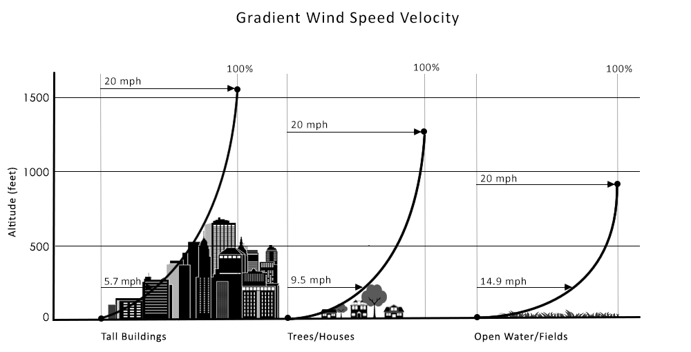

Slight modification in the quote.
Wind turbine power is a function of the airspeed cubed, so m.s-3
This makes the speed gradient from the ground up important, as is surface roughness.
