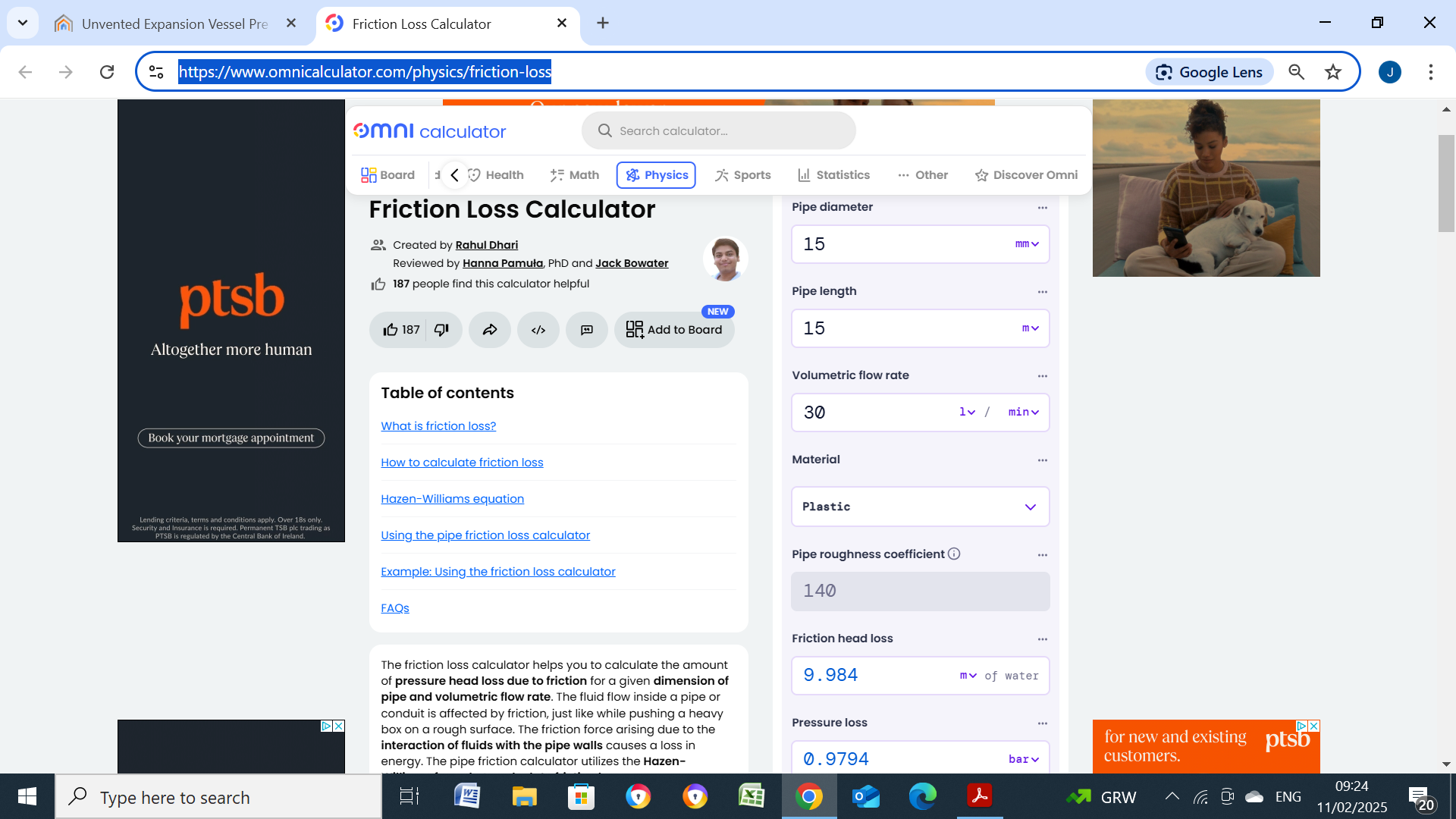

John Carroll Posted February 11, 2025 Posted February 11, 2025 3 hours ago, Mattg4321 said: It’s in 22mm copper and around 800mm Maybe we're all barking up the wrong tree!, if these friction loss calculators are to be believed, then 15M of 15mm ID pipe should only lose < 1.0bar at a flowrate of 30LPM, maybe check out the PRV for faulty operation or filter blockage?. You are getting a dP of ~ 2bar at probably around 15/20LPM?. https://www.omnicalculator.com/physics/friction-loss

Nickfromwales Posted February 11, 2025 Posted February 11, 2025 29 minutes ago, Mattg4321 said: I tested dynamic pressure on the main. Ie before the cylinder and PRV. So it can only be a problem on the main or the stop cock (which is almost new and fully open) I think? Guessing that black pipe is just too small. The stop cock is 15mm copper as that’s apparently the size of the black main internally. Then steps up immediately to 22mm copper to cylinder. None of that should really matter, so it's odd behaviour tbh. Do you have a non return (double check) valve immediately after the stopcock? Defo pump the EV pre-charge back up asap. 29 minutes ago, Mattg4321 said: Thanks. So it seems like I need to get a new main in. 25mm or perhaps even 32mm if there’s any benefit to that? Then fit a 3 bar PRV at stop cock to match the 3 bar PRV at cylinder. Should sort my dynamic pressure problem and potential backfeed problem at new kitchen tap? That's how I would have left this from the point of commissioning, before leaving the property tbf. Don't forget the NRV on the hot outlet of the UVC, but my advice, with the less than cosmic local network flow / pressure you have, would be to use a 28mm NRV with 22mm internal reducing sets; so there is little to no resistance from the bigger valve body .
John Carroll Posted February 11, 2025 Posted February 11, 2025 45 minutes ago, Mattg4321 said: Thanks. So it seems like I need to get a new main in. 25mm or perhaps even 32mm if there’s any benefit to that? Then fit a 3 bar PRV at stop cock to match the 3 bar PRV at cylinder. Should sort my dynamic pressure problem and potential backfeed problem at new kitchen tap? I tested dynamic pressure on the main. Ie before the cylinder and PRV. So it can only be a problem on the main or the stop cock (which is almost new and fully open) I think? Guessing that black pipe is just too small. The stop cock is 15mm copper as that’s apparently the size of the black main internally. Then steps up immediately to 22mm copper to cylinder. What was the flowrate when you tested the dynamic pressure??, I have a bit of 21mm OD, 11.0mm ID piping lying around here since this house was built 53 years ago, so IF the ID of your pipework is only 11.0mm then 15M at a dP of say 4.0-1.0, 3.0bar will still flow 23LPM, it will still flow 13.5LPM at a dP of only 1.0bar, if your pipework is 15mm ID then it will flow 55LPM at a dP of 3.0bar and 31LPM at a 1.0bar dP., so its important that you know what the flowrate (& dP) was during that dynamic test before you go off doing anything. 1
Nickfromwales Posted February 11, 2025 Posted February 11, 2025 23 minutes ago, John Carroll said: What was the flowrate when you tested the dynamic pressure??, I have a bit of 21mm OD, 11.0mm ID piping lying around here since this house was built 53 years ago, so IF the ID of your pipework is only 11.0mm then 15M at a dP of say 4.0-1.0, 3.0bar will still flow 23LPM, it will still flow 13.5LPM at a dP of only 1.0bar, if your pipework is 15mm ID then it will flow 55LPM at a dP of 3.0bar and 31LPM at a 1.0bar dP., so its important that you know what the flowrate (& dP) was during that dynamic test before you go off doing anything. Yup. I'll often dig up the mains at the boundary and test there, to discount a damaged or 'furred up' pipe between the network and the stopcock (within the boundary). People have replaced the cold mains and saw little to no improvement.
Mattg4321 Posted February 11, 2025 Author Posted February 11, 2025 1 hour ago, John Carroll said: What was the flowrate when you tested the dynamic pressure??, I have a bit of 21mm OD, 11.0mm ID piping lying around here since this house was built 53 years ago, so IF the ID of your pipework is only 11.0mm then 15M at a dP of say 4.0-1.0, 3.0bar will still flow 23LPM, it will still flow 13.5LPM at a dP of only 1.0bar, if your pipework is 15mm ID then it will flow 55LPM at a dP of 3.0bar and 31LPM at a 1.0bar dP., so its important that you know what the flowrate (& dP) was during that dynamic test before you go off doing anything. 1 hour ago, Nickfromwales said: Yup. I'll often dig up the mains at the boundary and test there, to discount a damaged or 'furred up' pipe between the network and the stopcock (within the boundary). People have replaced the cold mains and saw little to no improvement. I just repeated the test. Pressure measured at the kitchen sink directly off the main. New pipework so won’t be furred up etc Had the outside tap fully open. Also directly off the main. static pressure. 3.6 bar dynamic pressure. 1.4 bar with outside tap wide open flow rate at outside tap with it wide open. 18 litres per minute outside tap fed by 15mm copper not sure what that tells me!
