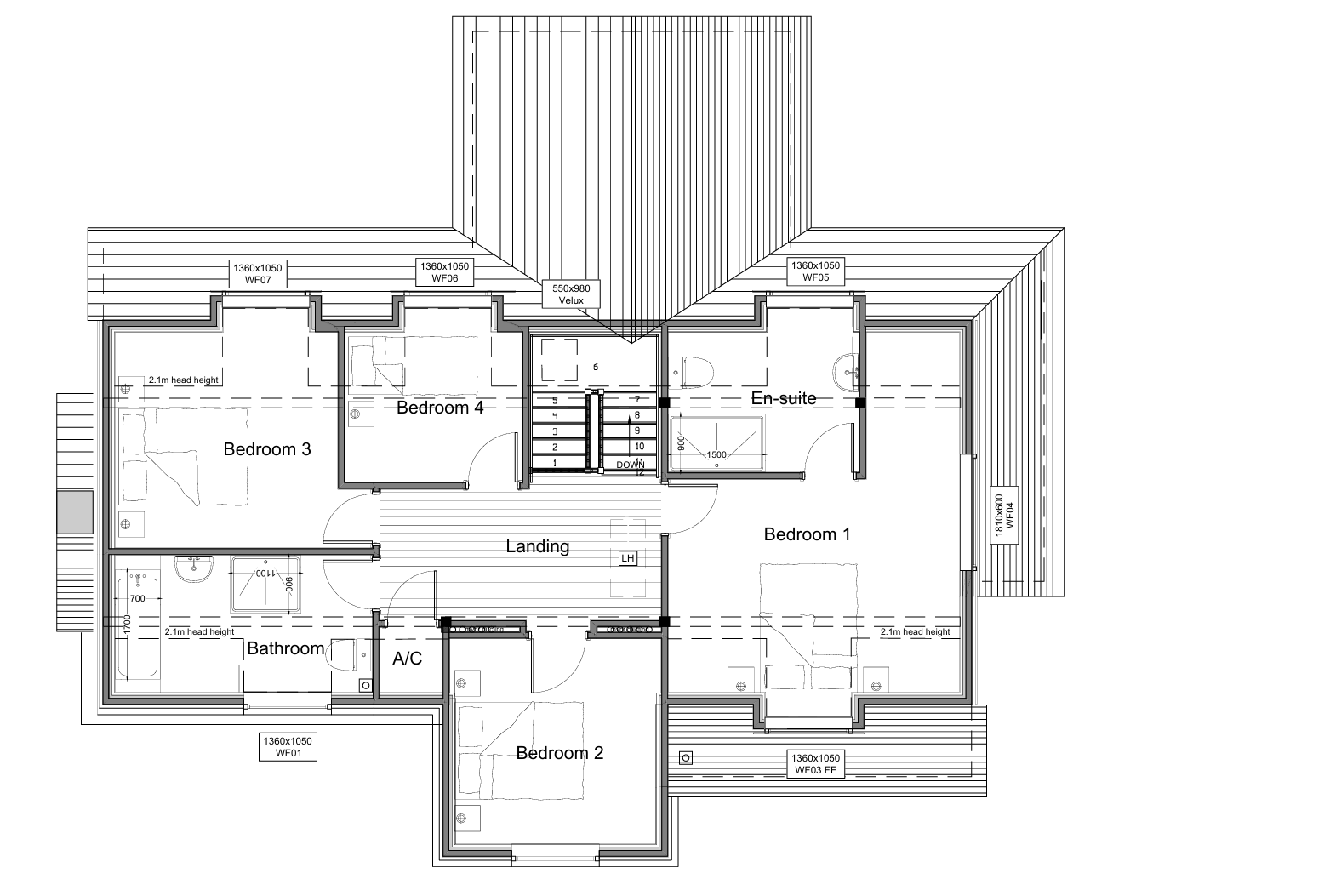

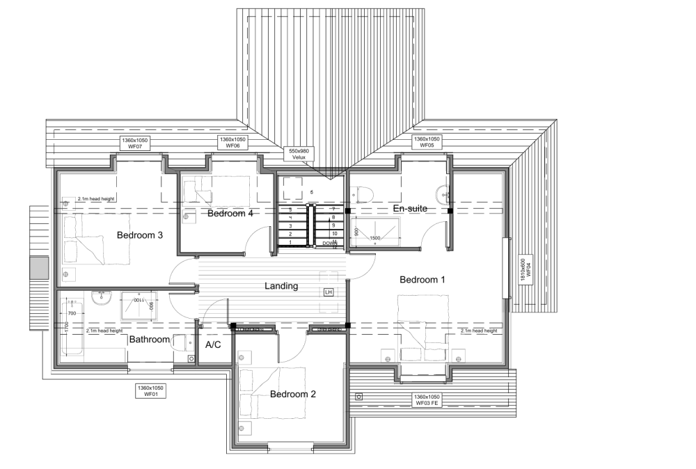

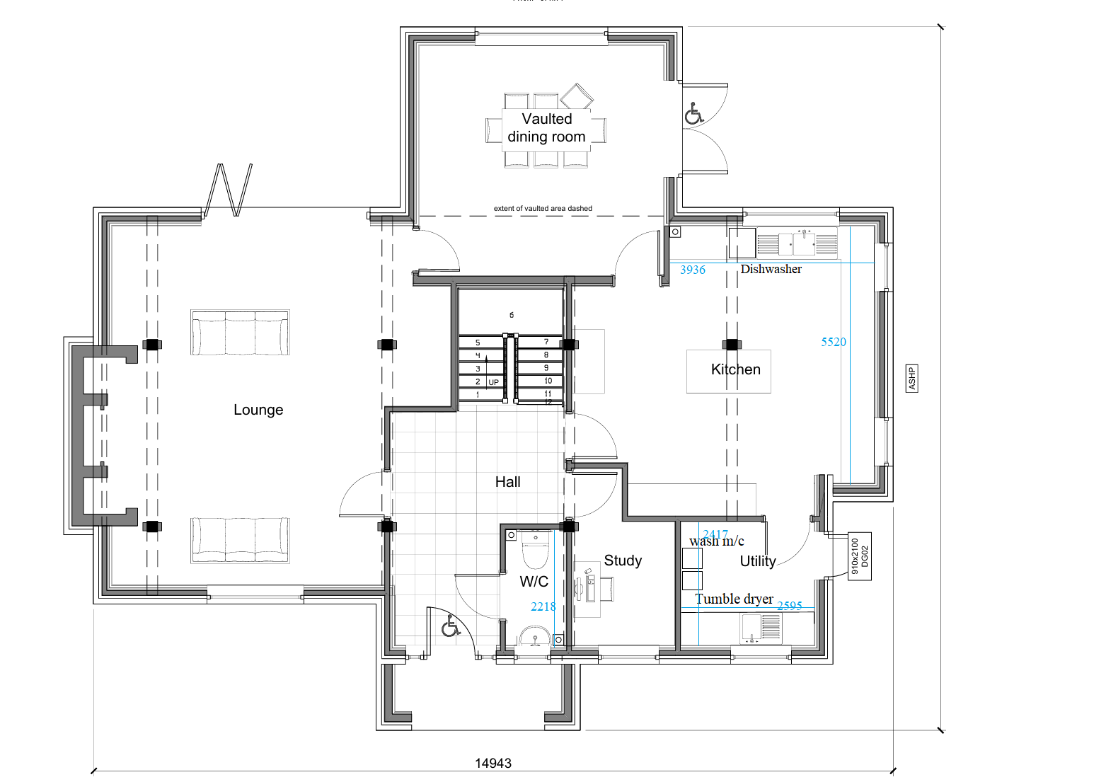

Post and beam Posted February 3, 2025 Posted February 3, 2025 (edited) Hi Guys Can anyone provide a sanity check of my recently provided quote please. House is 200 sq metre , 2 storey, 4 bed bath & ensuite with a downstairs WC. Dishwasher in the Kitchen and washer and tumbly in the utility. There will be a manifold for UFH under the stair. Many thanks in advance EDIT: £12800 total inc Materials @ £4200 Soil pipes- Erect new soil pipe externally to feed upstairs bathroom- Install kitchen box pipe then extend up to en suite bathroom above terminating in boxing with AAV Cold main (Hep20)- Run cold main pipe work from utility to kitchen sink and to airing cupboard Hot and cold services (MLCP Pre insulated)- Run hot and cold services to each area needed including a secondary hot return (Run in MLCP)- Leave tails in airing cupboard Heating circuit (Hep20)- Run pipework for upstairs heating circuit for 7 radiators including towel rails (not including downstairs cloakroom?) Insulate all pipework- Leave tails in airing cupboard- Second fix radiators once ready supplying valves but not radiators themselves Primary flow and returns (Hep20)- Run flow and return pipework from under stairs to airing cupboard Bathrooms- 1st fix main bathroom, shower room and cloakroom-2nd fix once ready (customer supplying suite)- Tiling can be provided for extra charge* Kitchen/utility-1st fix areas 2nd fix once worktops installed Edited February 3, 2025 by Post and beam
Post and beam Posted February 3, 2025 Author Posted February 3, 2025 17 minutes ago, JohnMo said: The quote is what? Good question well presented. Apologies. Edit to include cost
JohnMo Posted February 3, 2025 Posted February 3, 2025 Observation I thought you were getting BUS grant for ASHP, the grant should cover the installation of the heating system also, so should that bit be covered by the heating installation? Seems mad they are doing everything including supply radiator valves but not the radiators? All sounds expensive to me, I would be looking for a second or third quote.
Post and beam Posted February 3, 2025 Author Posted February 3, 2025 (edited) I do have a company lined up to do the ASHP & UFH . They dont do first fix though. The above price is only for the first fix pipework. The labour works out at 21 days @ 400/day Edited February 3, 2025 by Post and beam additional info
nod Posted February 4, 2025 Posted February 4, 2025 Very expensive Get a few quotes Ask your ASHP guys for recommendations
Post and beam Posted February 4, 2025 Author Posted February 4, 2025 I sent a few requests for quote out via one of the usual aggregation sites last night. Lets see what i get back.
