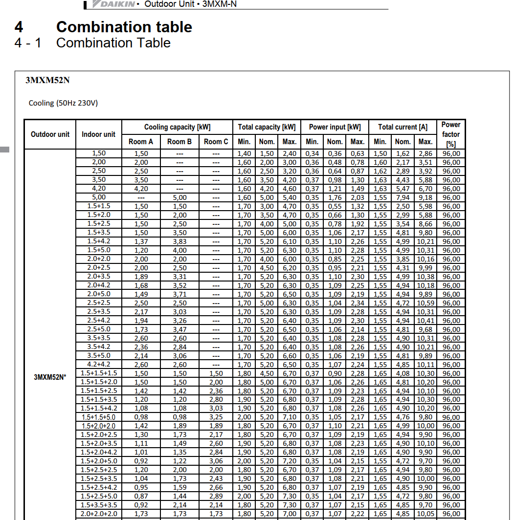

I installed a Daikin System a few years ago in my extension. I went for a 5kW outdoor unit, feeding 3 indoor units, 2x2.5kW and a 3.5kW, and its fine. Theres actually a page in the Daikin manuals that tells you what actual effective cooling/heating power you'd get if you were to run them all at the same time full power, which obviously is not the 2.5/3.5kW, but that just never happens and it's all good.
Here's a screenshot -

I think it'll be absolutely fine, even if Mitsi dont have the page like I had in the Daikin manual. With the 11.2kW outdoor unit you mentioned above with 6 connections, is it even possible to connect 6 units and stay under 11kW? Even with small 2kW indoor units, that's 12kW and over the 11.2kW max from the outdoor unit. All that will happen is the outdoor unit just wont be able to keep up with the demand on that 0.0001% chance all indoor units are running and demanding max cooling/heating at the same time.

Exactly, I feel the same way, it'd just be very strange if it wouldn't work at all. And 2.5 is the lowest powered indoor unit in the entire range, so 6x2.5 is already way over.
But somehow it's listed as 'wont work'. Hm I should call mitsu to confirm.
Yeah, fire off an email to a technical dept address if you can find one to get clarification, then you can try and persuade any installer it'll be fine with hopefully a good email reply.
If you can reassure any installer it'll all be fine and you're not likely to be harassing them to come back because the units are not all working full chat at the same time, then they'll hopefully be happy to go ahead with that unit.
