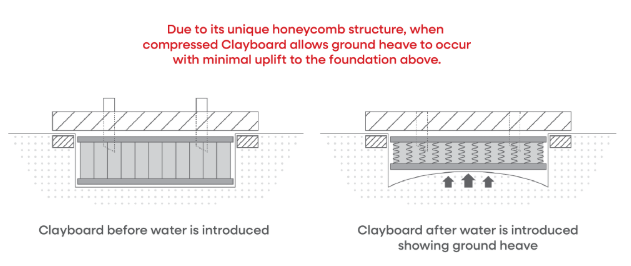

Alan Ambrose Posted February 3, 2025 Posted February 3, 2025 So, this holds the slab while it's setting and effectively makes a void later, protecting from heave? This assumes the trenches are deep enough, secure, never move, and are strong enough to handle differential movement?
Gus Potter Posted February 4, 2025 Posted February 4, 2025 Yes but you would normally have clayboard on one or both sides of the founds as well. Each case needs to be deisgned for the site ground conditions.
