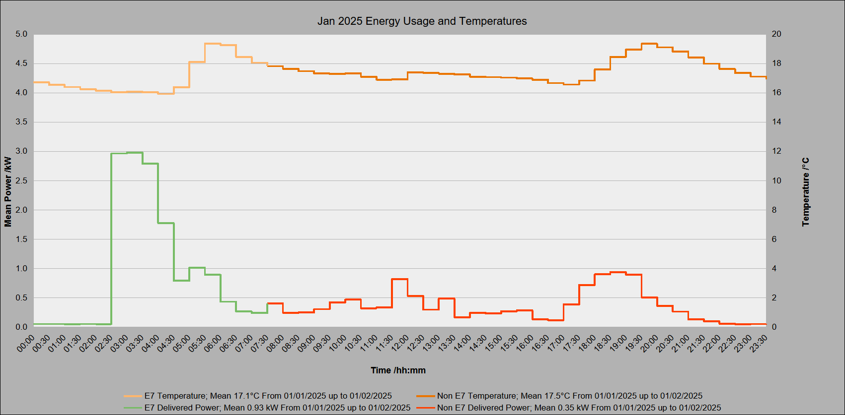

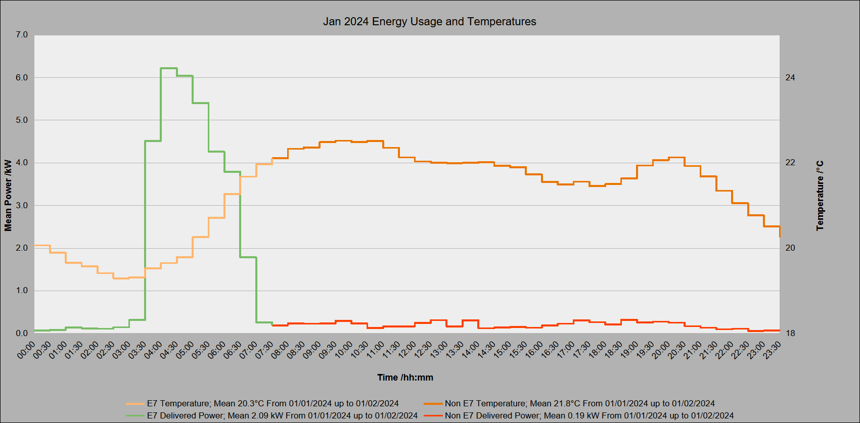

SteamyTea Posted February 1, 2025 Posted February 1, 2025 I have done an experiment this year, it involves not turning my storage heaters on. I now just use a fan heater when and where I need it. This is very easy for me as I live alone. The headline figures are below. Jan 2024, Mean Power 0.75 kW, Energy Usage 543 kWh, Max Power 8.9 kW, Mean Power >0 0.94 kW, Mean Internal Temp 21.3°C, Mean External Temp 4.5°C, ΔT 16.9K, Zero Power 32% Jan 2025, Mean Power 0.44 kW, Energy Usage 329 kWh, Max Power 4 kW, Mean Power >0 0.55 kW, Mean Internal Temp 17.4°C, Mean External Temp 4.8°C, ΔT 12.6K, Zero Power 43% So around 60% of the energy usage, but with a lower internal air temperature of 4K. This lower temperature is not a problem in reality as I am out at work a lot, and can just switch the fan heater on and the room is up to temperature in a few minutes. On a daily basis, in Jan 2024 I was using 17.5 kWh.day-1, Jan 2025, 10.6 kWh.day-1 (I was aiming for 10 kWh.day-1, so close). Now this will affect my costs as I am on E7 and EDF has not fully published all my data yet. But last year I paid £118.81 and this year (excluding yesterday), £87.34 (So 74% of the price this year). So even allowing for the higher day unit price, but still heating my water in the E7 window, I have saved 26% in cash terms. Now rates have changed in the last year. Jan 2024, Standing Charge 62.46p.day-1, Day Rate 36.72p.kWh-1, Night Rate 14.68p.kWh-1 Jan 2025, Standing Charge 71.22p.day-1, Day Rate 31.473p.kWh-1, Night Rate 12.574p.kWh-1 So 14% increase on Standing Charge, -14% Day Rate and -14% Night Rate. I will look at this again when I have all the numbers in and see what is really happening with the price changes (I can look at the weighted averages at the half hour). Still, I saved £31.47, or about a third of the price of the speeding ticket I am about to be issued with for doing a reckless 27 MPH. 1
