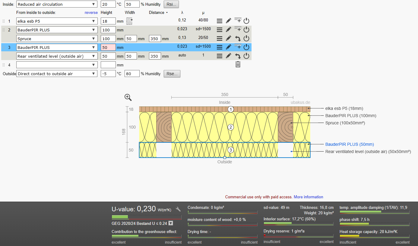

As I'm avoiding doing real work I though it might be interesting to do a cost comparison for a PIR between the joists vs my above method.
First lets look at the PIR wedged between the joists with foam and foil tape.

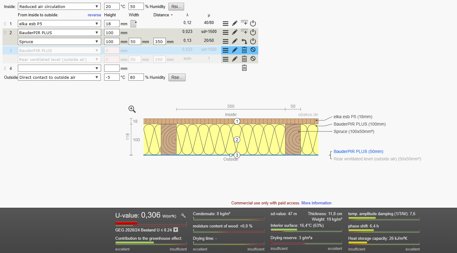

Here's the normal arrangement.
However with a little thinking and extra spend on PIR and just let it extend below the floor joists you can get a good improvement in U Value. Here's 150mm between the joists. Ubakus won't let me show the PIR as a single board)  Lets work from this.
A 150mm board is £56. However because of the way you need to cut it you'll loose 0.36m2 from each board. Maybe you can use some of these offcuts so lets be generous and say you get 2.6m2 from every board £21.54/m2 for PIR but you have to account for the spaces taken up by the joists so the PIR will cost you £18.84 per m2 of your room.
FM330 foam is £12 per can and lets say you make sure it's done well and use 1 can for every 3 boards. That comes to £1.5/m2.
150mm Foil tape is £2.20/m to bridge the top of each joist and give 50mm coverage on each side overlapping the foil face of the boards. You'll use 2.5 linear m per m2 floor so £5.5/m2
Total cost per m2 for the above arrangement is £18.84+£1.50+£5.50= £25.84 per m2. Add a little more waste in the tape and call it £26 per m2 For a U-Value of 0.23W/m2K.
Nicely done. ( until the foam shrinks in 5 years and the insulation falls into the ventilated floor that is!)
I'll split the post here.

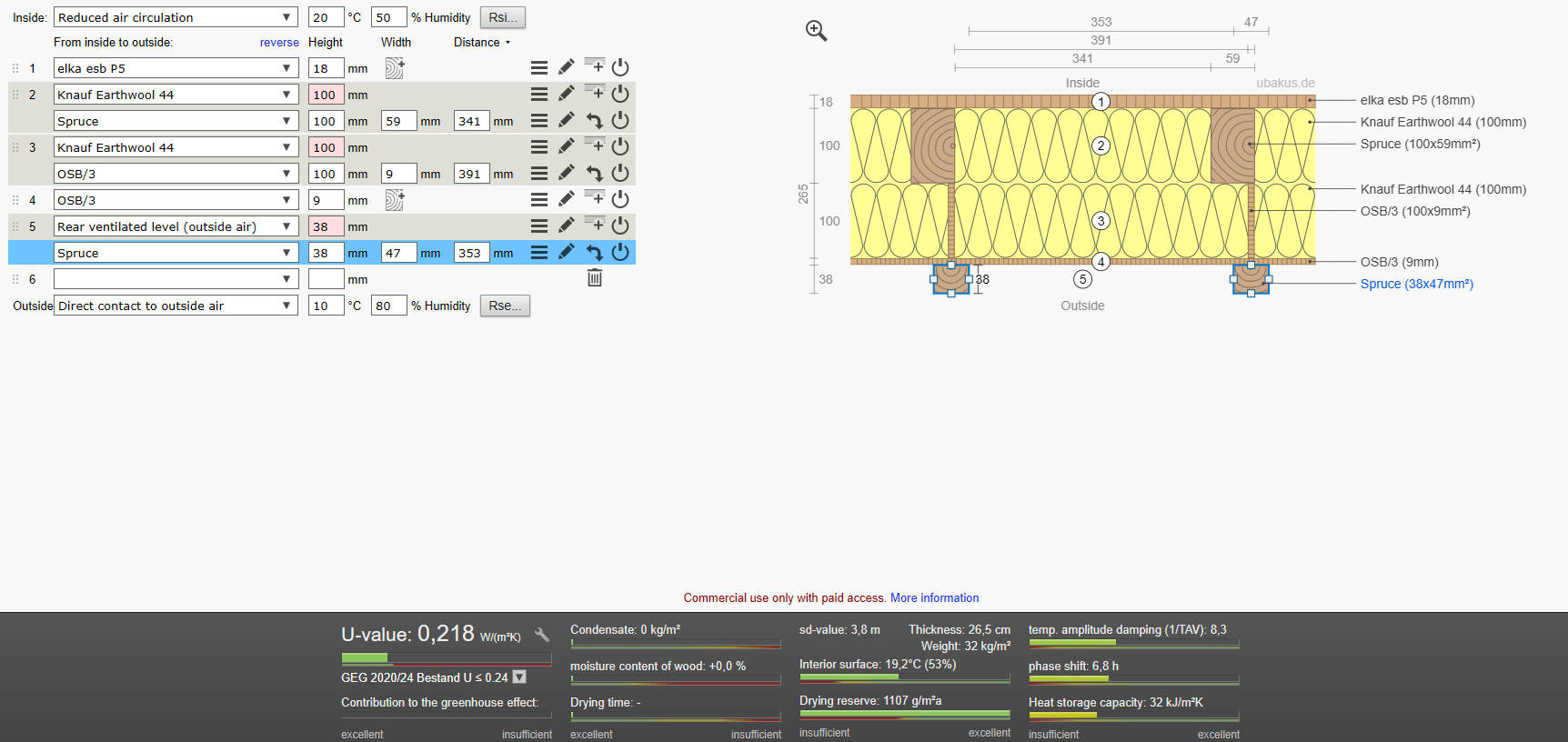

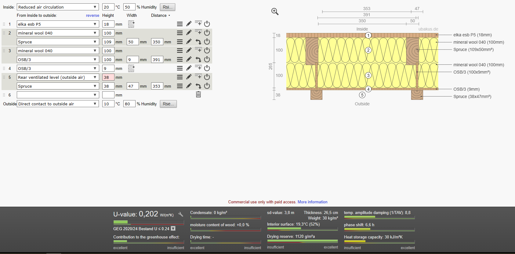

Here's my idea. It's hard to show the OSB as described above in UBAKUS but it's useful for a U value comparison anyway.
