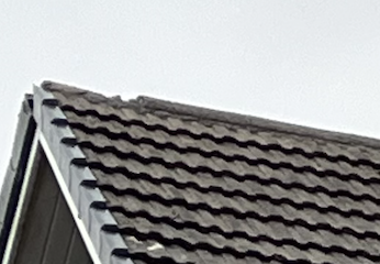

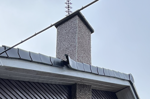

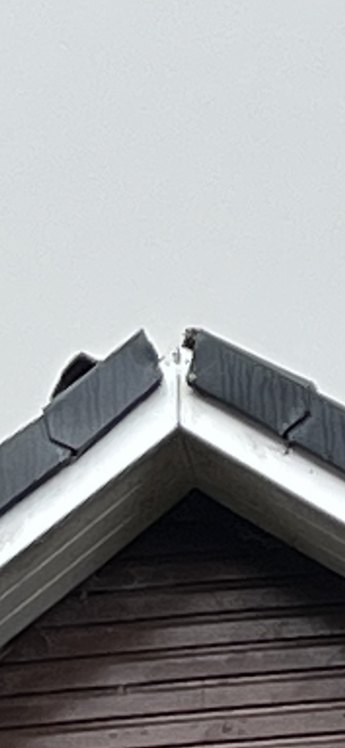

LLL Posted Saturday at 12:42 Share Posted Saturday at 12:42 Can anyone tell me what this is called? It seems the parts (seems plastic?) at the size of the roof are missing and it is leaking a bit (the chimney side, I can see the sky inside), it is something I can fix and what is it called? Also seems there is a tile on the top of the roof missing but i did not see a leakage, is it something i should repair asap? thanks Link to comment Share on other sites More sharing options...
Mr Punter Posted Saturday at 12:51 Share Posted Saturday at 12:51 That is a plastic dry verge and concrete ridge tiles. The biggest issue is safe access. Link to comment Share on other sites More sharing options...
LLL Posted Saturday at 13:47 Author Share Posted Saturday at 13:47 55 minutes ago, Mr Punter said: That is a plastic dry verge and concrete ridge tiles. The biggest issue is safe access. The concrete one must be down by someone professorial. I should be able to access the black plastic one at side by using leaders, it is something nails used to connect with the roof? Link to comment Share on other sites More sharing options...
