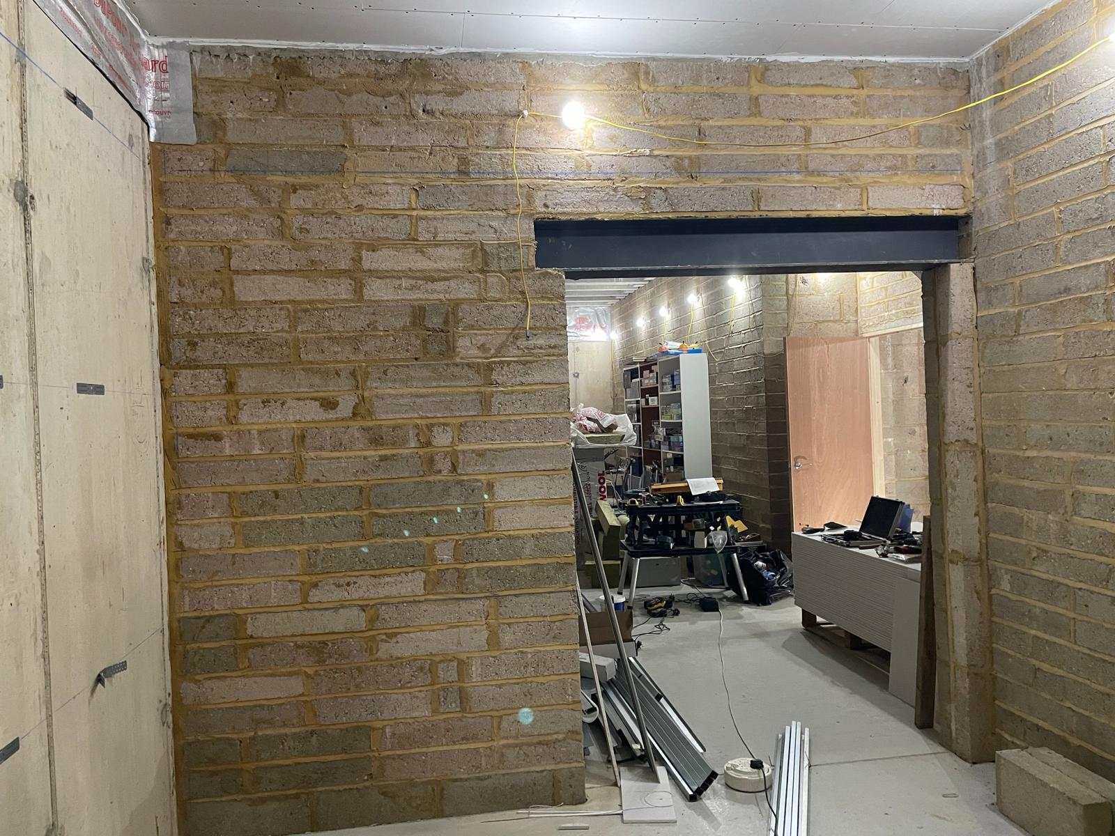

2. when building a GypLyner Single lining system on walls with doors, how do you go around the doorway? the white book shows a window reveal but nothing about a doorway! https://www.british-gypsum.com/documents/white-book/british-gypsum-wb-gyplyner-single.pdf . i have a double width doorway and a single width doorway to navigate with my lining.
WhatsAppImage2025-01-21at09_15.23(1).thumb.jpeg.b51b64459cc3f32fc909c2797b9b919a.jpegWhatsAppImage2025-01-21at09_15_23.thumb.jpeg.b848d3cd900071e2f4999e82b7f1e4a8.jpeg

You need at least one layer of board between the rez bar and top hat

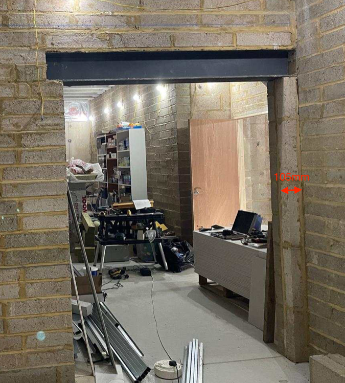

Your tight for room on the right side Fix one set of brackets 150 in from the edge The right side fix in the middle While the left side of the bracket need marking and cutting off Leave the right side long and fold it over the stud and fix to the face of the stud
I've only got 105mm from the right hand side. 😢

25 minutes ago, Thorfun said:
thank you for confirming this.
That’s enough
Bracket 50 mil in
