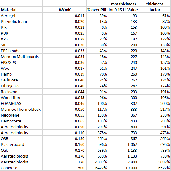

mjc55 Posted Thursday at 18:12 Share Posted Thursday at 18:12 Anyone used this of late. It looks good in terms of replacing other types of less environmentally friendly insulation but haven't got far enough to look at costs. There was an old thread from around 2019 saying that it needs to be much, much thicker (their emphasis), does this mean that it is much more expensive in the long run? That was pre-pandemic and presumably petrochemical type insulations have increased in price a lot since then. Thanks Link to comment Share on other sites More sharing options...

Alan Ambrose Posted 8 hours ago Share Posted 8 hours ago >>> it needs to be much, much thicker This is my material crib-sheet. It suggests, that for the same U-Value, Foamglas needs to be twice as thick as, say, PIR. 1 Link to comment Share on other sites More sharing options...
