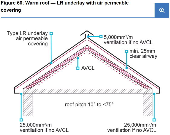

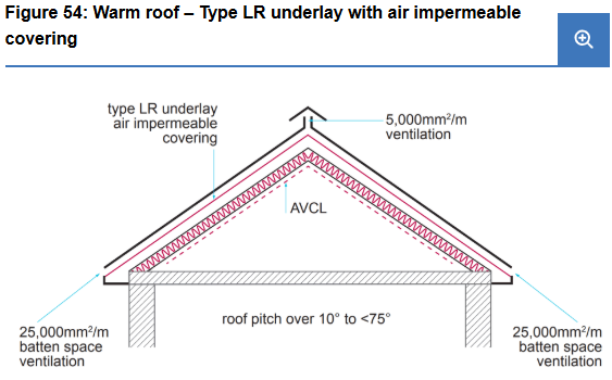

thanks, @JohnMo some interesting points.
I was looking at the NHBC diagrams (https://nhbc-standards.co.uk/7-roofs/7-2-pitched-roofs/7-2-15-ventilation-vapour-control-and-insulation/)
Whether or not the roof covering is air permable, the suggestion is for a conitnuous ventillation gap which allows air flow. This seems quite different to gaps in the sarking which allow vapour diffusion.
image.png.33012043b953d7d7e6efdddcdd1706ee.png image.png.c4ae2a02b21c5d6a2219177ce81607f4.png

You need to careful looking at English references as the roof build is completely different. England doesn't use sarking boards, instead the membrane is drooped to form valleys for water run off, so they need to provide a free space between insulation top of rafter.
Your sarking boards provide a natural airspace, as long as the membrane is breathable.
