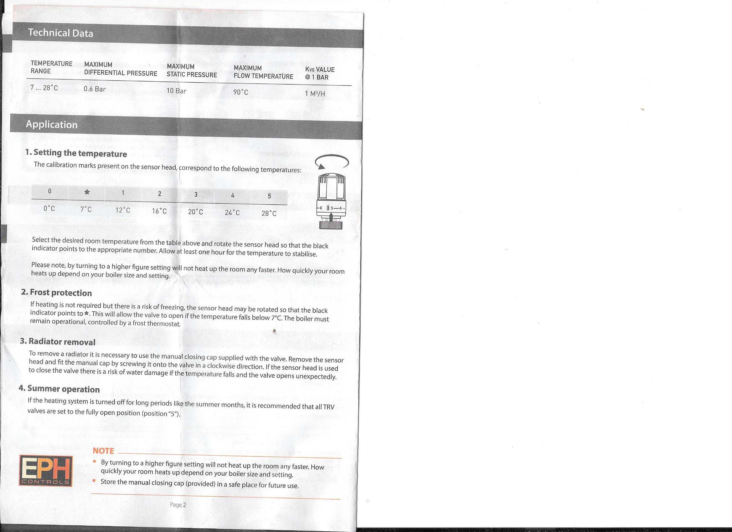

John Carroll Posted January 13 Posted January 13 57 minutes ago, -rick- said: Interesting. All of my valves I can press down manually (no tools). It's stiff sure but definitely movable by hand. If I use my thumb with something covering it, then, yes, can push it, but not easily, maybe thats why my pins never stick in the one position!. At index 2 my actuator will certainly be pushing the pin in a fair bit and will be fully shut off at a room temp of 18/20C, all these (proportional) actuators work the same, at a fairly low setting like index 2, the valve will only be a mm or so from fully shut so a relatively small temperature rise will throttle it still further and even close it, I would think that the actuator should just about be touching the pin even on setting 5 with the valve just fully open I will be purchasing/replacing one in the next few days so will take a few readings before installing it.
John Carroll Posted January 21 Posted January 21 (edited) Got the new EPH TRV, its indexed 0 to 5. At a OAT of 7C and leaving the TRV outside for a hour or so, I only have to decrease the setting to 4.0 when the actuator then contacts the push pin. Inside, after allowing it to heat soak for another hour or so, the push pin starts to move immediately on turning the actuator from index 5 (max). At setting 2.5 (which gives me ~ 18C), the valve is only ~ 1.5MM off its (closed) seat at a temperature of 15C or so. Edited January 21 by John Carroll
