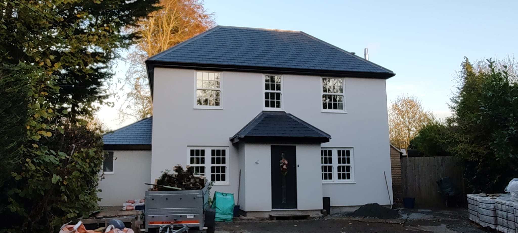

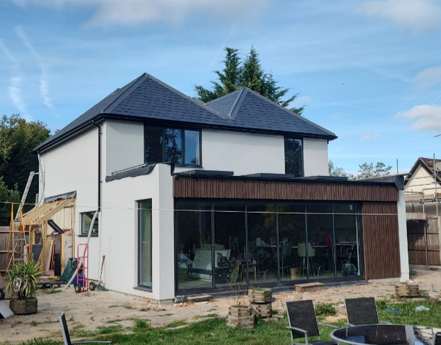

White render, black aluminium windows doors and the slate cladding was the style we went with!
The finished off with some nice western red cedar cladding (I think it's called? Expensive stuff!)

We had our silicone rendering start just above the DPC. We still don't know whether to paint the lower plain-rendered parts black or the same colour as the textuered silicone-rendered part
We're still not finished yet
