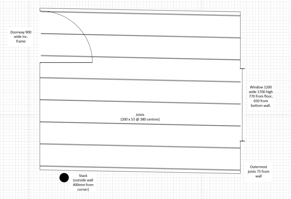

Addlepate Posted January 2 Author Share Posted January 2 Just realised even with the shower near the stack there's still a joist in the way of the shower drain. Measuring tape out and thinking cap on again. Link to comment Share on other sites More sharing options...
-rick- Posted January 2 Share Posted January 2 Can you draw a diagram? 1 Link to comment Share on other sites More sharing options...
joe90 Posted January 2 Share Posted January 2 Can you not run it outside? If not one joist adequately strengthened will be doable 1 hour ago, -rick- said: Can you draw a diagram? yes including outside pipes /stack etc Link to comment Share on other sites More sharing options...
Addlepate Posted January 3 Author Share Posted January 3 @-rick-, @joe90 I'll try - I have an eye operation today which might get in the way. Basically the joists run longways / right to left with the first joist about 75mm from the bottom wall. The current bath waste avoids this as the trap is one side then the waste passes over it. The stack is on the outside of the bottom long wall, just under 400mm from the bottom left corner. I'm inclined to agree that one joist should be OK if I can get in to bore a hole on the centreline. I've just had a nag from the gas installer about positioning while writing this - wants to order the flue! Link to comment Share on other sites More sharing options...
Addlepate Posted January 3 Author Share Posted January 3 (edited) @-rick-, @joe90 Is this helpful? Same orientation as the layouts. Dimensions in millimetres. Room is 3300 x 2730. Edited January 3 by Addlepate 1 Link to comment Share on other sites More sharing options...
-rick- Posted January 3 Share Posted January 3 (edited) This LABC doc says a hole of up to 50mm should be ok in a joist 200mm deep. https://www.labc.co.uk/news/how-get-it-right-notches-holes-solid-timber-joists 40mm should be fine for a short run of shower waste. Don't know if that applies in your situation but seems similar. The joist is also close enough to the wall that I would guess you could block out from the wall and attach the joist to the wall either side of the hole to reinforce it if needed or for piece of mind. But please don't take anything I say about this as gospel. I've gone through a similar thought process before with another bathroom but ended up not doing the work so never got to the stage of verifying compliance. Good luck with your surgery. Health should always come first, this stuff (including the plumber) can wait if you aren't feeling up to it. Edited January 3 by -rick- Link to comment Share on other sites More sharing options...

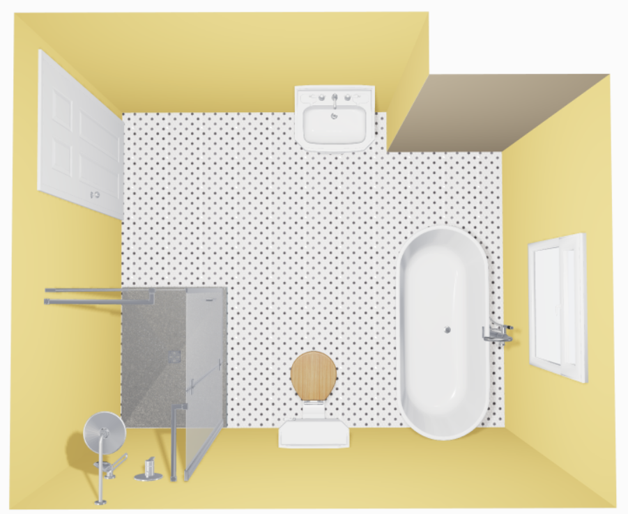

joe90 Posted January 3 Share Posted January 3 (edited) I hope your eye op went ok? Been out all day and just got back to thinking about this. I like your drawing no 3 and would be my choice, and my comments are 1/ shower waste through one joist (next to a wall so carrying less weight IMO ) perfectly doable just glue and screw some 50mm x 25mm x 300mm to top and bottom of the joist to take care of compression and tension around the hole. 2/ basin waste in 32mm or 40mm + hot and cold buried in new IWI or deep skirting (IWI better all round for house insulation.) and out to the stack 3/ move toilet out to accommodate IWI. and re position if required. 4/ bath waste again buried in IWI along with hot and cold and out to the stack with regard the boiler, can you not prefab a board with insulation attached big enough to hang the boiler and to the floor (3/4” ply) and quickly fit it between the old boiler coming out and new boiler being hung? (Even if you pay the fitter a hour extra to make it worth your while) You can then IWI the rest of the cupboard afterwards. IWI great to insulate the room AND hide all the pipework, fit all pipes then just cut the insulation around them when fitting. as an aside, I am a convert from tiles to wall panels and would never go back. Edited January 3 by joe90 Link to comment Share on other sites More sharing options...
Addlepate Posted January 3 Author Share Posted January 3 Just a quick one as I can't see properly. @joe90 I should have numbered as I went - this one? More tomorrow if I can see. Link to comment Share on other sites More sharing options...

Addlepate Posted January 6 Author Share Posted January 6 Hi all, sorry for the delay replying. Giving the eyes a bit of recovery. On 03/01/2025 at 11:17, -rick- said: Good luck with your surgery. Health should always come first, this stuff (including the plumber) can wait if you aren't feeling up to it. On 03/01/2025 at 16:51, joe90 said: I hope your eye op went ok? Thank you both. I think it went OK - won't really know until the follow up in a month or so. Weirdest experience I've ever had, I think, but I won't go into the gory detail! On 03/01/2025 at 11:17, -rick- said: This LABC doc says a hole of up to 50mm should be ok in a joist 200mm deep ... The joist is also close enough to the wall that I would guess you could block out from the wall and attach the joist to the wall either side of the hole to reinforce it if needed or for piece of mind. On 03/01/2025 at 16:51, joe90 said: ... my comments are ... shower waste through one joist (next to a wall so carrying less weight IMO ) perfectly doable just glue and screw some 50mm x 25mm x 300mm to top and bottom of the joist to take care of compression and tension around the hole. I'm inclined to agree. There would only be one hole needed through one joist so no issues with trying to achieve a fall and the hole could be on centreline and less than 50mm. I think that it is the joist next to the wall likely means it will be subject to less loading, though I'm not sure yet how much of the bath load will be imposed on it. I also feel more relaxed about it as the joists are slightly over-specified for the span. I think it would be difficult to arrange blocking to the wall, and I'm not sure if I misunderstand what you mean about reinforcing top and bottom - do you mean on the side of the joist above and below the hole, as the floor and downstairs ceiling are attached top and bottom? I could make up ply flitches with a matching hole, or perhaps sister the joist. I'll make investigations and maybe talk to building control. On 03/01/2025 at 16:51, joe90 said: 2/ basin waste in 32mm or 40mm + hot and cold buried in new IWI or deep skirting (IWI better all round for house insulation.) and out to the stack 3/ move toilet out to accommodate IWI. and re position if required. 4/ bath waste again buried in IWI along with hot and cold and out to the stack with regard the boiler, can you not prefab a board with insulation attached big enough to hang the boiler and to the floor (3/4” ply) and quickly fit it between the old boiler coming out and new boiler being hung? (Even if you pay the fitter a hour extra to make it worth your while) You can then IWI the rest of the cupboard afterwards. IWI great to insulate the room AND hide all the pipework, fit all pipes then just cut... the insulation around them when fitting. as an aside, I am a convert from tiles to wall panels and would never go back. I'm thinking at the moment wood T&G / Shiplap type panelling (probably actually water resistant MDF or wall panels) then painted walls. Internal wall insulation is do-able and would be better for a bathroom but need to think about the work and how to accommodate the window frame etc. If we go panelling it would probably be stepped out from the wall allowing pipes to be hidden behind and giving room for insulation at least part way up. I'll speak to the gas installer about the need to mount the boiler on a board, as he might be doing it anyway, but I don't think it will be needed for insulation as if we're going for option 3 it will be mounted on the top long wall, and that's an internal (party) wall so no (or not as much) need for insulation. I can get him to mount it with a bit of clearance to the window wall to allow for insulation to that wall. I agree on wall panels, haven't used them but they look good and much quicker / simpler than tiles, it's just whether we can get them in the style we want. As regards boiler positioning and bathroom layout, the vote here seems to be option 3 and I walked partner through it at the weekend and she agrees, so that's decided and I've committed to the boiler installation top right on the long wall on Friday. Thanks again to everyone for your thoughts and help, I've felt very on my own with this stuff and it's good to have the support and be able to kick ideas around. 1 Link to comment Share on other sites More sharing options...
joe90 Posted January 6 Share Posted January 6 1 hour ago, Addlepate said: about reinforcing top and bottom - do you mean on the side of the joist above and below the hole, Glad your op appears to have gone ok. Yes on the side or a piece, or ply the depth of the joist glued and screwed and then drill both. Link to comment Share on other sites More sharing options...
