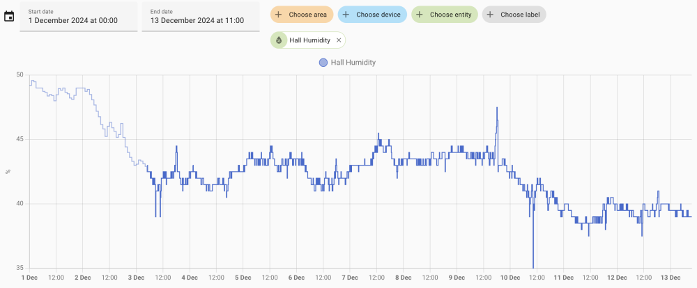

Kelvin Posted December 13, 2024 Share Posted December 13, 2024 Ours is 170m3/hr and boosts to 25% above that when it detects the humidity is high. The boost speed isn’t particularly intrusive in the other rooms. Only the extract in the kitchen gets slightly louder and it clears the bathrooms very quickly. The shape of our humidity graph is similar to @JohnMo Link to comment Share on other sites More sharing options...

JohnMo Posted December 13, 2024 Share Posted December 13, 2024 My total area is 192m² Original flow rate was set per building regs, then after sign off reduced to closer passivhaus flow rates. Best guide I came across attached below. 12 minutes ago, sonicboom said: 1. Where is the bathroom extractor located (middle of the room, where the bath is) ? 2. Is it on the wall or ceiling ? 3. What is the diameter of the extractor ? 4. What type of grille are you using ? 5. What mvhr unit are you using ? 1. Above bath, as far from door as possible and opposite side of room to shower. 2. Ceiling - about 2.5m 3. 125mm 4. Big standard adjustable extract terminal 5 Titan HRV - two times units due to layout. 1 Link to comment Share on other sites More sharing options...

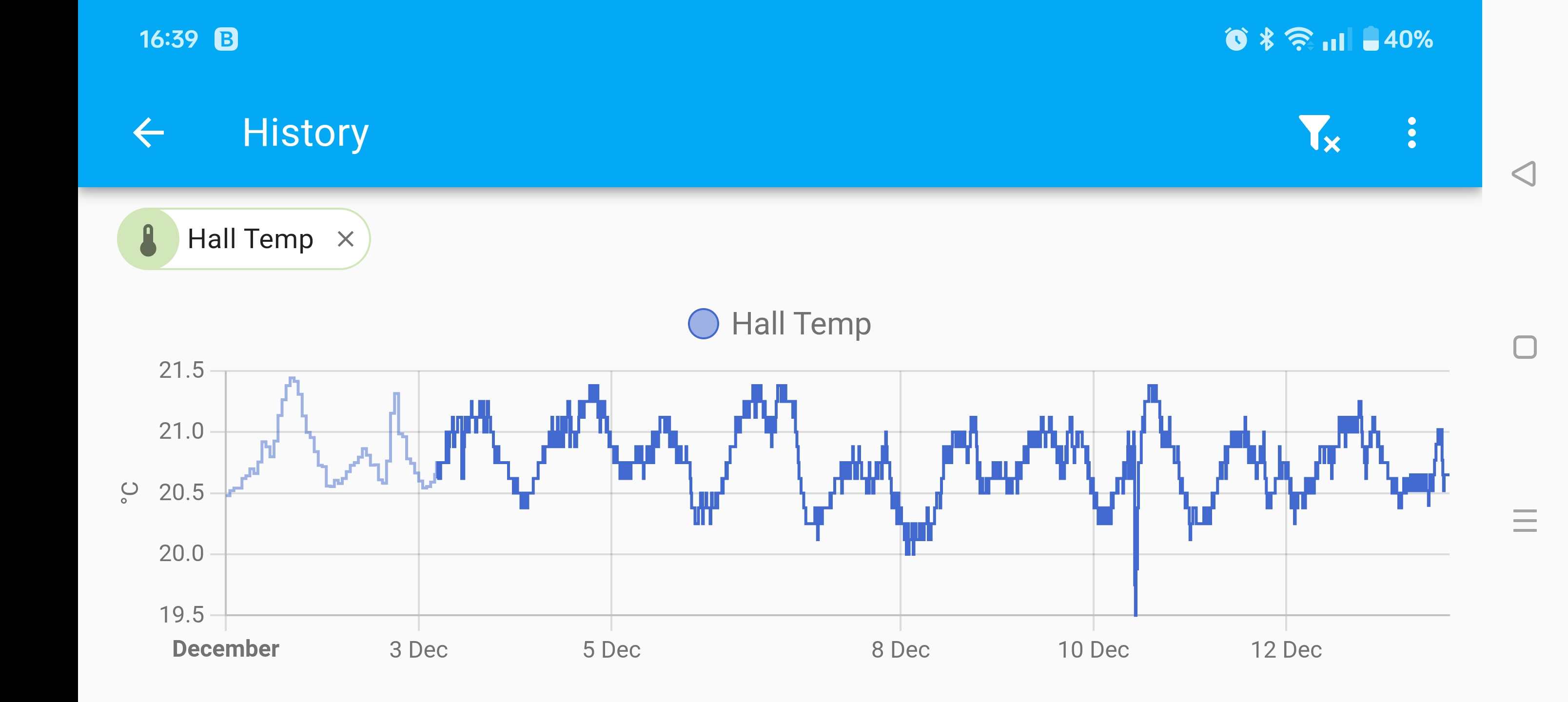

JohnMo Posted December 13, 2024 Share Posted December 13, 2024 Don't have any issues with cold blasts of air. Generally air clings to the ceiling and by the time it gets anywhere you feel it's at room temperature. We keep the house between 20 and 21, sometimes a little warmer with solar gain. Bedrooms generally cooler, nearer 18/19. December data below. Currently batch charging the floor at night, and a day or evening top up. All UFH throughout. Link to comment Share on other sites More sharing options...
sonicboom Posted December 13, 2024 Author Share Posted December 13, 2024 Cool. What tool/gear do you use to monitor the temps ? and what do you mean by batch charging ? I am assuming you are using ashp, you must be getting some really good COP ratios with UFH. Are you doing UFH on 1st floor too (assuming you have one) ? Link to comment Share on other sites More sharing options...
JohnMo Posted December 13, 2024 Share Posted December 13, 2024 2 hours ago, sonicboom said: Cool. What tool/gear do you use to monitor the temps ? That's a Shelly H&T, within Home Assistant. Shelly own webpage is pretty crude. 2 hours ago, sonicboom said: and what do you mean by batch charging Batch charging is using the floor as storage heater, in basic terms. Charging the floor similar to storage heater in cheap periods. We are single storey, so no real upstairs. 1 Link to comment Share on other sites More sharing options...
