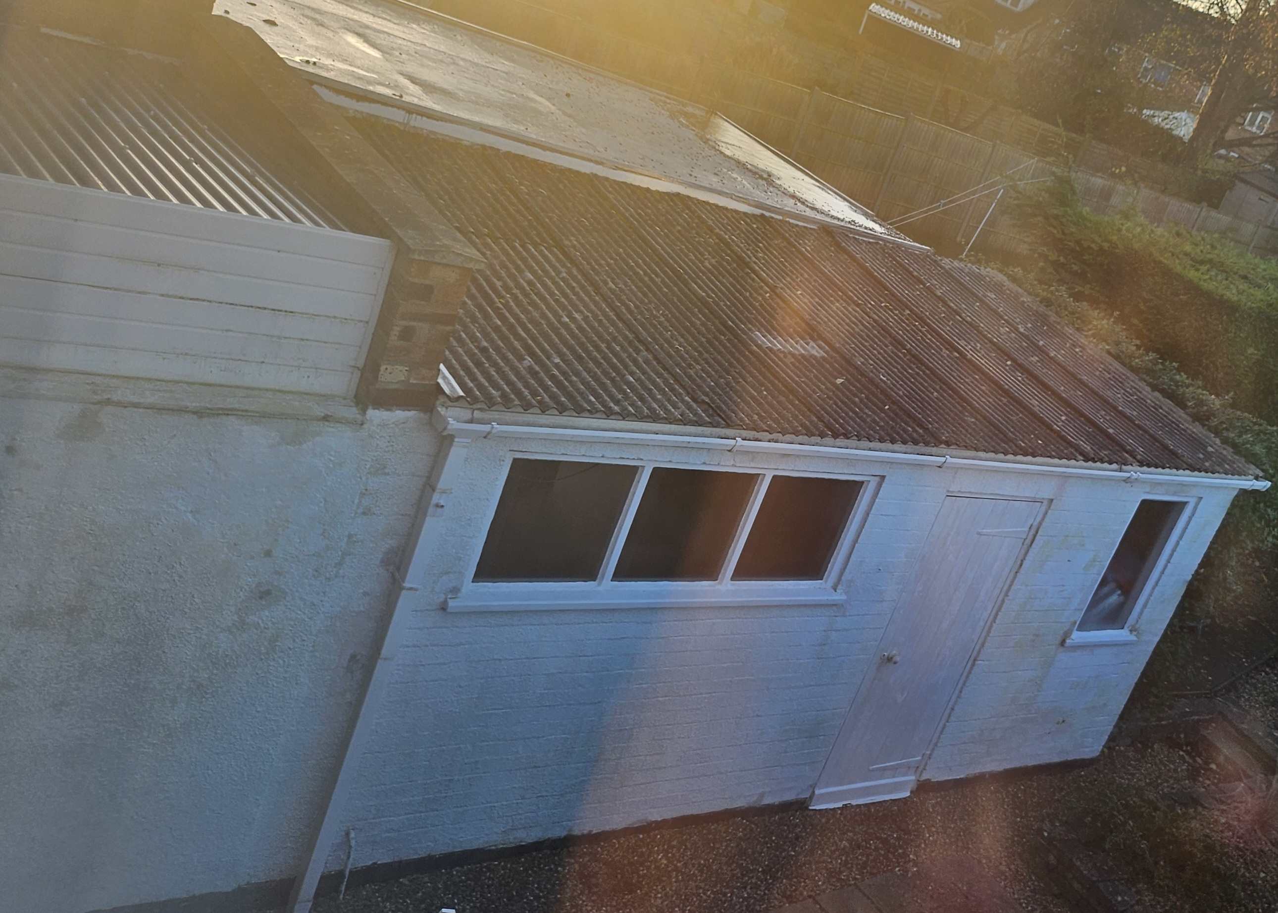

Fairy Posted December 9, 2024 Posted December 9, 2024 (edited) Hi all, ive moved into a new house and found the garage roof is leaking, so i've got quotes to get this repaired, turns out the previous owner has been doing patch up jobs for a long time AND its an asbestos roof so need to replace the whole thing. I want to later on down the line convert the garage into a usable room one day. So want to do this correctly. I'm wondering if anybody can recommend which would be the best option for the new roof, while still being cost savvy of course, as each builder is of course saying the one they want to install is better than the other options lol The options are: traditional 3 layer felt roof epdm rubber fibre cement slate tiles profile 6 fibre sheets It's a slightly slanted roof if that helps. Edited December 9, 2024 by Fairy
Iceverge Posted December 9, 2024 Posted December 9, 2024 Any pictures? Inside and outside please. If you plan to use it as a habitable space later I would be tempted to put some insulation in there at the same time. Depending on the quality of the rest of the structure then it might be cheaper to rebuild the whole thing if you want it habitable.

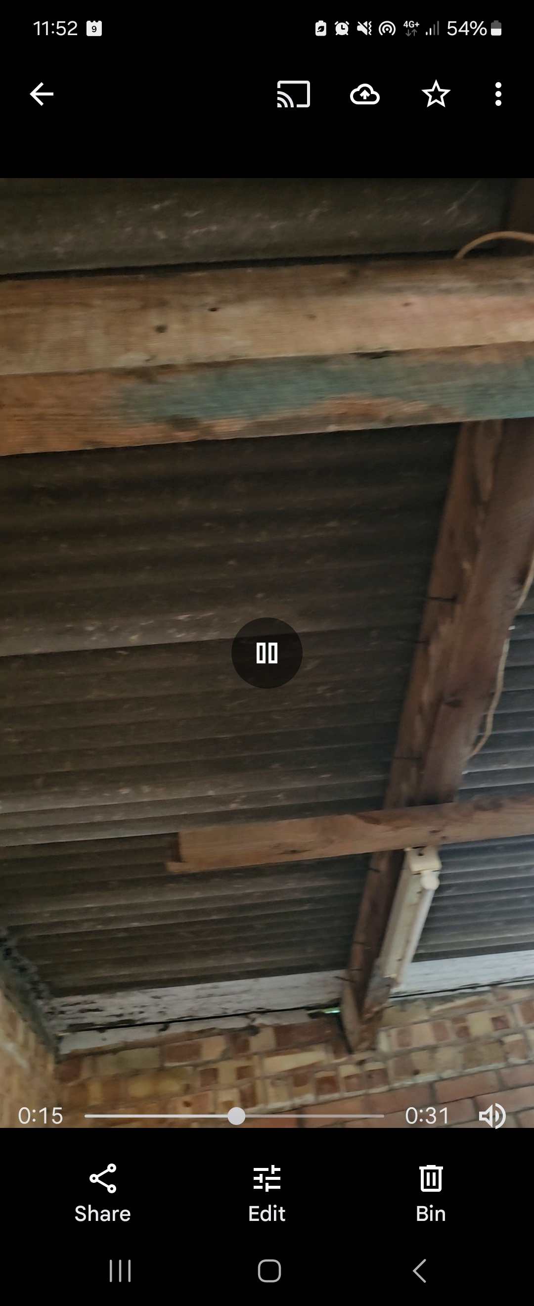

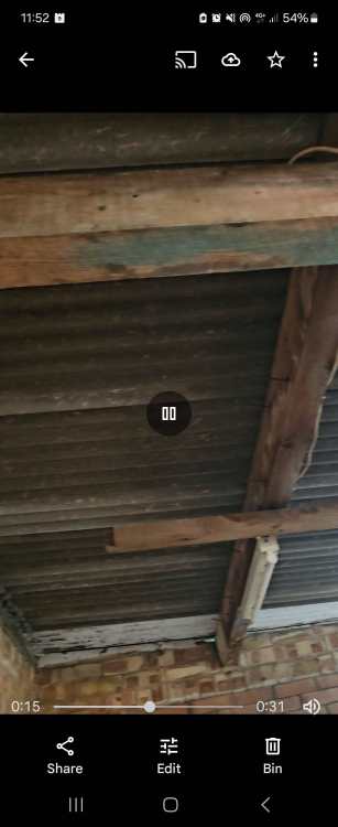

Fairy Posted December 9, 2024 Author Posted December 9, 2024 it's not letting me upload the video i took internally so heres a screenshot of part of it internally
Iceverge Posted December 9, 2024 Posted December 9, 2024 (edited) Insulated metal sheeting is by far the simplest and cheapest solution for a small span like that. I would raise the pitch to at least 4deg (about 1:14) by raising the rear wall plate or taking a row of bricks off the front wall. Could completely dispense with all the internal timbers then too as the span looks like it's only about 2.5m. Edited December 9, 2024 by Iceverge 1
