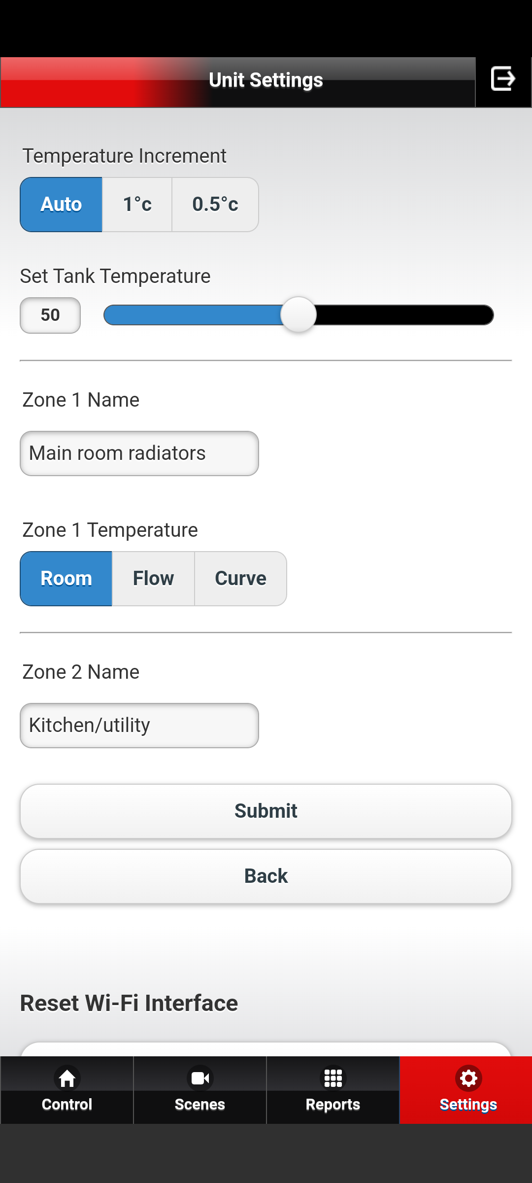

BEJB Posted December 8 Share Posted December 8 I have a 14kW Mitsubishi Ecodan, which heats 2 zones (zone 1 = house with rads and zone 2 = kitchen with UFH) and DHW. I spent a good time playing with weather compensation only to find that room temperature with auto adaptation heats better with a higher COP - happy bunny! However, there does seem to be a slight issue. Auto adaptation seems to set itself to the lowest flow temperature to match heat input to heat output. So zone 1 heats well and is very efficient. But the system doesn't run zone 1 and zone 2 at the same time - zone 1 takes precedent if it calls for heat. So zone 1 seems to be on all the time (nice and snug!) and zone 2 seems to be off most/all of the time (a bit chilly). Does anyone have any suggestions as to how I might be able to get some heat to zone 2, while still being able to benefit from auto adaptation? Thanks in advance for any help or advice you can give. Link to comment Share on other sites More sharing options...

BEJB Posted December 8 Author Share Posted December 8 I can't set different heating modes for the two zones. I set it for zone 1 and the same applies to zone 2. Room seems to be the best compromise. I don't know if this is just the way it is setup, or if I could change this to allow different heating modes for different zones. Link to comment Share on other sites More sharing options...

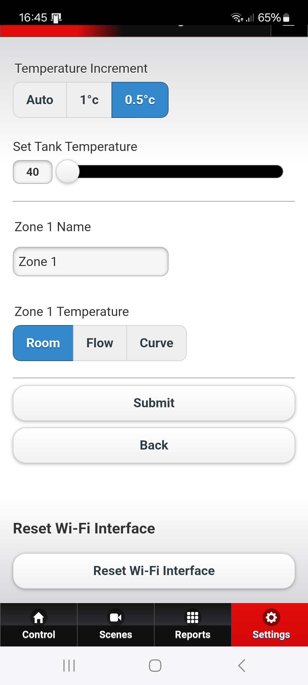

PhilT Posted December 8 Share Posted December 8 15 minutes ago, BEJB said: I can't set different heating modes for the two zones. I set it for zone 1 and the same applies to zone 2. Room seems to be the best compromise. I don't know if this is just the way it is setup, or if I could change this to allow different heating modes for different zones. I can see this screen in the Melcloud app which suggests that you can set the mode by zone, but I only have one zone so I could be mistaken Link to comment Share on other sites More sharing options...

BEJB Posted December 8 Author Share Posted December 8 2 hours ago, PhilT said: I can see this screen in the Melcloud app which suggests that you can set the mode by zone, but I only have one zone so I could be mistaken I have the two zones but only one option Link to comment Share on other sites More sharing options...

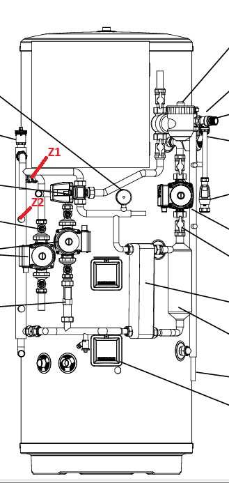

Gary68 Posted December 9 Share Posted December 9 Are you saying that you can only heat zone 1 or zone 2 at once, or is just that you haven't got the thermostats calling for heat at the same time? If its the former then something have been wired up incorrectly. I have UFH downstairs and rads upstairs they are on separate stats and both can call for heat independently or together they just have different pumps for each circuit. Link to comment Share on other sites More sharing options...
BEJB Posted December 9 Author Share Posted December 9 1 hour ago, Gary68 said: Are you saying that you can only heat zone 1 or zone 2 at once, or is just that you haven't got the thermostats calling for heat at the same time? If its the former then something have been wired up incorrectly. I have UFH downstairs and rads upstairs they are on separate stats and both can call for heat independently or together they just have different pumps for each circuit. Mmmm- that is interesting. The heating system can heat zone1, zone 2 or DHW but only one of them at a time. I know DHW claims priority, but if I could have zone 1 and zone 2 independently or together, that would probably help. Thanks for the tip - that's something to look at. Interestingly, if I have either zone 1 or zone 2 calling for heat, the Melcloud app shows both of them operating. I always assumed that was an artefact of the software, but maybe it is another thing pointing to some sort of configuration error. Link to comment Share on other sites More sharing options...
Gary68 Posted Tuesday at 08:42 Share Posted Tuesday at 08:42 19 hours ago, BEJB said: Interestingly, if I have either zone 1 or zone 2 calling for heat, the Melcloud app shows both of them operating. I always assumed that was an artefact of the software, but maybe it is another thing pointing to some sort of configuration error. Mine does that too, I think its just the app. Do you have a mitsubishi preplumbed cylinder, if it was for 2 zones there should be 4 pumps in total, 1 for the primary circuit, 1 for each zone and 1 for dhw. If you turn both stats on to call for heat you should have 2 pumps lit up with lights if they are the std grundfos pumps that are usually on the cylinder Link to comment Share on other sites More sharing options...
