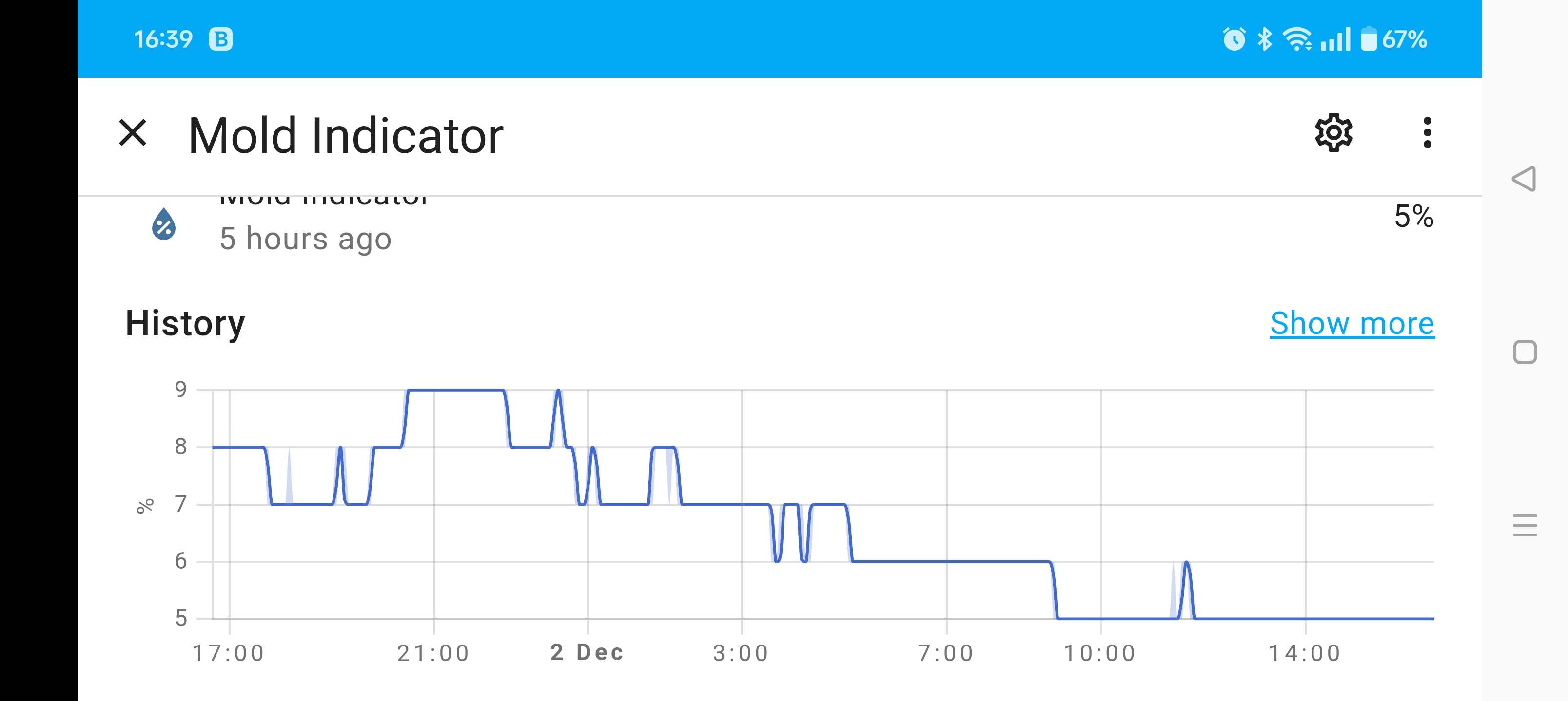

I found a mold indicator in home assistant, so set it up the other day.
Screenshot_2024-12-02-16-39-59-30_c3a231c25ed346e59462e84656a70e50.thumb.jpg.858c28d416bb8df35263feba0a720278.jpg
Almost zero chance of mold. Steady house temp, 3G glazing and MVHR set to just below passivhaus rates (based on area).
