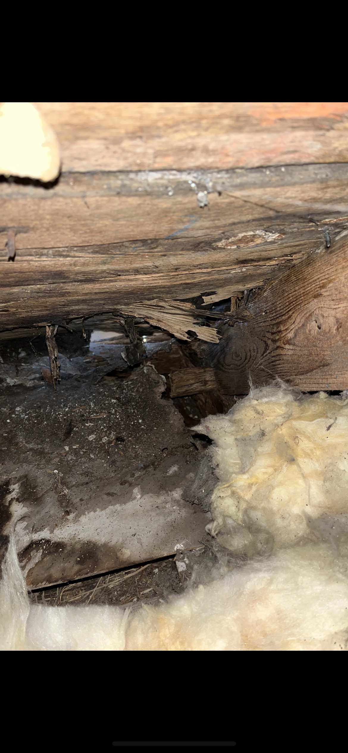

I went to the loft and found there is a timber rafter near the chimney that has rotten quite seriously (and the wooden layer under the roof), all others are fine. That should be caused by the chimney and I believe there was a leak but I can see it is not leaking anymore since it is quite dry around (maybe the previous owner has fixed it?), seems it has been there for a long time, do you see any issues in the near future? This may be replaced when I replace the roof but I have no idea whether the roof should be changed soon from the photo, any suggestions? thanks IMG_0F3258098017-1.thumb.jpeg.73f584fa6ccc9d4e5315a2b5d1cfb139.jpeg

I can see that the board supporting the flashing has been wet, but does not appear so now. I cannot see the rotten rafter end to which you refer. Despite being rotten does it now appear dry? That would support your suggestion that the ingress may have been fixed. If you can get to the rafter end splice on a new piece and cut out the soft end and then, if it ain't broke, don't fix it. Just keep a watching brief during any wet periods in case any past leak recurs. I had a similar issue when I first moved to my house. Sorted the lead-work and decades later it's still dry.

thanks for the suggestions, the end part of the rafter attaching with the wall is rotten but can't see it from the picture, I am not sure if we can fix without replacing the roof since the space is quite limited. I will definitely have a look of it when it is raining to check whether it is still leaking but I thought that is not.

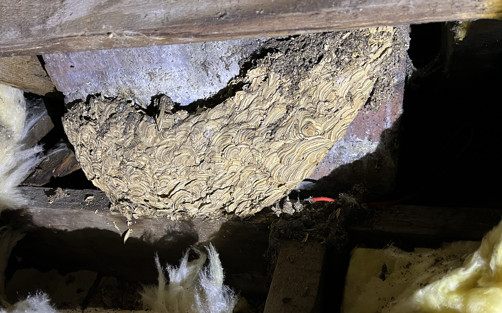

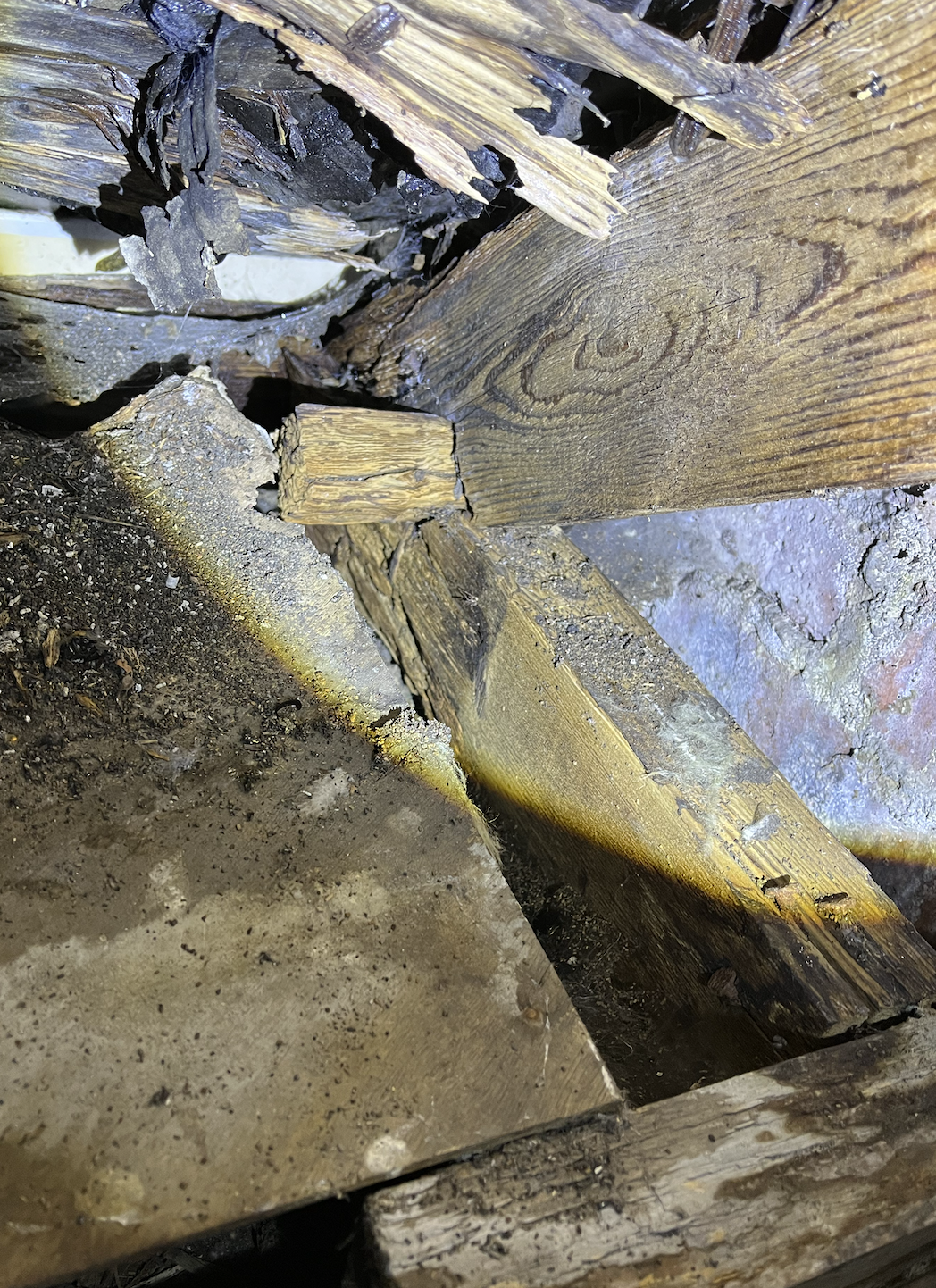

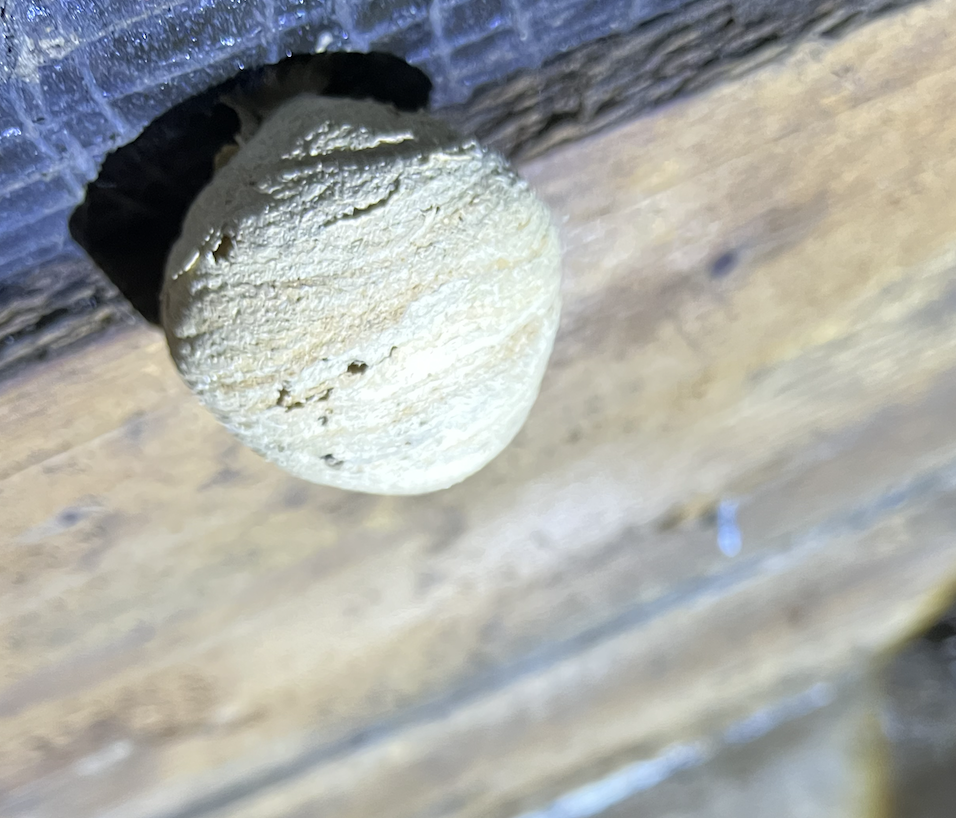

Had a look again today since it rained, seems that there is a small leakage. also, I found these, can anyone help to check if there is anything I should do immediately, since Chrsitmas is coming, is it safe to wait until after Christmas?

The first one looks like an old wasp nest. The second is unclear but could again be an insect nest. The 3rd looks like there could be rot at what looks like the roof and ceiling rafter bearing end. But there is something else going on off screen to the left which is undeterminable but perhaps looks equally worrying
