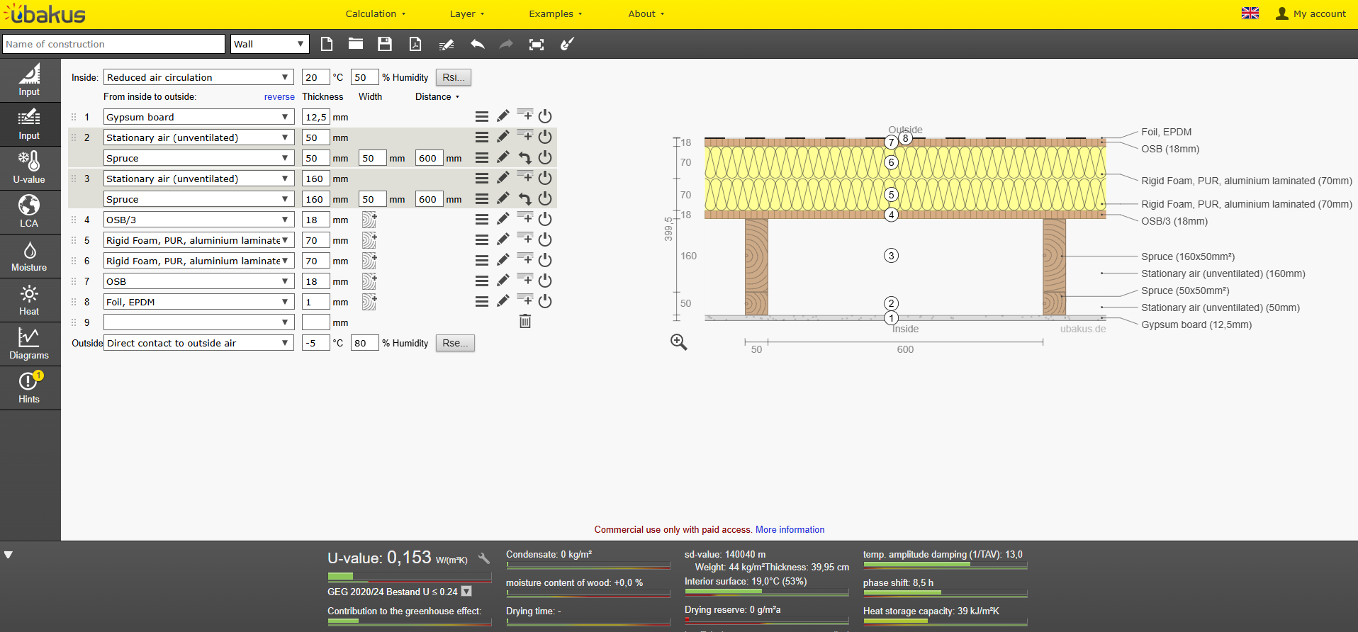

Mr Punter Posted November 27, 2024 Share Posted November 27, 2024 To put your mind at rest you could do a condensation risk analysis. I don't think you will have any issues as there are 2 layers of foil backed insulation, so as long as they are snug round the edges you should be fine. Link to comment Share on other sites More sharing options...

Lhes30 Posted November 27, 2024 Author Share Posted November 27, 2024 @Mr Punter Thanks for that, Bit reassuring ha! I've told my architect what you've shown me, He has said it might be wise to still install the VCL between the 50mm batten and the joists as it will do no harm but will act as a back up just in case. They're planning on fitting this tomorrow. Since you're obviously way more clued up than me, Can you clarify if this plastic sheet whilst actually being redundant according to your software, would cause and harm by trapping moisture above the plasterboard and below the OSB3 sheet (in the unventilated joist area). Link to comment Share on other sites More sharing options...
Mr Punter Posted November 28, 2024 Share Posted November 28, 2024 I don't think it will make much difference either way. The condensation point is nowhere near the joists. The aluminium on the insulation will help reduce vapour. Link to comment Share on other sites More sharing options...
