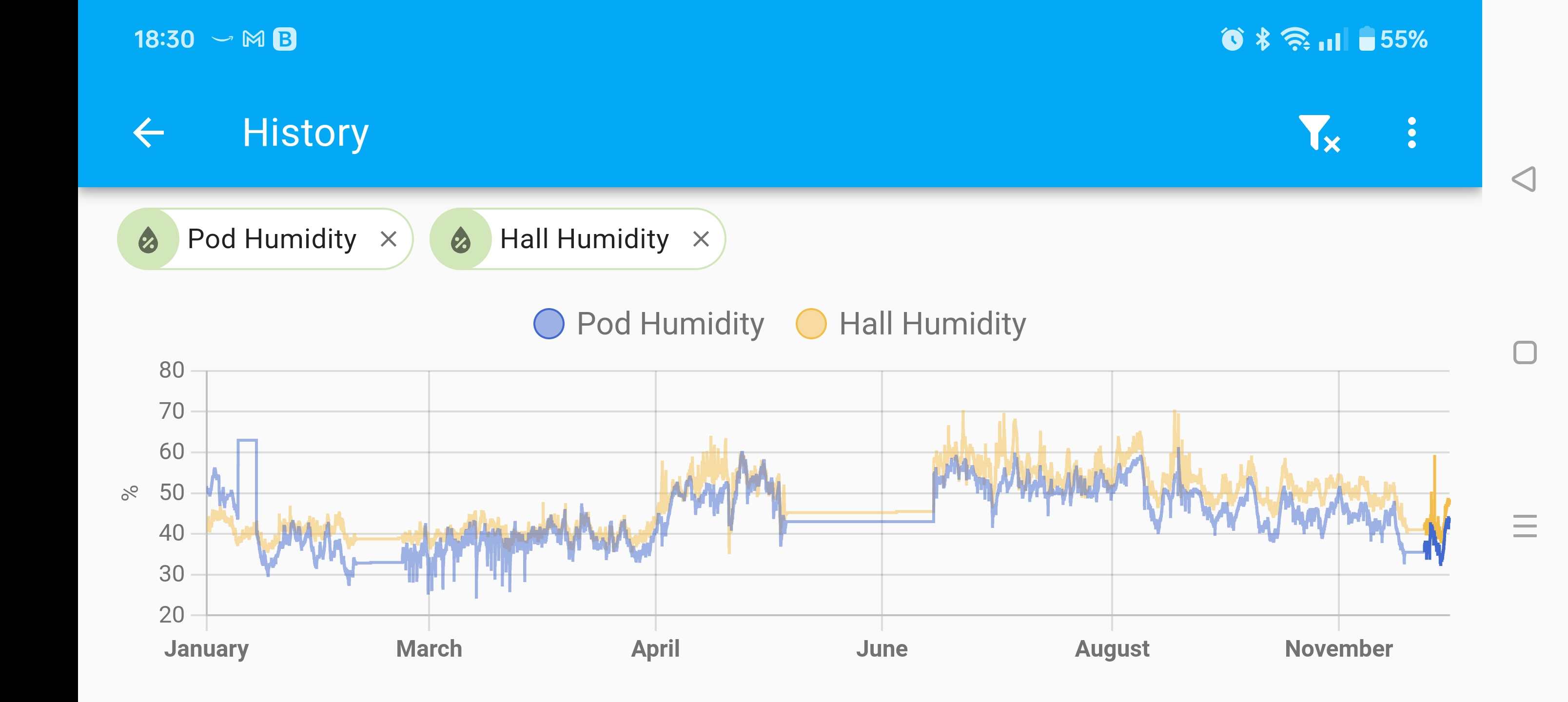

2 hours ago, Iceverge said:
Provided you have adequate internal mechanical ventilation I wouldn't sweat it as moisture won't be trapped in the timber
As a way of illustration, this is our house with MVHR and our insulated summer house. The summer house has a single dMEV fan and it's heated, but temp is allowed to move about much more than the house. As you will see both building follow each other quite closely. The graph is year to date. Only time you have elevated humidity is in the summer, but it's hot not an issue.Screenshot_2024-11-30-18-30-09-46_c3a231c25ed346e59462e84656a70e50.thumb.jpg.3137807fd92ae33c9ebbfcf79e67597e.jpg
